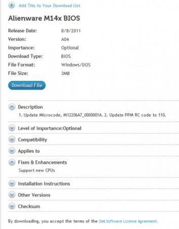

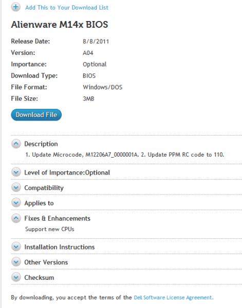

c69k Posted November 27, 2011 Share Posted November 27, 2011 (edited) Anyone knows where I can download A04 unlocked? Want to test it. Or is it similar to A03? And the change in A04 (comparing to A03) is only new processor support? Thank you in advance. Edited November 27, 2011 by c69k Quote Link to comment Share on other sites More sharing options...
