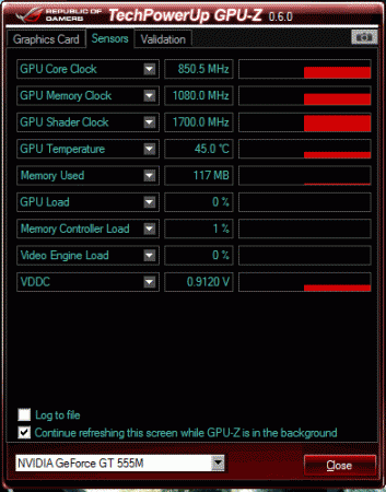

Sean Declan Midwood Posted April 14, 2012 Share Posted April 14, 2012 Thanks, I really appreciate this mod to the VBIOS. I was stuck at 753 MHz for GPU and 1080 MHz for memory using only eVGA precision X. Now with the A08 bios (GF116) I can increase to 850 GPU and 1080 memory while remaining around ~ 68 degrees with the Antec Cooler 200. However when playing on the MX14's screen (1600X900) it runs stable at 850 during BF3 but not when I play though my monitor (BENQ EW2420) (1920X1080). When I play on my monitor I have decrease the GPU clock speed to about 820. I used Fur-Mark to check stability: 15 minutes, no AA, burn-in, dynamic background. Anyways, the increased performance is much appreciated! Quote Link to comment Share on other sites More sharing options...

Sean Declan Midwood Posted April 16, 2012 Share Posted April 16, 2012 Your right, the external led is more resource demanding, although i enjoy an auxiliary screen while gaming i prefer a higher fps, so now i just play with the external monitor. BF3 plays on medium ~ 40 fps compared to ~ 29 before the mod.Also if anyone is interested, the windows experience for 3d business and gaming jumped from 6.6 to 7.1 out o 7.9 with the volt mod! Quote Link to comment Share on other sites More sharing options...
