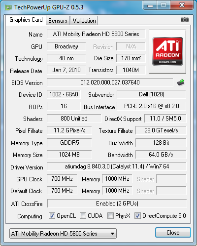

M17x 5870m Vbios Version
Can anyone tell me what the updated vbios version for the 5870m is from Dell? I have had so many laptops replaced I don't remember if I flashed this one or not. Big waste of time if I already did it.
I have version 012.020.000.027.037640 according to gpu-z.
