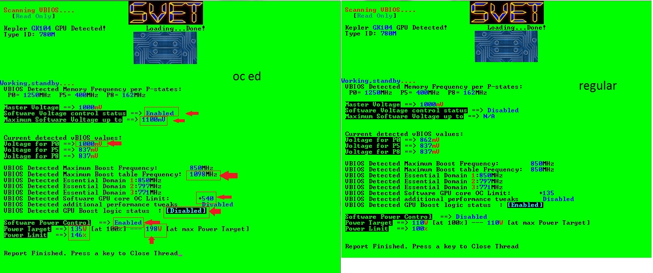

BudMarLeY 66 Posted October 20, 2013 I actually meant that if he could just keep doing this minimizing and maximizing thing for all of the games he is going to try now and afterward. And Bud I hope that you will receive your laptop as soon as possible as I am also waiting for your results aswell. ditto! i take it the issues happen at its worse for you when you switch back and forth to the desktop and the game? edit: hey @evilevil do you have GPU-Z installed on your computer. Im looking for the vBIOS you have on your computer right now. I want to see what the clocks are and the power settings. if you can get me a copy of your vBIOS though GPU-Z i would greatly appreciate that. editx2: nvm I got it from @kenandaoer, thanks ken! editx3: WTF!!!!!! @svl7 or @Prema is it me or does this vBIOS look a little jacked up? this is the default bios that came loaded with @kenandaoer, who was having the same issue and all of us. look at the power target at the bottom of the image... Quote Share this post Link to post Share on other sites
svl7 5702 Posted October 20, 2013 Dude, that crap tool doesn't show the complete truth about the vbios... Never use it as reference. 1 Quote Share this post Link to post Share on other sites
BudMarLeY 66 Posted October 20, 2013 Dude, that crap tool doesn't show the complete truth about the vbios... Never use it as reference.Right on, ill keep that in mind. Quote Share this post Link to post Share on other sites
