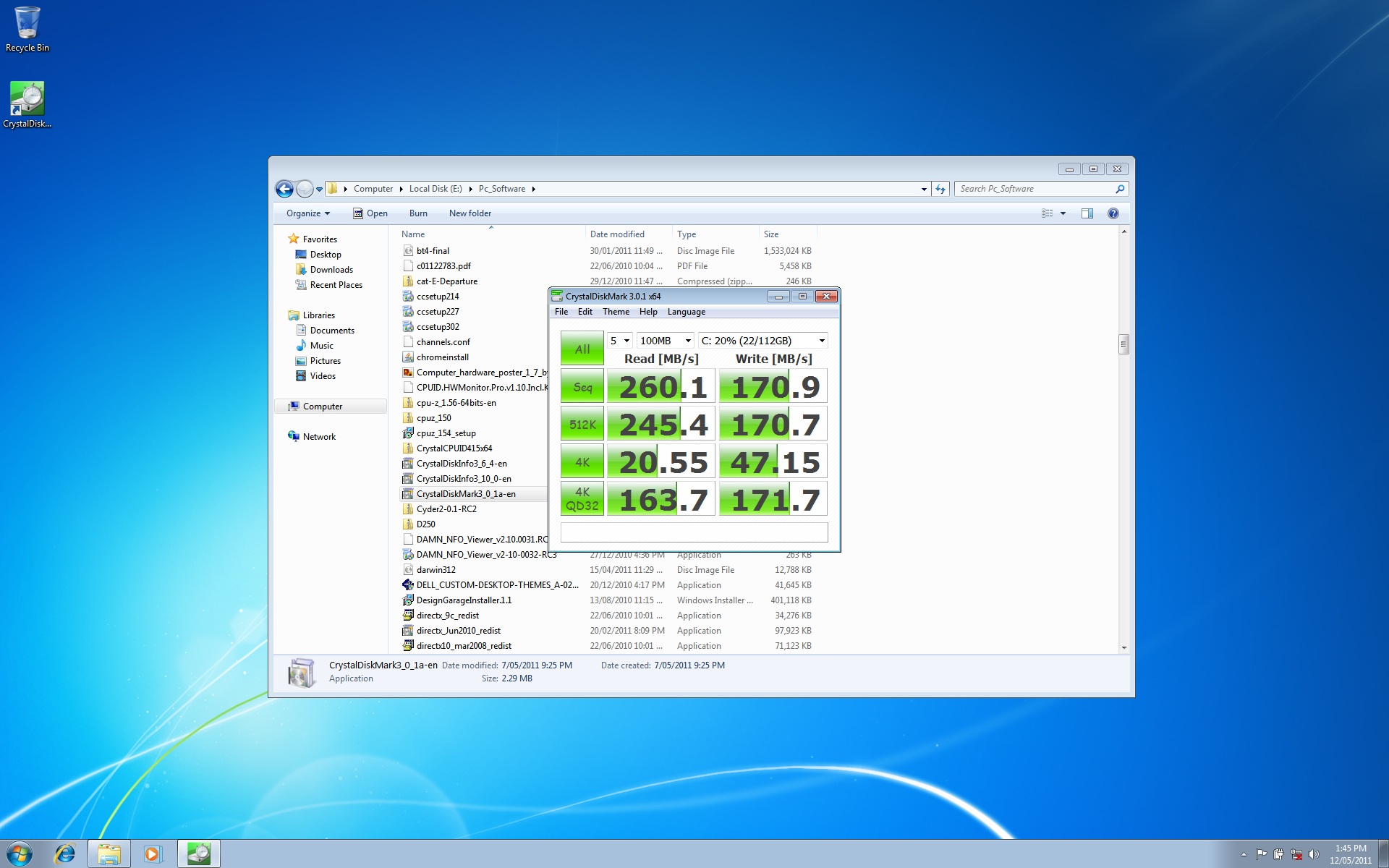

unreal25 Posted May 13, 2011 Share Posted May 13, 2011 The sequential numbers are crazy. However, I'm almost always limited by something else when I am just copying raw files from somewhere (typically it's my USB 2.0 or Gigabit LAN). What I'd like to see more, however, are newer SSDs with a bit higher 4K read/writes. Quote Link to comment Share on other sites More sharing options...
Founder Brian Posted May 13, 2011 Founder Share Posted May 13, 2011 Nice job Michael, now we need a front page article on it. Those 4k numbers make my intel cry. Quote Link to comment Share on other sites More sharing options...
