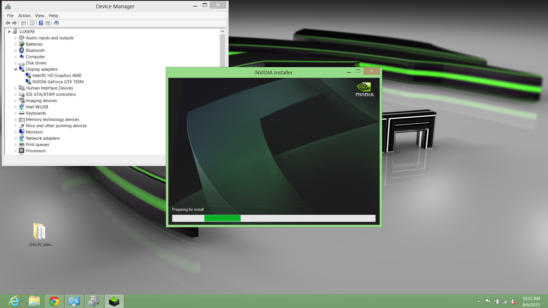

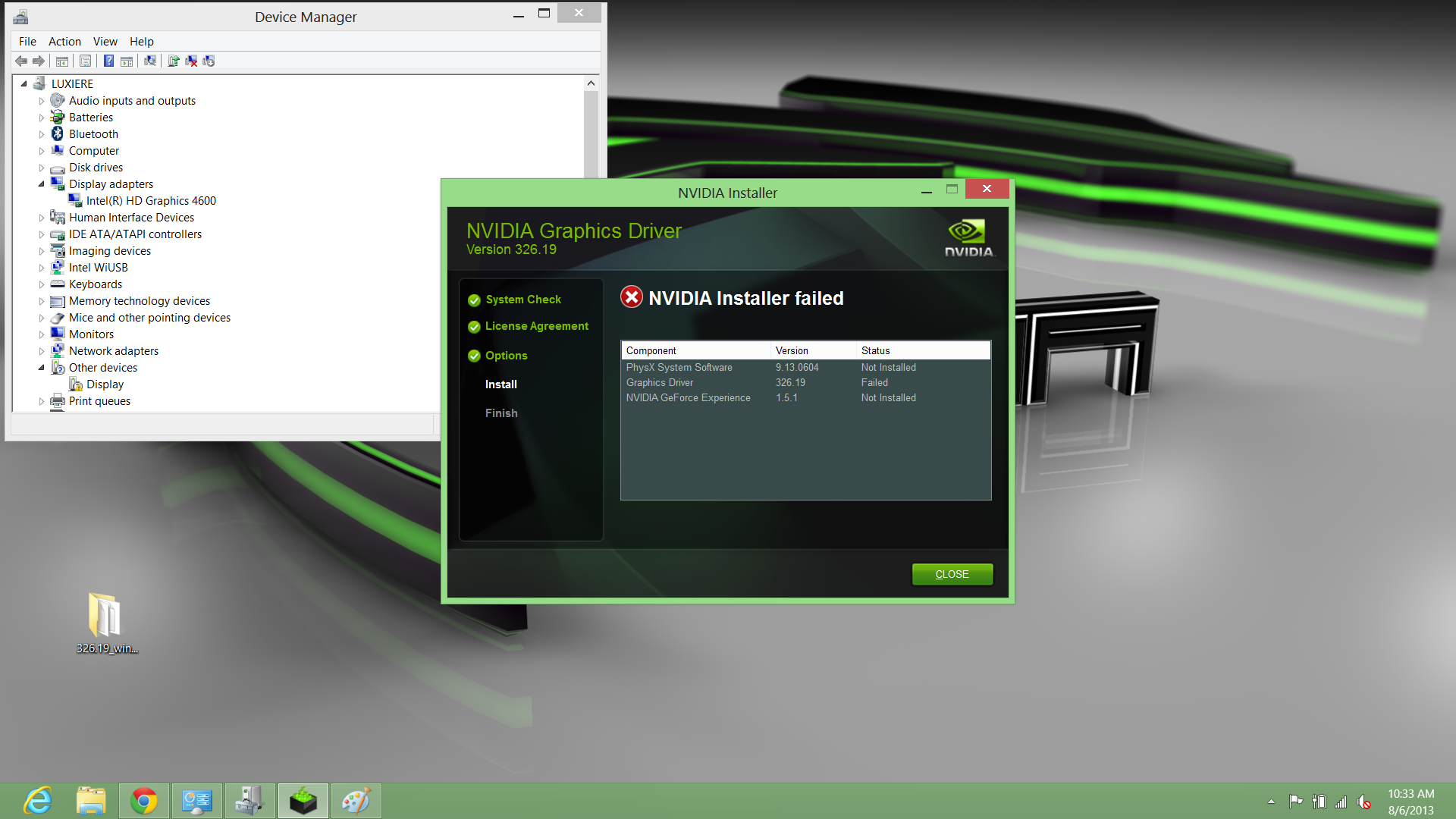

lonesyndal Posted August 6, 2013 Author Share Posted August 6, 2013 Looks like I may have to return my laptop soon... I'm unable to fix the GPU Driver issue. I can ONLY install the stock drivers from Clevo (I was able to manually update before). Attached are images of what's going on. Notice the GTX 765M vanishes and becomes "Display" in Other Devices. Anyone able to help without me sending this laptop in may get a nice donation for your help. Quote Link to comment Share on other sites More sharing options...
Amal Daharin Mahamood Posted August 6, 2013 Share Posted August 6, 2013 Looks like I may have to return my laptop soon... I'm unable to fix the GPU Driver issue. I can ONLY install the stock drivers from Clevo (I was able to manually update before).Attached are images of what's going on. Notice the GTX 765M vanishes and becomes "Display" in Other Devices.[ATTACH=CONFIG]8616[/ATTACH][ATTACH=CONFIG]8617[/ATTACH]Anyone able to help without me sending this laptop in may get a nice donation for your help.You must disable the Windows 8 Driver Signature Enforcement. 1 Quote Link to comment Share on other sites More sharing options...
lonesyndal Posted August 6, 2013 Author Share Posted August 6, 2013 You must disable the Windows 8 Driver Signature Enforcement.Nice, this fixed it exactly... thank you!PM me your paypal or something so I can send ya the donation!EDIT: This be my first time using Windows 8, so this info would be very helpful for those who will be switching over later...EDIT2: Back on topic! So my current undervolt setting: -100mV Processor Dynamic Voltage Offset, +10mV Integrated Graphics Voltage Offset. This has been very stable and keeps the temps very nice at 47-52C. Quote Link to comment Share on other sites More sharing options...
