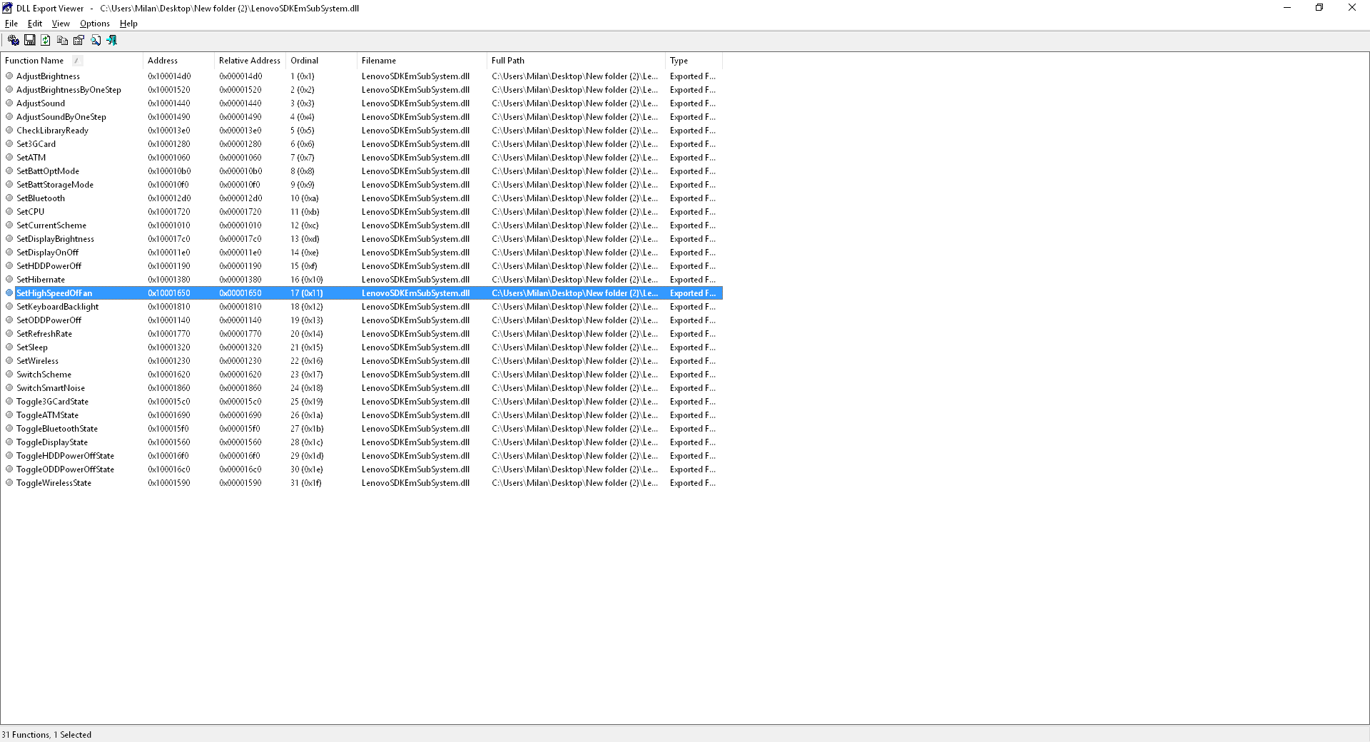

I have checked the configuration you suggested, and it lets us configure the speed, but it doesn't let us reach the highest fan speed (this way we can only reach 82.5% of the fan speed, while the full 100% is reserved only for dust extraction).
The highest fan speed is locked, and can only be unlocked when we start the dust extraction tool (through some boolean value), as you can see in this dll file from Energy Management software (LenovoSDKEmSubSystem.dll), as u can see in the attached image. Maybe some of you will know what to do with this, because I have no clue :D
Unfortunately I also did not reach the maximum speed ... The fan speed is controlled by PWM. With my settings when running clean from dust using Lenovo Energy Management, Notebuk Fan Control shows the fan speed is 120%. So maybe it should be?
To do this, you need to know the values of any controller registers changes Energy Management ... Unfortunately I have no experience in programming. Perhaps the datasheet of the controller will be able to clarify the situation. KB9012QF controller. Datasheet file is too large to attach to the forum.
