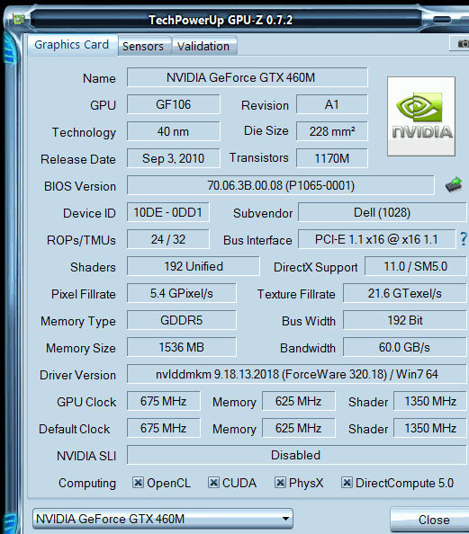

veer Posted June 29, 2013 Author Share Posted June 29, 2013 last i checked it was when i put the 460m back in, i think i was A1. I really hope this helps. Quote Link to comment Share on other sites More sharing options...

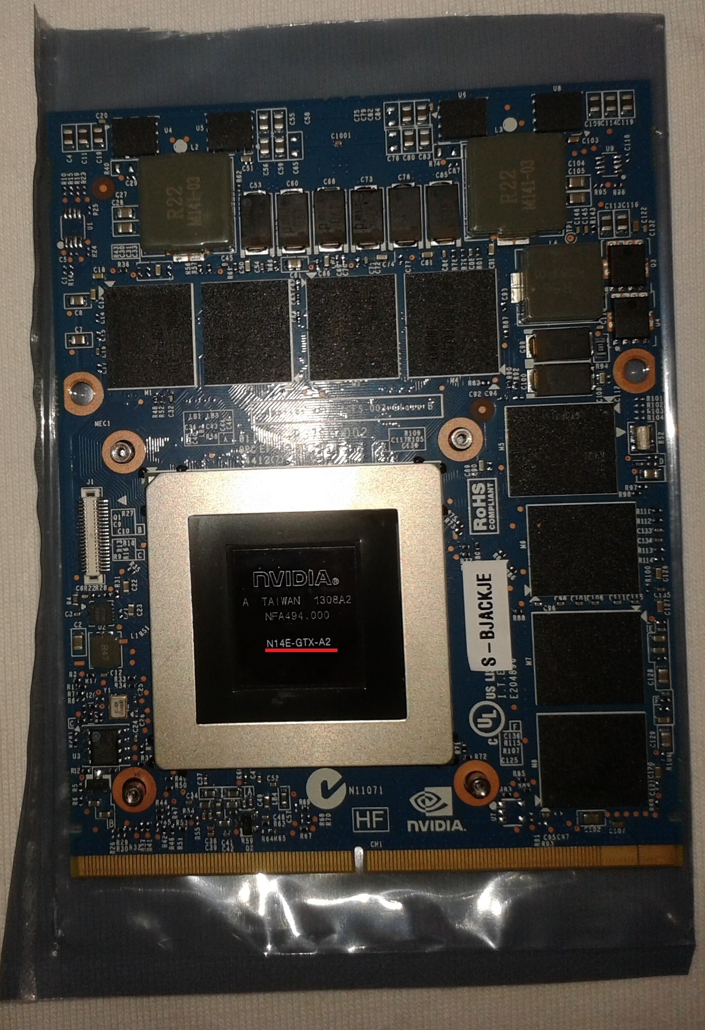

svl7 Posted June 29, 2013 Share Posted June 29, 2013 That's the 460m vbios... I was asking about the 780m. Quote Link to comment Share on other sites More sharing options...
veer Posted June 29, 2013 Author Share Posted June 29, 2013 on the chipset itself it's written A2, if that's not it please do explain how do i find it. Quote Link to comment Share on other sites More sharing options...

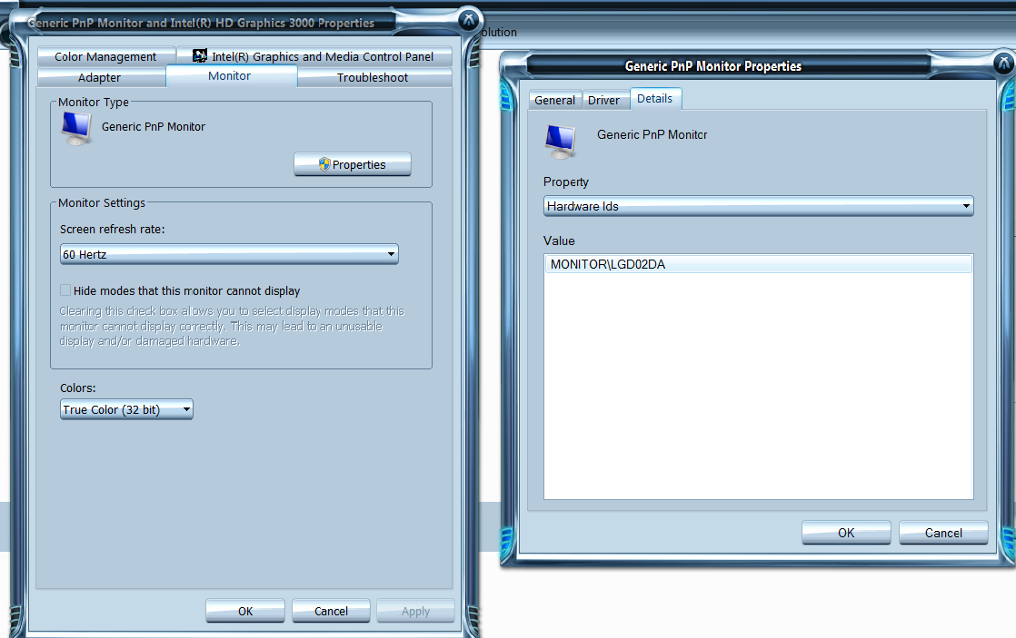

J95 Posted June 29, 2013 Share Posted June 29, 2013 That's weird it looks like the 680m 3D Vision Blank screen bug, M17XR3 60Hz screen ?Alienware M17x M18x New NVIDIA GTX 780M 4GB DDR5 MXM 3 0B | eBay*** Please take note that this video card DOES NOT work with 3D enabled notebooks. We are working on resolving this issue and till take this notice down when we have it up and running *** Quote Link to comment Share on other sites More sharing options...

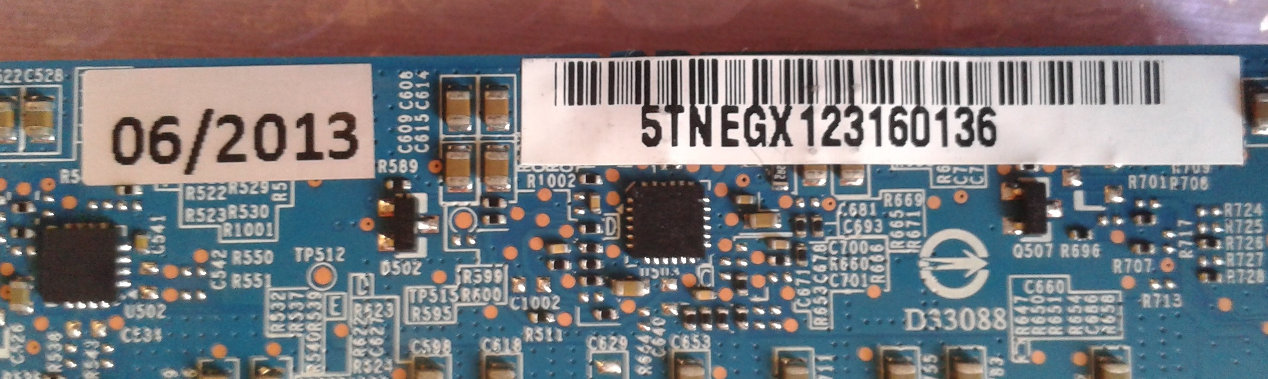

J95 Posted June 29, 2013 Share Posted June 29, 2013 Usually there's a sticker under the card with the VBIOS version number. VBIOS dump under DOS follow this guide http://forum.techinferno.com/general-notebook-discussions/2166-%5Bguide%5D-nvidia-vbios-flashing.htmlnvflash -b backup.rom @chiefule first one to install 780m / m17xr3.Edit @veer Try NVIDIA DRIVERS 326.01WHQL installs fine under Win 7 and no blank screen during installation (gtx 680m 120Hz)don't install under safe mode (MS generic driver), follow previous steps, uninstall delete folders...nvcvn.inf_M17XR3_GTX780M_v326.01.zip Quote Link to comment Share on other sites More sharing options...

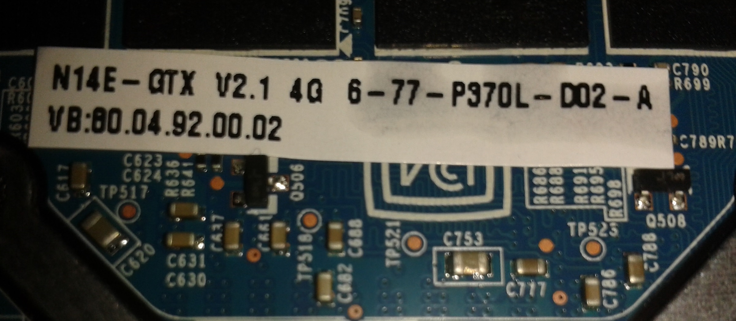

veer Posted June 30, 2013 Author Share Posted June 30, 2013 @J95 @svl7 here is the pic of the bios at the back of the card: hope this helps. I already tried contacting @chiefule by posting in http://forum.techinferno.com/alienware-m18x/3596-alienware-m18x-r1-running-nvidia-gtx-780m-let-testing-begin-4.html and also send him a PM. @J95, There's is only two ways i can access windows 7 normal mode which are: 1. to go to the bios and disabled the Special features, which immediately enables the IGD. 2. to reinstall my 460m back in then set everything back to normal in the bios and F10 to reboot. you said "don't install under safe mode (MS generic driver)", please elaborate how to go to normal mode to install the driver v326.01 WHQL. I'll wait for your answer before any further installation trial. Below are some photos of screen properties: hope this helps too. Quote Link to comment Share on other sites More sharing options...
J95 Posted June 30, 2013 Share Posted June 30, 2013 After uninstalling NV drivers under safe mode it won't boot to desktop ? wrong BIOS settings.Advanced Menu>Video Configuration>Disable IGP>Set display to PEG>F10>Reboot.VBIOS 80.04.92.00.02 now he can help you out, BTW http://forum.techinferno.com/general-notebook-discussions/1847-nvidia-kepler-vbios-mods-overclocking-editions-modified-clocks-voltage-tweaks-226.html#post55392 you're one of the lucky ones. Quote Link to comment Share on other sites More sharing options...
