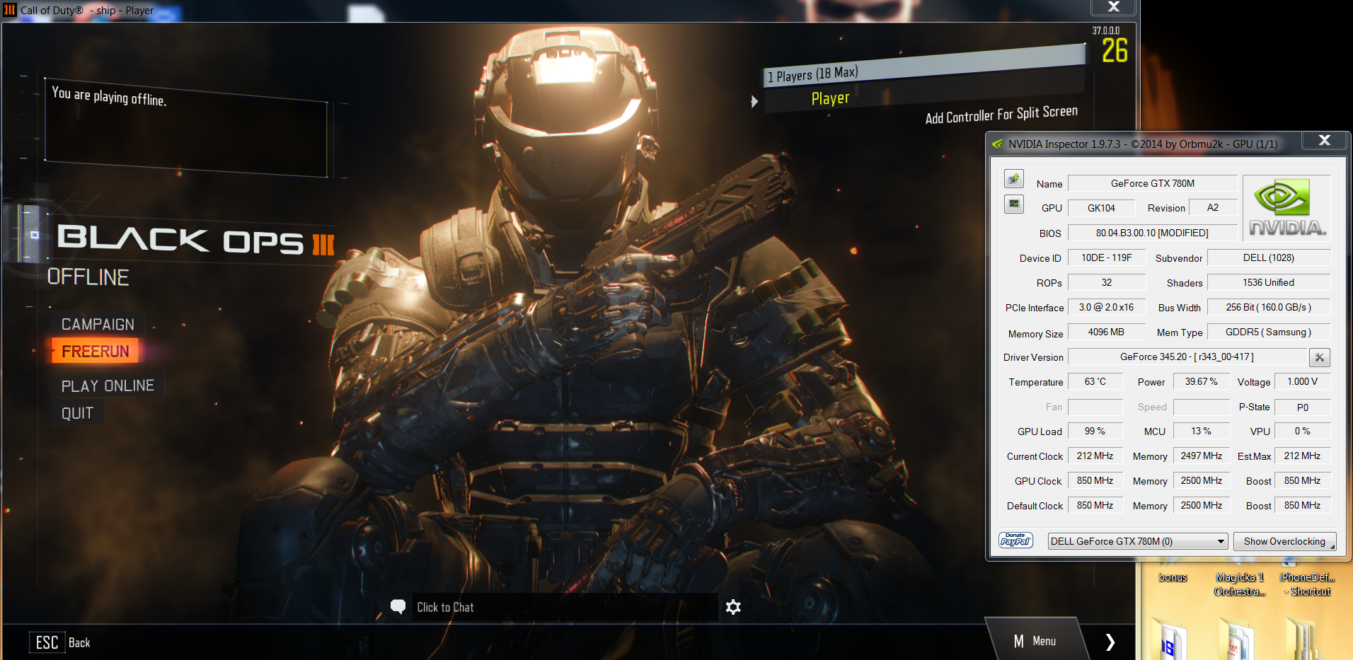

wayne88 Posted August 22, 2015 Share Posted August 22, 2015 It seems like your temps are fine. The cooling in laptops is always a nightmare. Do you use and external cooling pad also? I use a cooler master with the 3 removable fans. There is some reason why your GPU is throttling. Try reverting back to an older driver maybe. Also I noticed some other monitor programs would mess with the GPU, so I don't use any now. Everything works perfect though on my 780m on maxed out settings in pretty much every game. But I have to use the external cooling.- - - Updated - - -Also check your thermal pasting. It doesn't take much to cover. just a super thin line. I found the MX4 to have much lower temps than the IC7 BTW. Quote Link to comment Share on other sites More sharing options...
maklakiewicz Posted August 23, 2015 Share Posted August 23, 2015 Is there any solution for throttling 780m in R3 (at 78c)? Quote Link to comment Share on other sites More sharing options...

maklakiewicz Posted August 23, 2015 Share Posted August 23, 2015 Is there any solution for throttling 780m in R3 (at 78c)?I use bios A12 unlocked, vbios 780m OC rev02 80.04.B3.00.10I did few test and I noticed that only when I modified fan speed (hwinfo) there was no throttling, but later it causes driver crash.Anybody solved throttling somehow? Quote Link to comment Share on other sites More sharing options...
bullseye130 Posted August 23, 2015 Share Posted August 23, 2015 It seems like your temps are fine. The cooling in laptops is always a nightmare. Do you use and external cooling pad also? I use a cooler master with the 3 removable fans. There is some reason why your GPU is throttling. Try reverting back to an older driver maybe. Also I noticed some other monitor programs would mess with the GPU, so I don't use any now. Everything works perfect though on my 780m on maxed out settings in pretty much every game. But I have to use the external cooling.- - - Updated - - - Also check your thermal pasting. It doesn't take much to cover. just a super thin line. I found the MX4 to have much lower temps than the IC7 BTW. Thanks for answer, i just realized that problem is with game. I can run Witcher 3 Wild Hunt on almost max settings with around 40 fps and temp are good and without throttling (max temp 77-78, thats really good). I also tryed with games like Risen 3 Titan Lords, Middle Earth Shadow of Mordor, Stranded Deep, Zombi.... every game works perfect except Lichdom Battlemage. I probably downloaded bad version of a game, but when i think a bit when i run the same game on my desktop with GTX 650 TI 2 GB OC it works perfect....maybe they were downloaded from different sources. About thermal paste, my opinion on IC7 is: CRAP really hard to put in on gpu and it stinks. Paste do its job but i dont like it, before i was using Gelid GC-Extreme and i am really happy about that product. Easy to use it, but unfortunately i ran out of it and IC7 just came in post. I am gonna repaste it soon with GC-Extreme. By the way, what is best working driver for GTX 780M? I am using 353.62, driver is ok but if there is better one i would like to know Thanks. - - - Updated - - - Deleted Cpu was ok i think, something like 75-80 if i recall correctly. Quote Link to comment Share on other sites More sharing options...
maklakiewicz Posted August 23, 2015 Share Posted August 23, 2015 About thermal paste, my opinion on IC7 is: CRAP really hard to put in on gpu and it stinks. Paste do its job but i dont like it, before i was using Gelid GC-Extreme and i am really happy about that product. Easy to use it, but unfortunately i ran out of it and IC7 just came in post. I am gonna repaste it soon with GC-Extreme. By the way, what is best working driver for GTX 780M? I am using 353.62, driver is ok but if there is better one i would like to know I agree Gelid Extreme is good paste. Different games work differently on specific driver. Most time I play Witcher 3 and after some research and tests I decide to 353.06 (W7) and 353.30 (W10). My 780m sometimes (during hot days) throttle with R3. I didnt find yet any stable solution so I can only drop OC to 850 from 980 Quote Link to comment Share on other sites More sharing options...

orang Posted March 24, 2016 Share Posted March 24, 2016 (edited) Just wanna share my experience thus far. System:m17x r3. Bios A12. Prior to this, I have a 680m that stays at 70-74degrees and play games fairly well. Bought a 780m because Im feeling greedy for more FPS. Had one massive problem, the clock throttles at 212Mhz out of it's full 850Mhz speed. 65 degrees all the item. Followed the usual instructions for installation. Tried nvidia modified drivers (from oldest to newest to newest beta, to Mr Fox drivers), Not solved. Modifying the vbios of 780m(from original, to sl7 modified vbios, to some other dude backup bios-yeah stupid- but no bricking), Not solved. Changed from A12 to A8, back to A12. Not solved. 3 evenings and no result, so I had enough and decided to return to seller. All I suspect now is hardware defect, if anyone has other opinions please do share. Btw, not sure if this is allowed, bought it here: http://www.ebay.com.my/itm/172111637016?_trksid=p2060353.m2749.l2649&ssPageName=STRK%3AMEBIDX%3AIT#rpdCntId Edit: seller: Member id kenyang2010 Their feedback profile on me: dishonest buyer ,we contact him at once when we get the parcel ,then refund . My feedback: Defective item. Refund and burnt 39GBP. Slow to reply, slow to refund. The card never went up near stock clocks! And due to their 15% restocking fee, I burnt 39GBP for nothing. They're slow to reply and slower to refund, and I'm not in the business of trading. I go my own job yet I can accomplish all this in a day! Scammish seller, beware. Edited April 25, 2016 by orang Info update on graphics card seller Quote Link to comment Share on other sites More sharing options...
