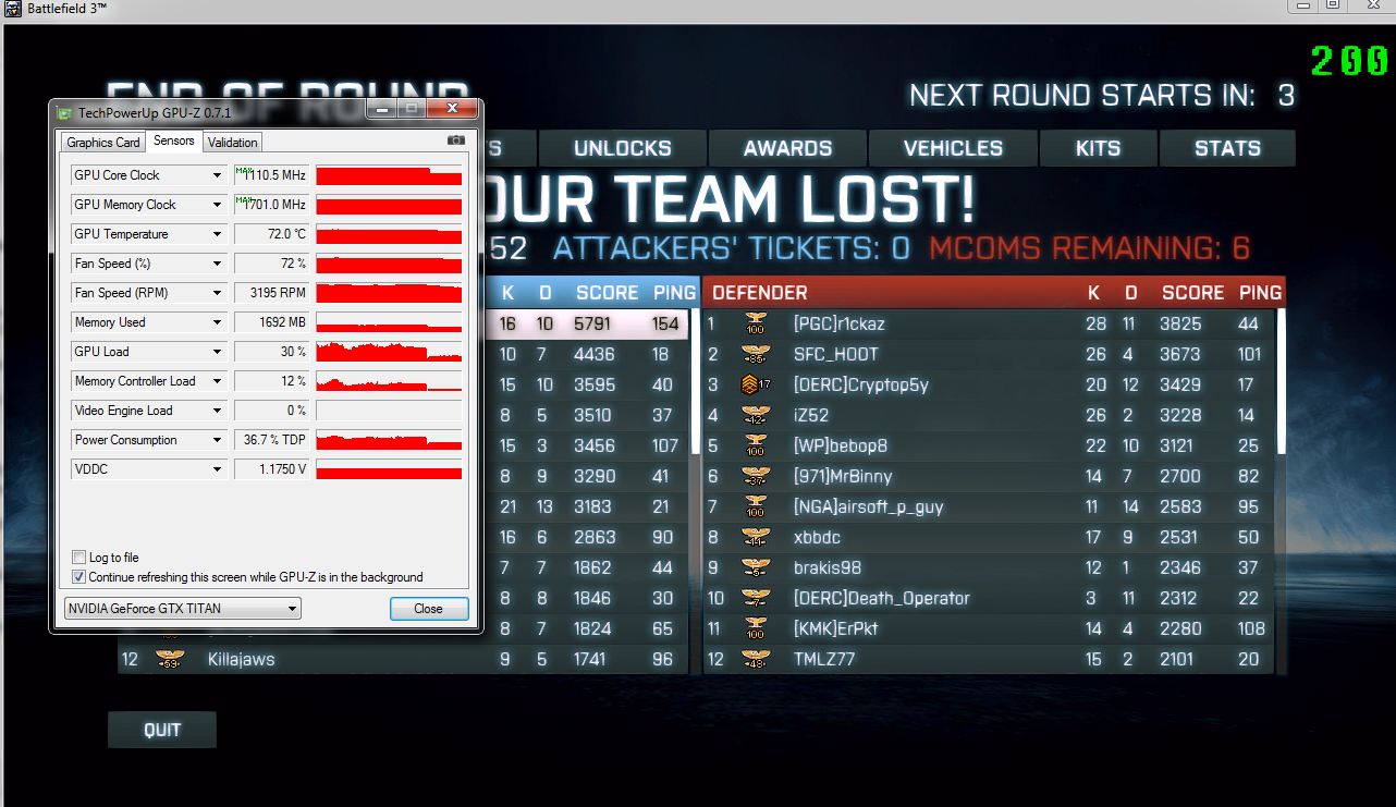

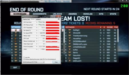

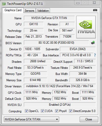

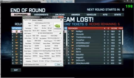

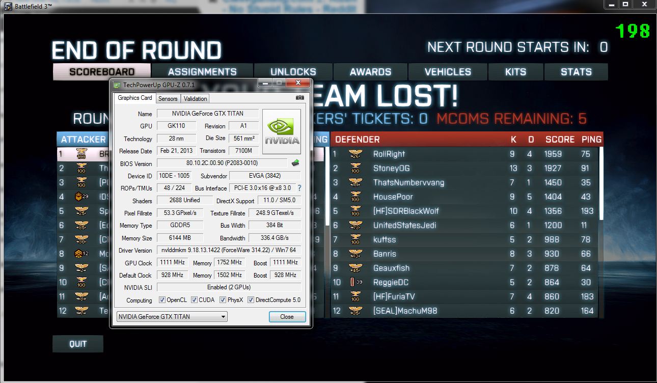

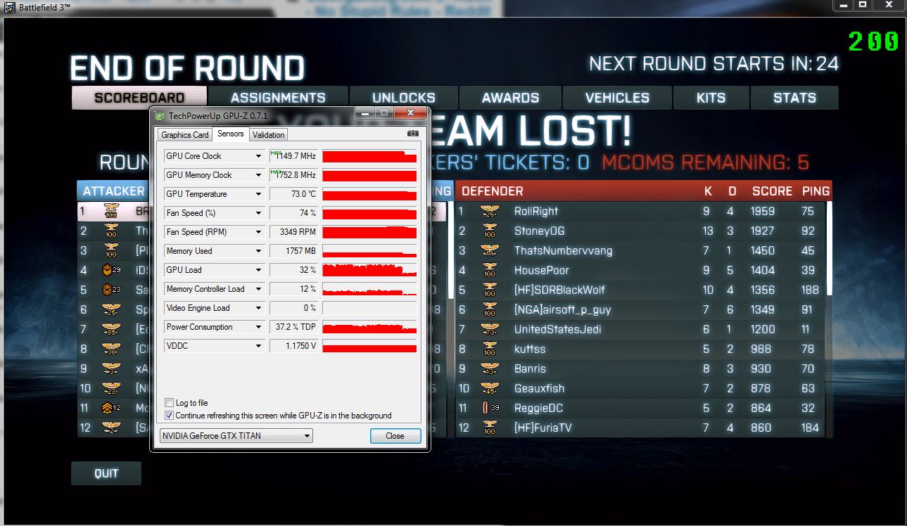

Founder Brian Posted May 21, 2013 Founder Share Posted May 21, 2013 Check out all this memory bandwidth, OC 100% stable and I think I can push the memory up to 1800 MHz: Here's 1752: Quote Link to comment Share on other sites More sharing options...

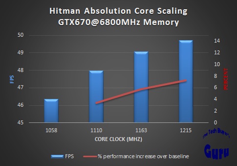

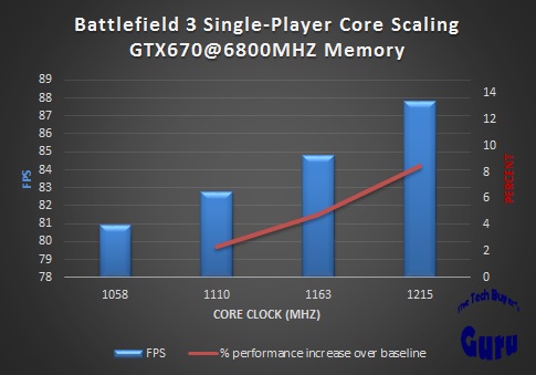

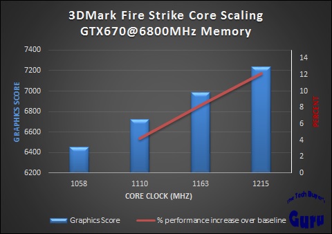

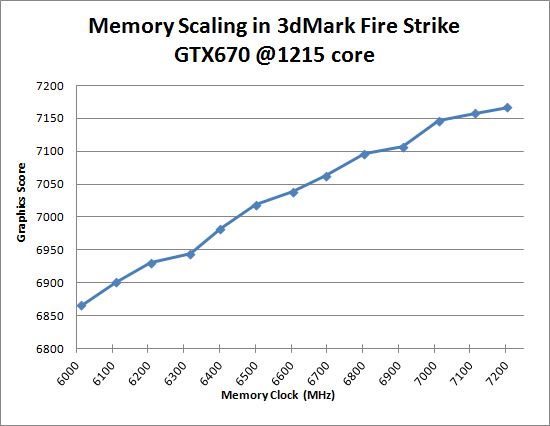

Founder Brian Posted May 21, 2013 Founder Share Posted May 21, 2013 Gonna need more memory bandwidth than that to carry your team I'm going to do some memory scaling testing on this Titan when I get some free time to see how much is optimal. This guy on AT did it for the 670, check it out:Video Card Core Overclocking Scaling Analysis (AMD and Nvidia) - AnandTech Forums About 7100 MHz is where the 670 starts topping off so I'm guessing the threshold could be higher for the Titan, maybe 1800 MHz? Quote Link to comment Share on other sites More sharing options...

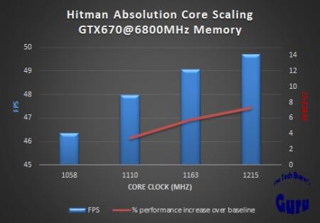

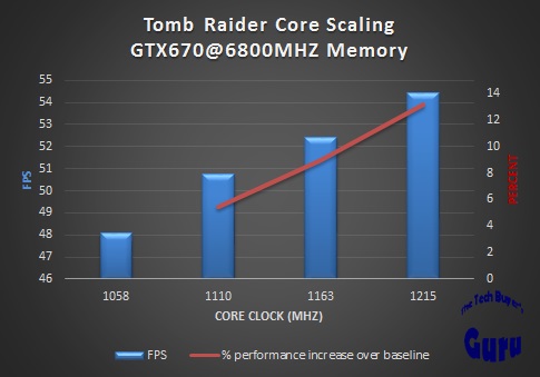

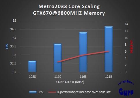

Khenglish Posted May 21, 2013 Share Posted May 21, 2013 I'm going to do some memory scaling testing on this Titan when I get some free time to see how much is optimal. This guy on AT did it for the 670, check it out:Video Card Core Overclocking Scaling Analysis (AMD and Nvidia) - AnandTech Forums[ATTACH=CONFIG]7582[/ATTACH][ATTACH=CONFIG]7583[/ATTACH][ATTACH=CONFIG]7584[/ATTACH][ATTACH=CONFIG]7585[/ATTACH][ATTACH=CONFIG]7586[/ATTACH][ATTACH=CONFIG]7587[/ATTACH]About 7100 MHz is where the 670 starts topping off so I'm guessing the threshold could be higher for the Titan, maybe 1800 MHz?That's only a bit over a 4% gain in fire strike for a 20% clock increase. What's funny is I see bigger gains with memory clocks in the combined test compared to the graphics test (680m = 670). Other tests/games really like more memory bandwidth too.Only way to find out is to run a bunch of stuff and see. I definitely do expect to see titan to be more memory clock dependent since the core is exactly 2x as strong as the 670 core, with only exactly 50% wider memory connection. Quote Link to comment Share on other sites More sharing options...
