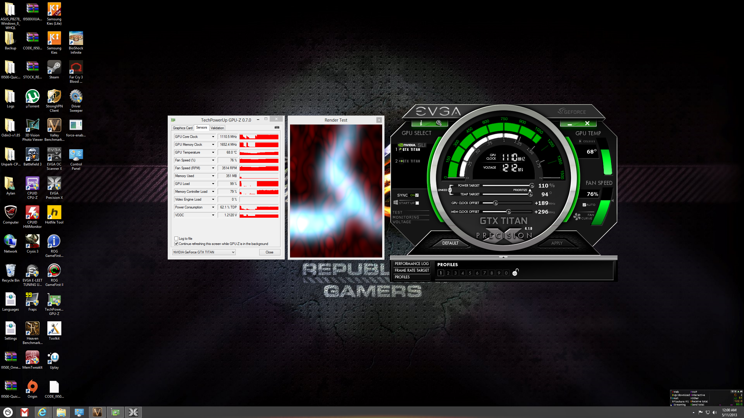

aylan1196 Posted May 10, 2013 Share Posted May 10, 2013 thanks svl7 for ur efforts I will try the oc bios and the uv bios and post results mainly gaming and some benchmarks thanks alot waz up this from oc bios http://gpuz.techpowerup.com/13/05/10/3dd.png and here is another one Quote Link to comment Share on other sites More sharing options...
