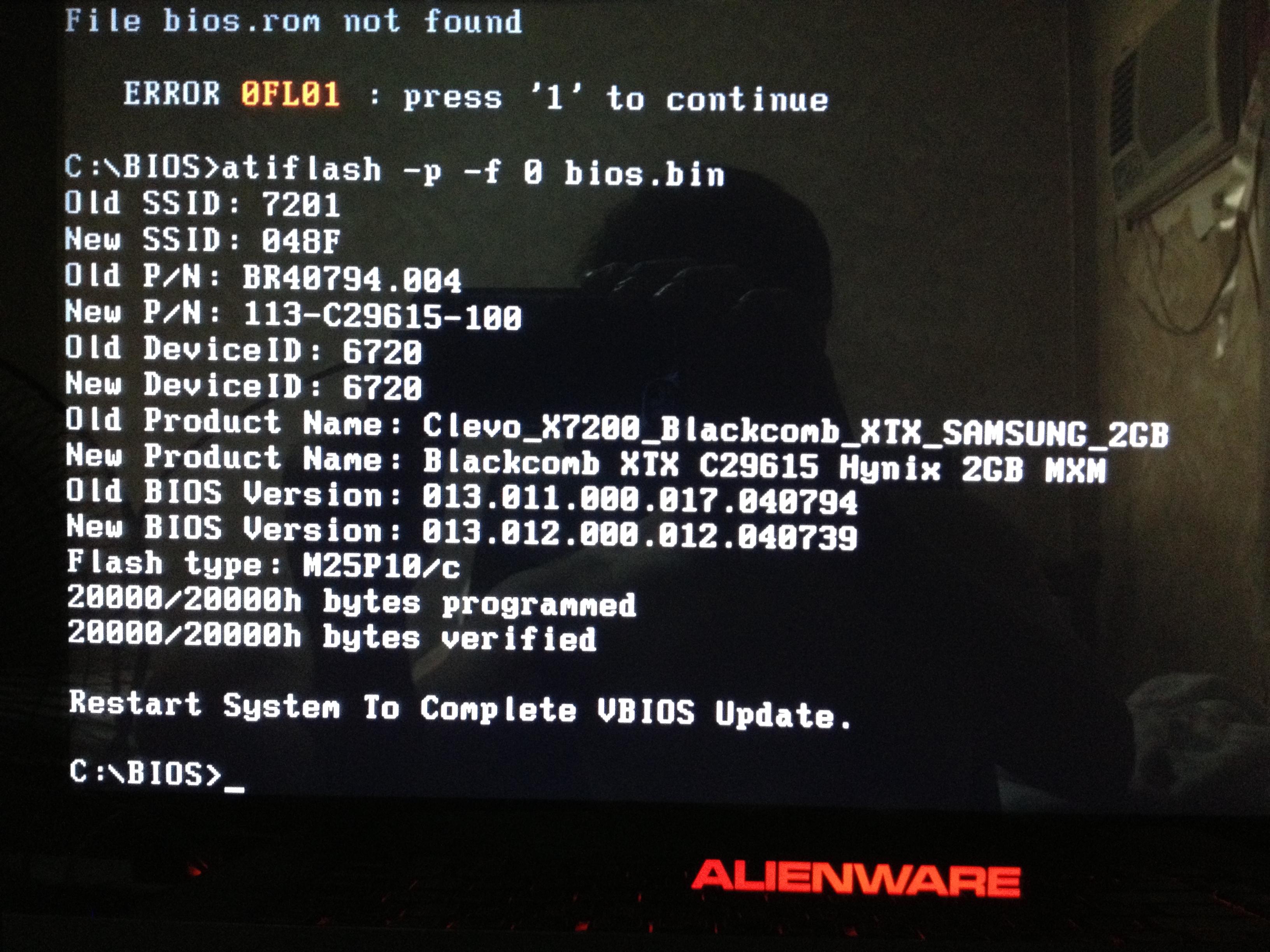

I tried reflashing my m15x 6990m's clevo vbios a second time. This time to a dell bios for that HDMI sound. I succeeded in flashing but... after a reboot, I was welcomed with no display and successful boots. I did a blind flash to restore my clevo vbios to get my card working properly again.
Now, here I am asking why that happened =\
I attached an image of what I THINK is a successful vbios flash along with both my dell and clevo vbios files.
bios.zip
