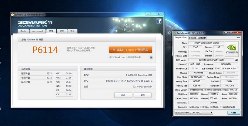

luoxia Posted February 10, 2013 Share Posted February 10, 2013 GT60 DDR 1600 8G 3720Qm <!--StartFragment --> MSI 675mx (4GB) - 80.04.58.00.0E_'OCedition'_rev00.zip msi 675MX OC 1007-1103 Stable. The request @svl7 to help change the core frequency and memory frequency voltage, very grateful! Quote Link to comment Share on other sites More sharing options...

elmo Posted March 9, 2013 Share Posted March 9, 2013 GT60 DDR 1600 8G 3720Qm <!--StartFragment -->MSI 675mx (4GB) - 80.04.58.00.0E_'OCedition'_rev00.zipmsi 675MX OC 1007-1103 Stable. [ATTACH=CONFIG]6005[/ATTACH]The request @svl7 to help change the core frequency and memory frequency voltage, very grateful!So what exactly does this do? I'm getting a 16F33 barebones very soon with a 675MX, will this work on it? Quote Link to comment Share on other sites More sharing options...
