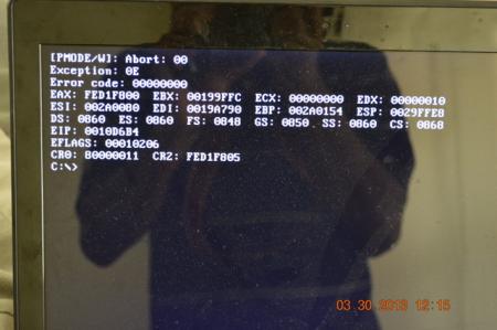

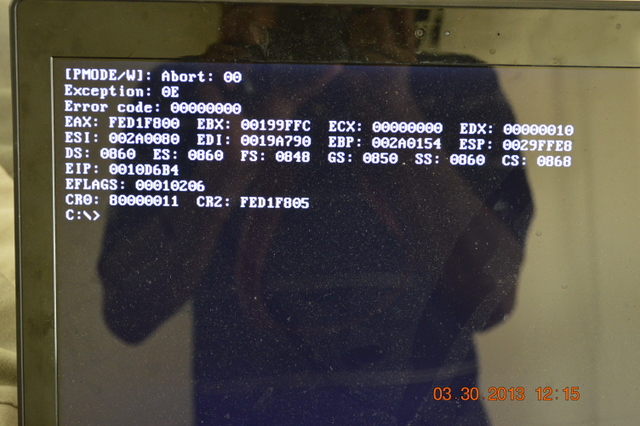

krumpet Posted March 30, 2013 Share Posted March 30, 2013 Hi SVL7, When I boot into dos and run this command: fpt -f biosfix.rom -bios I get the following error: The rest of the steps for backing up the bios works great. I only have the problem when I try to flash after booting into dos. Any suggestion? Quote Link to comment Share on other sites More sharing options...

svl7 Posted March 30, 2013 Author Share Posted March 30, 2013 Hi SVL7, When I boot into dos and run this command: fpt -f biosfix.rom -biosI get the following error: [ATTACH=CONFIG]6759[/ATTACH]The rest of the steps for backing up the bios works great. I only have the problem when I try to flash after booting into dos.Any suggestion?Did you follow the instructions in the first post step by step? Used the corresponding files for the DOS bootable drive? It seems to work for all others, so I assume the issue must lie somewhere there...How do I obtain a copy of my BIOS to send it to you? I am on v2.02 and would like to get it modded. I am not inexperienced with computers but have never extracted a BIOS before.Also, do these BIOS mods unlock the +135 MHz overclocking limit on this machine's GT 650M or no? Back when I modded my Y500 BIOS v1.05 I looked everywhere in the BIOS menu but couldn't find an option for this.I don't understand why Lenovo keeps releasing these BIOS updates without release notes or putting them on their downloads website. So far I have already seen 1.03, 1.04, 1.05, 1.07, 2.00, and 2.02. Don't even know if they have improved anything with these constant updates but it just creates headaches for those of us trying to mod.Dump the bios with this tool, there should be a backup.bat or so included.The GPU stuff is part of the vbios, you won't notice it in the bios, but as soon as you use an overclocking utility such as nvidia inspector you'll notice the change.Hello! Im a newbie the bios unlock. How can I get Windows 8 from DOS bootable USB drive? What the program name? tyDOS is an operating system, you boot from DOS, nothing with Win8. Follow the instructions in the first post, it's all there.If you can help me unlock my bios I will pay you. I just got my y500 this week, I have version 2.0 bios. Thanks HenryYes, might take until the end of the week, I'm not at home and I don't think I have all the necessary stuff the system I have currently with me. 1 Quote Link to comment Share on other sites More sharing options...

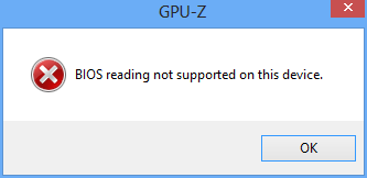

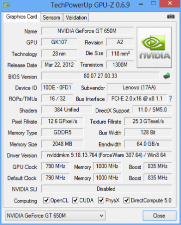

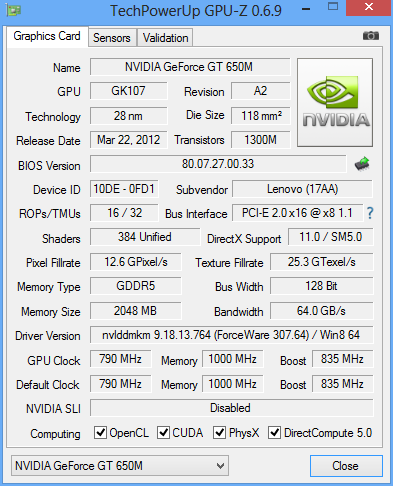

octiceps Posted March 30, 2013 Share Posted March 30, 2013 Yes, exactly.Well, actually I can't really remember whether I included the vbios mod in the mods I posted... let me know. If not tell me your vbios version. No you didn't post a vBIOS mod for the GT 650M in the Kepler vBIOS mods thread. The vBIOS version is 80.07.27.00.33. I tried using GPU-Z to save the vBIOS to a file but it kept returning this error. EDIT: Disregard my question about the error. I just realized that since I have a laptop the vBIOS is part of the BIOS and can't be extracted this way. Quote Link to comment Share on other sites More sharing options...

krumpet Posted March 31, 2013 Share Posted March 31, 2013 Did you follow the instructions in the first post step by step? Used the corresponding files for the DOS bootable drive? It seems to work for all others, so I assume the issue must lie somewhere there...I wiped my thumb drive and re-downloaded all of the files again. I rebuilt my thumb drive with the bootable files. I extracted all of the files into the root directory to my thumb drive from FPT_DOS.zip, prr.zip, Y500BiosFix.zip, and the Lenovo_Y500_BIOS_v.1.05.Mod.zip I booted into dos from my thumb drive. I ran backup.bat, then backed up my original bios to "original.bin" Then I pointed to 13Y500.rom for the modified file. This created the 13Y500Fix.rom and then renamed it to fixed.rom (so it is 8 characters or less) I ran pff.exe - everything is okay so far. I ran fpt.exe -f fixed.rom -bios and I got the previous error again. Notes from fpt -i ==================== Intel ® Flash Programming Tool. Version: 8.0.10.1464 Copyright © 2007 - 2012, Intel Corporation. All rights reserved. Platform: Intel® HM76 Express Chipset Reading HSFSTS register... Flash Descriptor: Valid --- Flash Devices Found --- W25Q32BV ID:0xEF4016 Size: 4096KB (32768Kb) W25Q16BV ID:0xEF4015 Size: 2048KB (16384Kb) --- Flash Image Information -- Signature: VALID Number of Flash Components: 2 Component 1 - 4096KB (32768Kb) Component 2 - 2048KB (16384Kb) Regions: Descriptor - Base: 0x000000, Limit: 0x000FFF BIOS - Base: 0x180000, Limit: 0x5FFFFF ME - Base: 0x001000, Limit: 0x17FFFF GbE - Not present PDR - Not present Master Region Access: CPU/BIOS - ID: 0x0000, Read: 0x0B, Write: 0x0A ME - ID: 0x0000, Read: 0x0D, Write: 0x0C GbE - ID: 0x0118, Read: 0x08, Write: 0x08 Total Accessable SPI Memory: 6144KB, Total Installed SPI Memory : 6144KB FPT Operation Passed =========================== If I run the fptw64 through windows, I get the famous error 28. If you have a way to fix this, I'll buy you more than coffee. 2 Quote Link to comment Share on other sites More sharing options...
