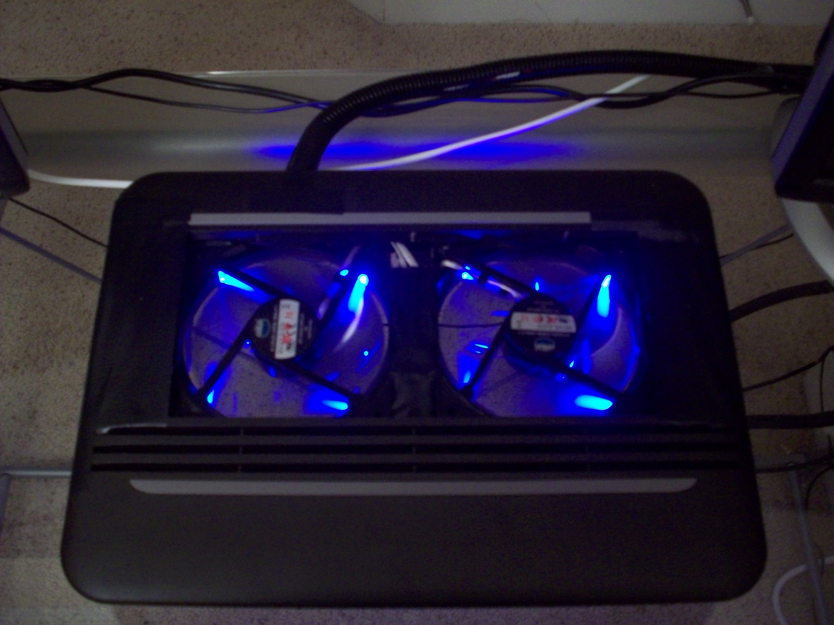

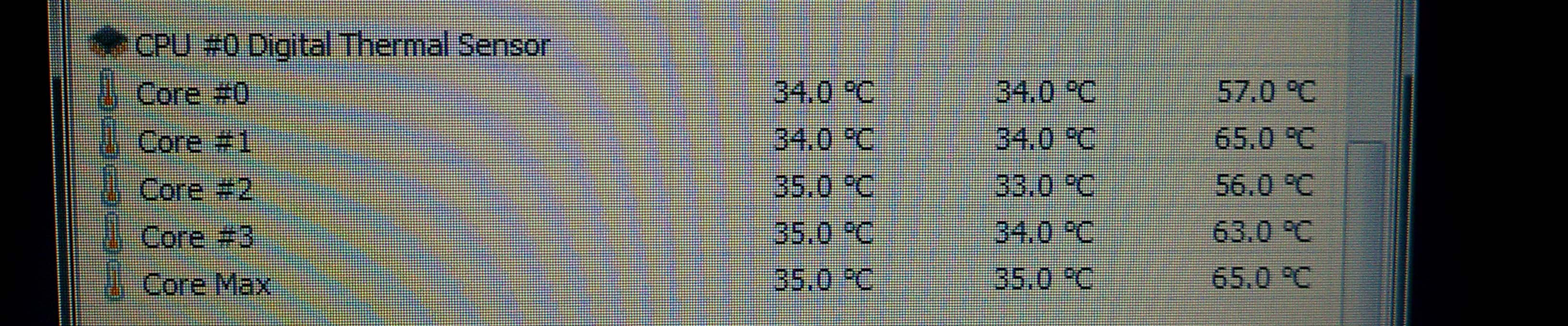

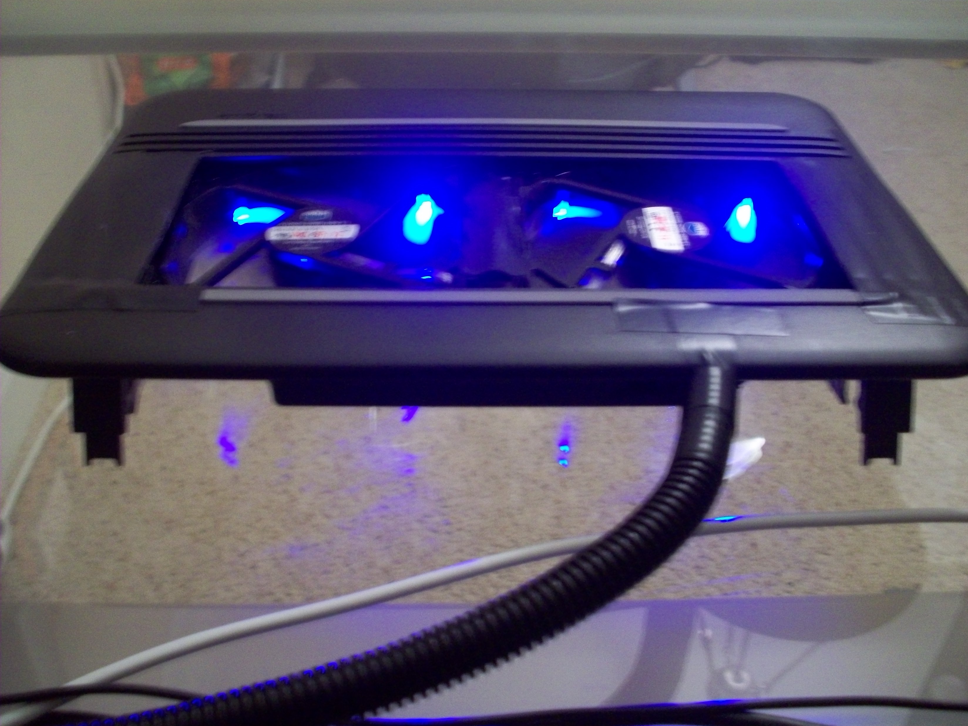

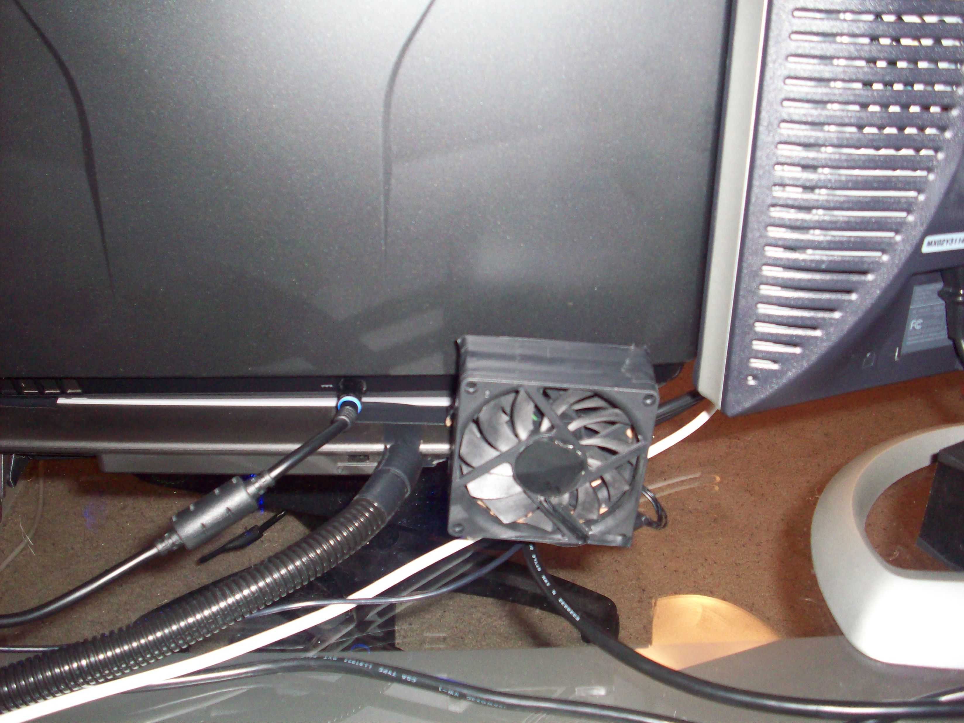

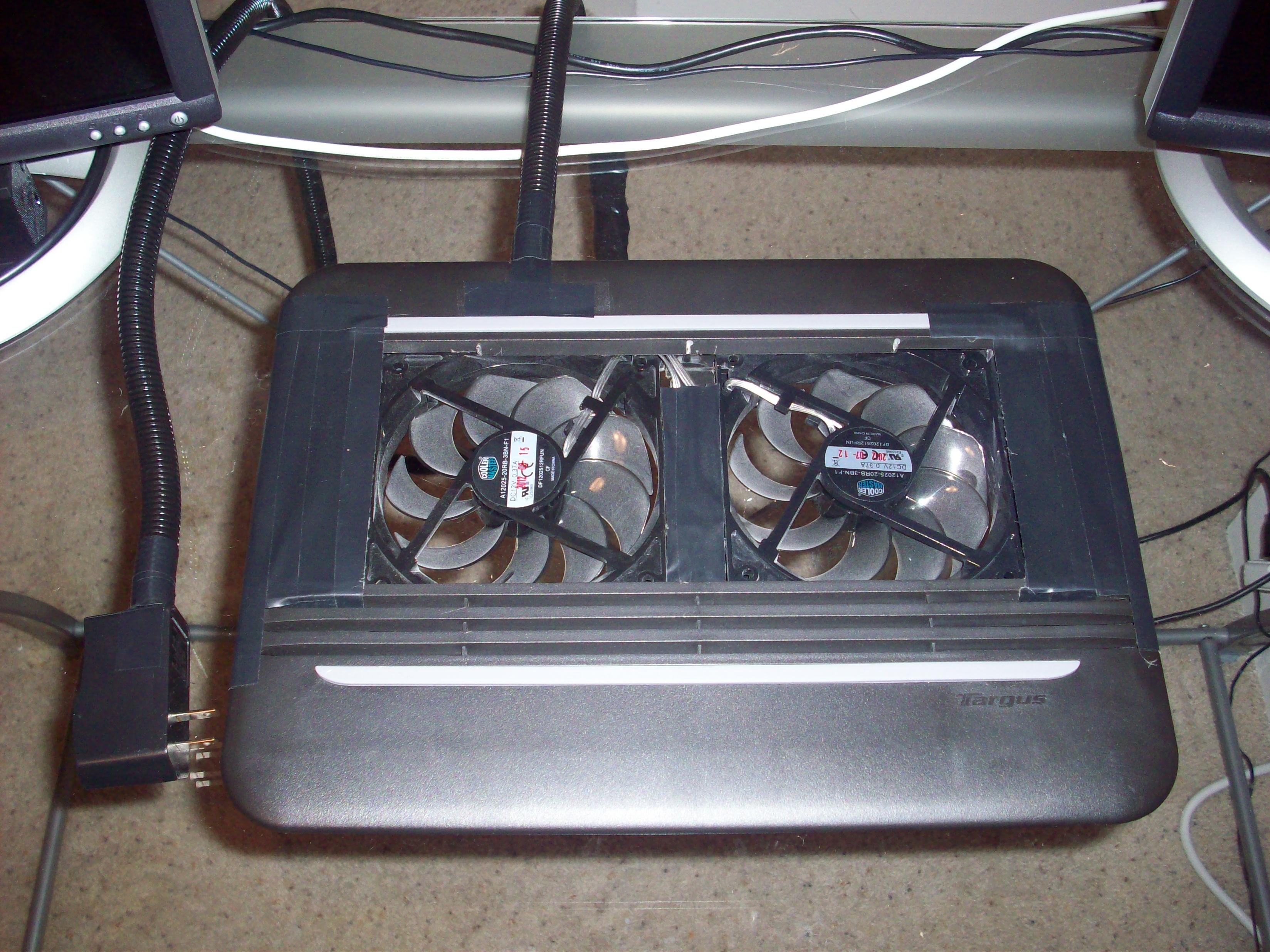

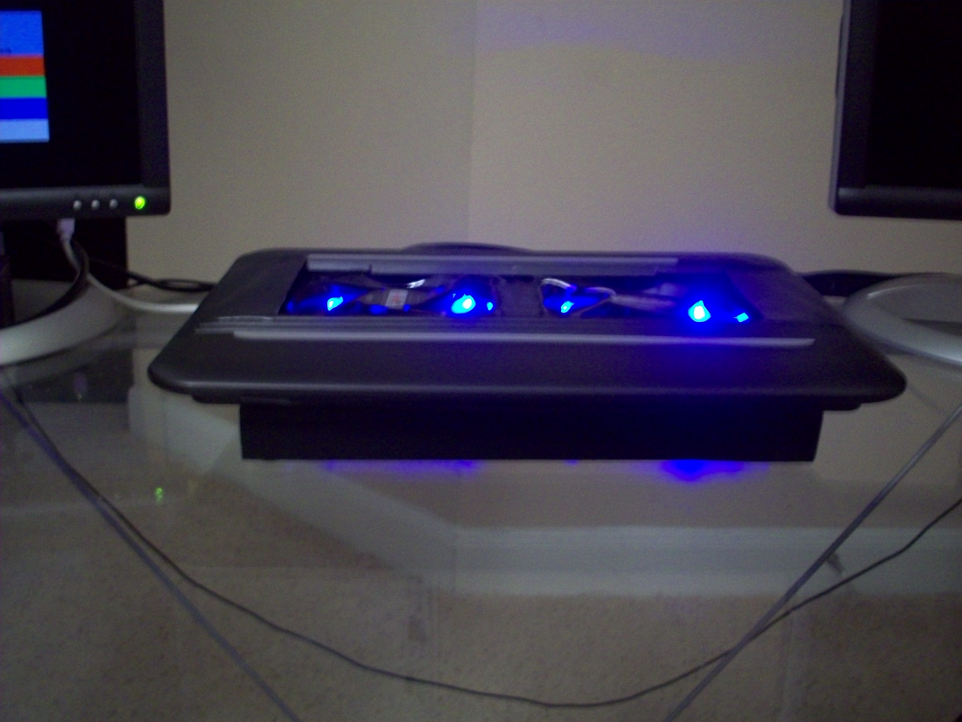

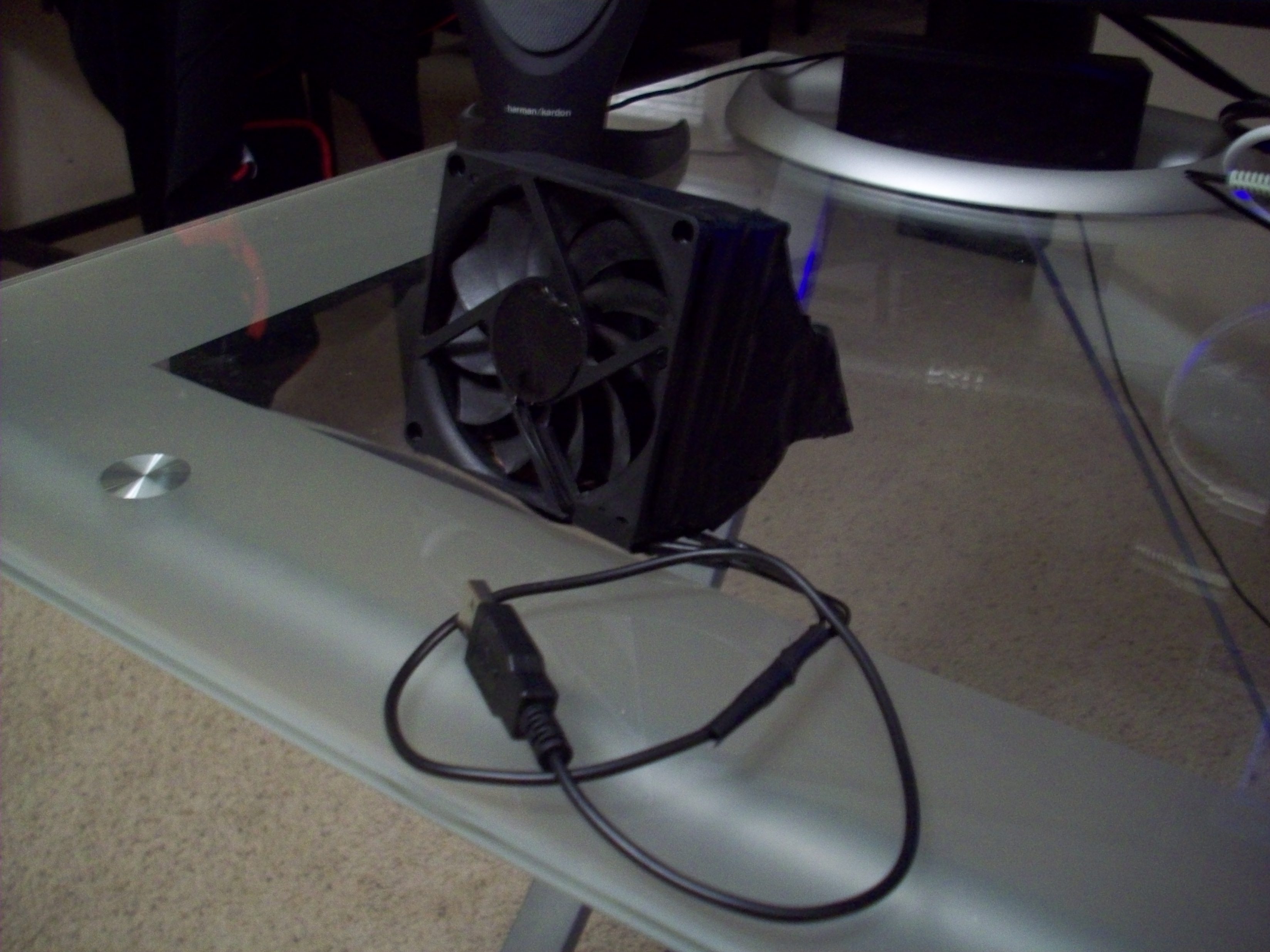

Well I recently got into overclocking and was looking into good laptop stands. After a few weeks of research I realized that there weren't many good laptop stand for this laptop. especially because of the hot spots being as high as they are. I took matters into my own hands and built my own. I had an old targus chill mat xc laying around and decided to take purchase some 120mm and make them fit the stand. I bought 2 cooler master 120mm fans (not a big fan of the blue leds but they were on sale). The dba's are around 19 and the air flow is 60cfm. To power the new fans i bought a 2x12 volt ac adapter to power the fans. Then used the old fans that came with the stand and built a suction fan that is pointed directly at the cpu vent. After all this the total cost was under 20 dollars since I already had a stand. As for the temps, my laptop used to run idle at 50-52 on extreme settings level 3. Now after change thermal paste to artic 5 and adding the laptop stand I idle at 35. If any has any question about the stand let me know.

Nice mod, does it get loud? Sometimes you can get the same or very similar drop in temperature by simply raising the notebook using lifts. We have an article about that with some results here: http://www.techinferno.com/2012/01/27/how-to-keep-your-notebook-cool-laptop-lifts-review/

Hello if you interest in the fan building process let me know I can help you if you need some help. Also regarding the water cooling system, I had to put it on hold because of final this week. But I am now done and should have an update by this weekend.
