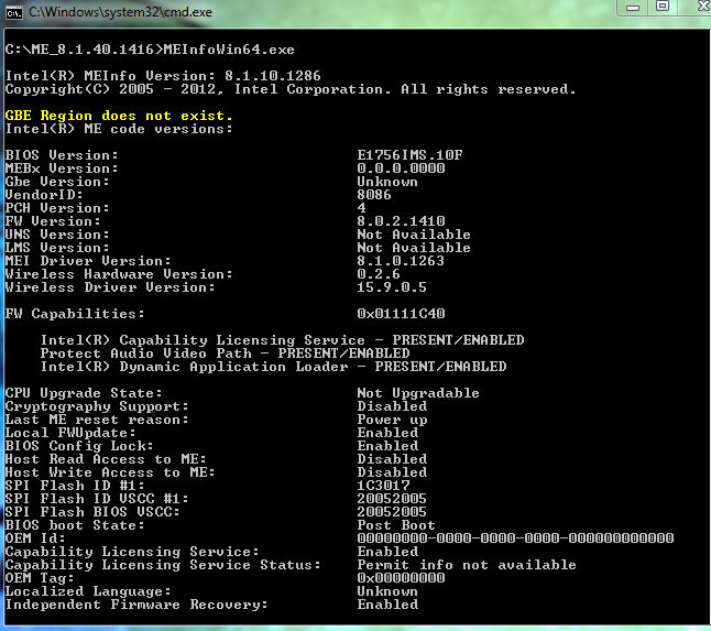

James D Posted September 6, 2013 Share Posted September 6, 2013 Hey people. I have just flashed new MW firmware without a glitch. Like a driver update it was so simple! Maybe it is only on MSi but here is MEInfo and it says that local firmware update is enabled. Anyway, I just used bat file with code: FWUpdLcl64 -save old.binFWUpdLcl64 -f ME_8.1.40.1416.BINpause and newer firmware and that's it. ALthough I haven't checked if that gave me anything exept newer version. Guy Klem66 did that on his GE series laptop and shared this info with me. Quote Link to comment Share on other sites More sharing options...

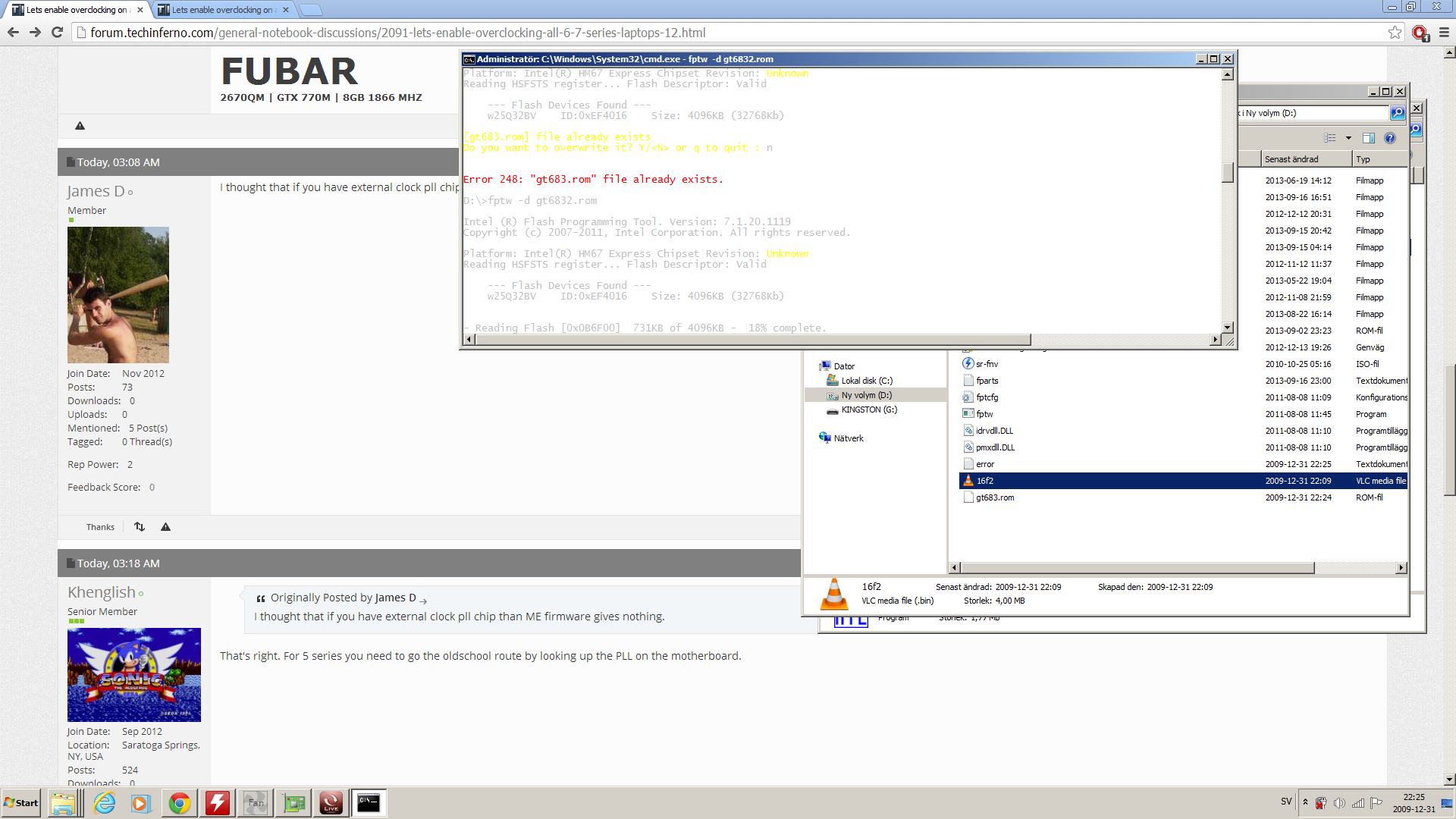

Moderator BAKED Posted September 17, 2013 Moderator Share Posted September 17, 2013 I have edited my firmware with FITC and programmed an empty chip with it, desoldered the old one and so on and now I've got read and write access I have'nt tried flashing anything yet though. Quote Link to comment Share on other sites More sharing options...
Khenglish Posted September 17, 2013 Author Share Posted September 17, 2013 I have edited my firmware with FITC and programmed an empty chip with it, desoldered the old one and so on and now I've got read and write access [ATTACH=CONFIG]9002[/ATTACH][ATTACH=CONFIG]9003[/ATTACH] I have'nt tried flashing anything yet though. Well if you give me a dump I'll unlock BCLK for you. Again I highly recommend against the windows version of FPT. I linked the DOS version in my last post. Quote Link to comment Share on other sites More sharing options...

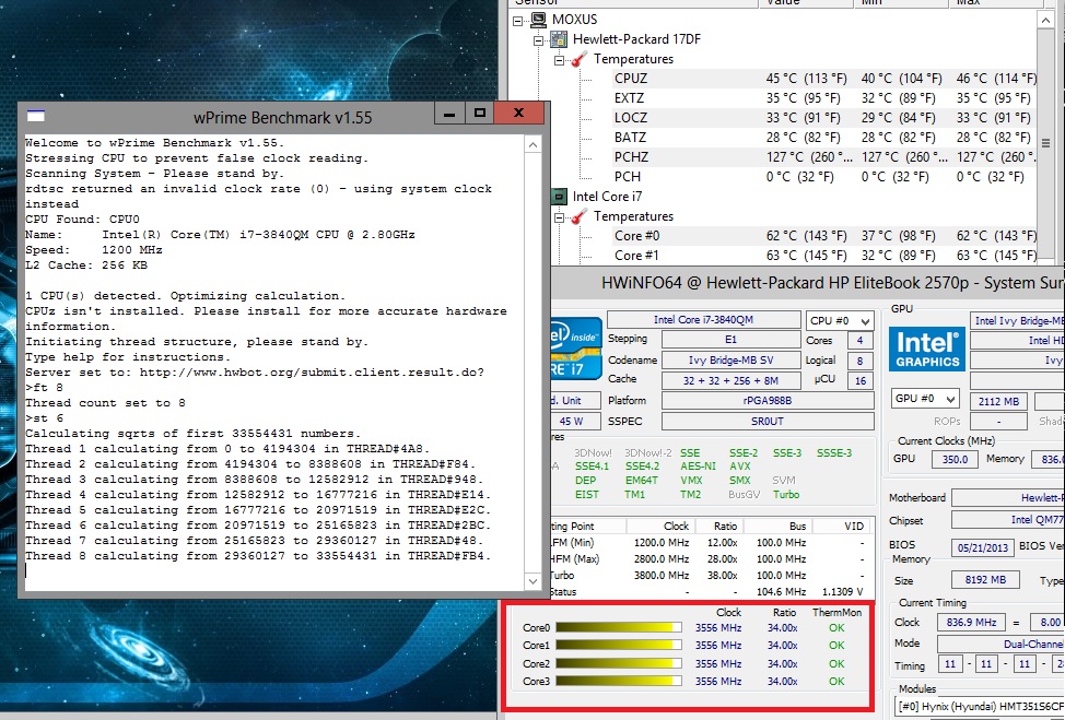

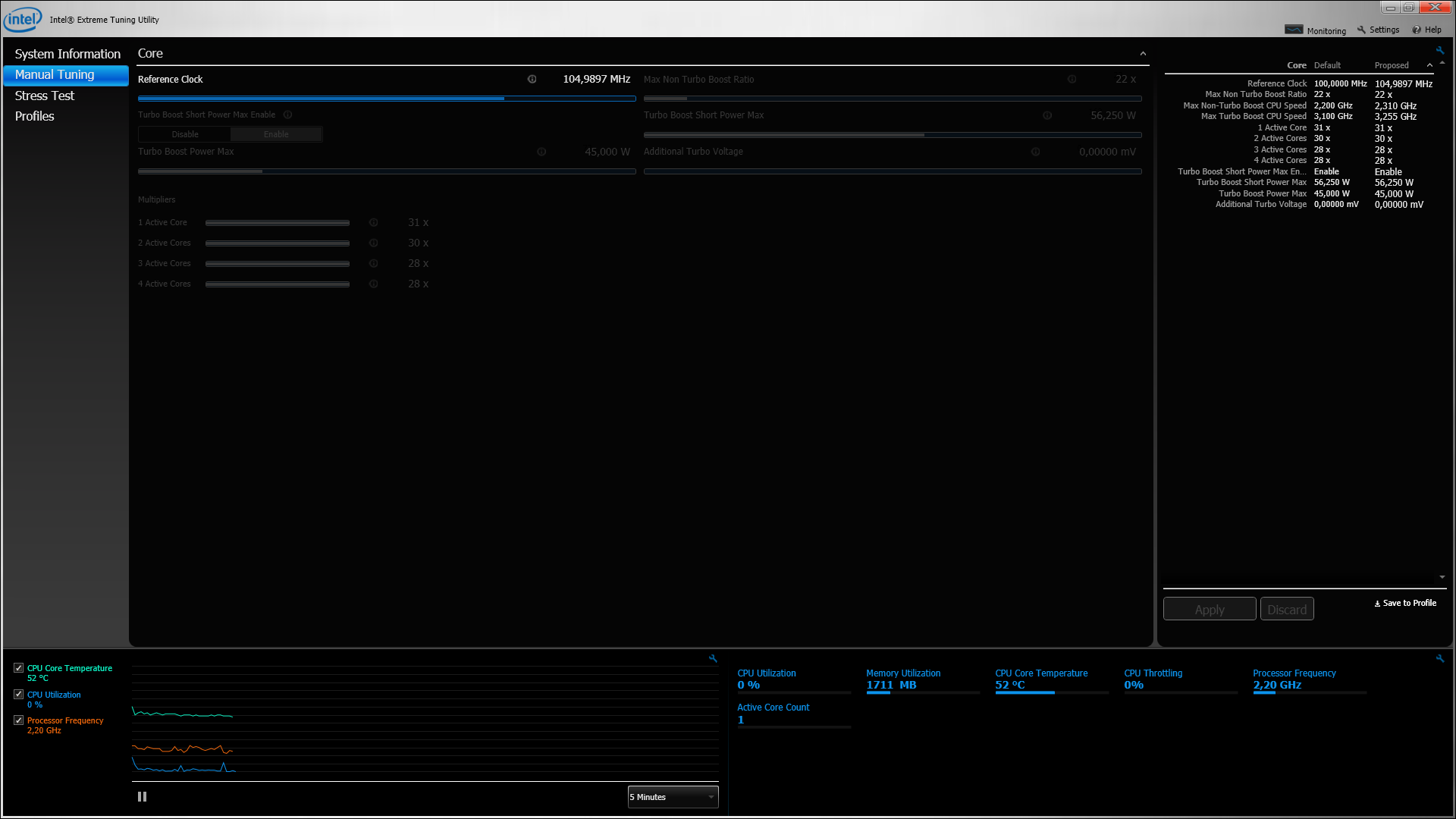

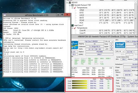

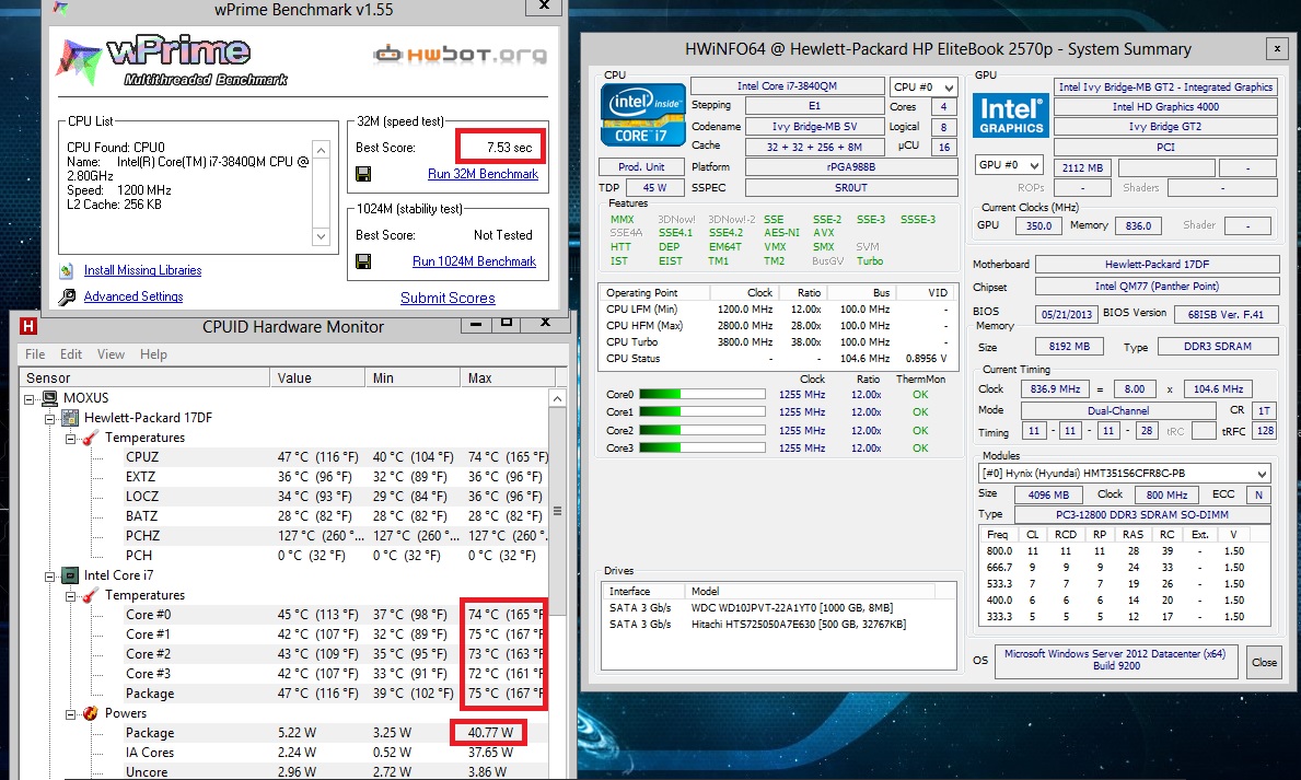

Aikimox Posted September 17, 2013 Share Posted September 17, 2013 First, big thanks to Khenglish for modding the ME FW for me! I didn't think there would be any chance of overclocking my machine (HP Elitebook 2570p) but I was wrong! Here's the detailed info on how to flash and were to get the modded BIOS. So after flashing I still couldn't see the reference clock slider in XTU. So, I reinstalled it a few times and eventually used one of the older versions. Dunno what exactly did the trick, maybe an older version, a number of reinstalls but it got unlocked in the end! Previously the CPU was locked at 38-39W and 3.4ghz on all cores, but as you can see from the screenshot below it can now hold 3.55Ghz @40W and 104.8BCLK!!! Now, if only there was a way of further unlocking the BIOS to get some more juice for the CPU, I'm sure it would be able to go all the way up and beyond 4ghz. I'll need to work on the cooling system next to prepare for the possibility 1 Quote Link to comment Share on other sites More sharing options...

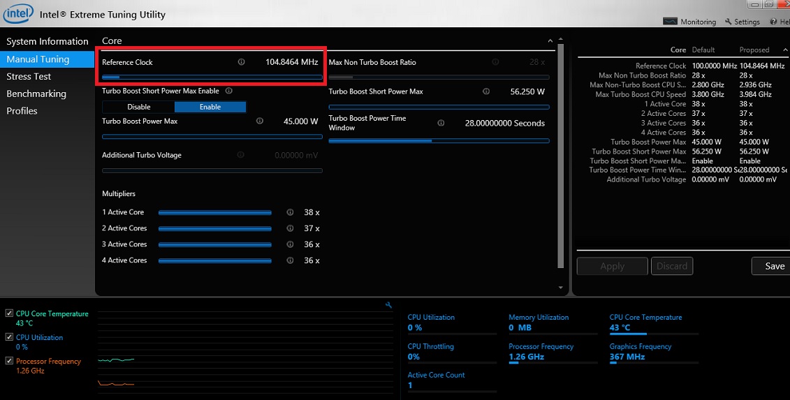

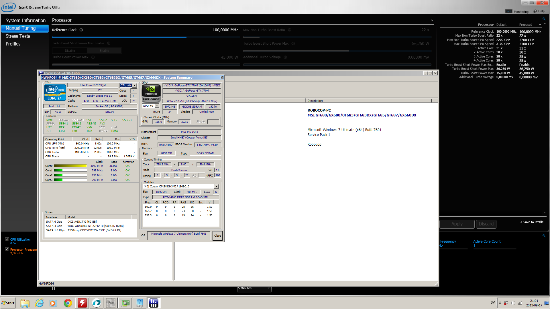

Moderator BAKED Posted September 17, 2013 Moderator Share Posted September 17, 2013 Yes I've looked at MSI before and found that they have the PLL set properly for overclocking, but they failed to set up the flags for XTU to understand the clock control. That's a shame.. So there's no chance of being able to use xtu? I can increase the BCLK in BIOS though. EDIT: I'm now able to change the reference clock with xtu Working versions: 3.1.201.5, 3.2.0.24 Quote Link to comment Share on other sites More sharing options...
Khenglish Posted September 17, 2013 Author Share Posted September 17, 2013 That's a shame.. So there's no chance of being able to use xtu? I can increase the BCLK in BIOS though.EDIT: I'm now able to change the reference clock with xtu [ATTACH=CONFIG]9011[/ATTACH][ATTACH=CONFIG]9013[/ATTACH] Working versions: 3.1.201.5, 3.2.0.24 Oh wow it works by default. I looked at an MSI for someone else before and we had problems. As for XTU flags other than BCLK maybe prema can tell me. He did figure out how to get the P150EM flagged properly, although he did have the virtually identical P170EM bios to work off of. If you have an AMI based BIOS I know how to hard set multipliers in BIOS, but for other makers I don't know. I'll check tonight. 1 Quote Link to comment Share on other sites More sharing options...
Moderator BAKED Posted September 17, 2013 Moderator Share Posted September 17, 2013 Oh wow it works by default. I looked at an MSI for someone else before and we had problems. As for XTU flags other than BCLK maybe prema can tell me. He did figure out how to get the P150EM flagged properly, although he did have the virtually identical P170EM bios to work off of. If you have an AMI based BIOS I know how to hard set multipliers in BIOS, but for other makers I don't know. I'll check tonight. I was surprised it worked It only works with those specific versions of XTU, I have AMI so it would be awesome if you could do that for me Quote Link to comment Share on other sites More sharing options...
