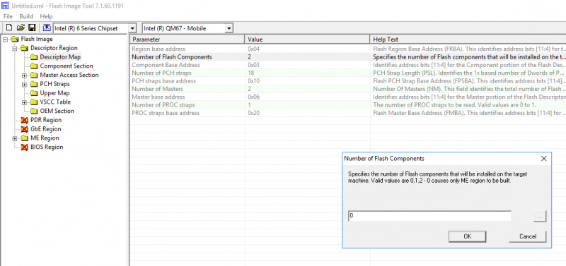

I discovered a workaround for those trying this on a 6-series chipset:
  1. Download HxD
  2. Open the ocme.bin from the OP in FITC
  4. After doing that, tap f5 to build it and leave FITC opened.
  5. Locate outimage.bin which will either be in the root directory of FITC or in a folder called ocme or Build. Once found, rename it and copy it to another location, I'll call this OC.bin
  6. Open another instance of FITC with your ME FW dump, let's call this me.bin
  7. Go back to the previous FITC instance (ocme.bin) and change all of its settings to match me.bin
  8. Build the image, locate the new outimage.bin (same location as before), verify it is the one you just changed by looking at the timestamp and rename it to original.bin
  9. Open original.bin and OC.bin in HxD, tap CTRL + K and then enter, this will compare the two images and highlight each different bit which coorresponds to the changes made in FITC (converted into little endian but you don't need to know that). You can use F6 to cycle to the next difference or Shift + F6 for the previous difference
  10. Open your me.bin in HxD.
  11. Proceed to carefully change ONLY the bits which are different between original.bin and OC.bin. DO NOT change it according to the line number/bit location because they will never be aligned.
  12. Instead, locate a series of 3-4 bits around the target difference and use CTRL + F to find the same series of bits in me.bin, then change the necessary bit accordingly to match the value in OC.bin
  13. After you're done, save the file and flash using FPT.
Edited by blowntaha
