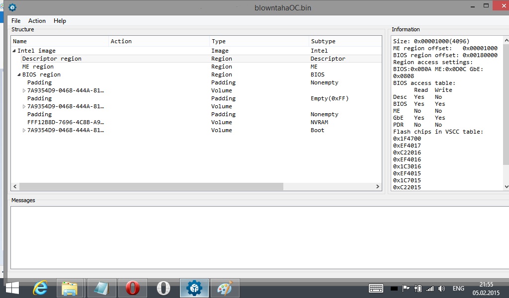

blowntaha Posted February 5, 2015 Share Posted February 5, 2015 Here it is unlocked.blowntahaOC How do I flash under EFI using the fpt.efi? Would that maybe make a difference? Btw, renamed BlowntahaOc -> ocme in case you're wondering if I flashed the correct image; I just tried again in Windows as well with no success. I think there might be a setting in the FW image that makes or breaks my flash because sometimes I am able to flash and other times I am not able. Do you think you could upload the full image for me to try? Or could it be that my 3920XM version is somehow interfering? Quote Link to comment Share on other sites More sharing options...
Khenglish Posted February 5, 2015 Author Share Posted February 5, 2015 Here's the full image:blowntahaOC 1 Quote Link to comment Share on other sites More sharing options...
Bios Modder Klem Posted February 5, 2015 Bios Modder Share Posted February 5, 2015 As we can see, now in your bios, in descriptor region, access to ME region is locked. No read, no write. Now you have only two way, one flash mod bios with programmer device, other one flash mod bios with pinmode on audio chip. Quote Link to comment Share on other sites More sharing options...
blowntaha Posted February 5, 2015 Share Posted February 5, 2015 EDIT:As we can see, now in your bios, in descriptor region, access to ME region is locked. No read, no write. Now you have only two way, one flash mod bios with programmer device, other one flash mod bios with pinmode on audio chip.So, you're saying I can't do what this guide does? The brief tldr; version, he finds ME bios in hex editor (which has main bios open) highlights the ME FW portion and saves it as dump.bin. Opens it FITC, mods it, open in hex, copy and pastes over old. I actually did all of this and have it ready to flash, only I wanted to come here first and make sure I'm not missing something that I shouldn't do this. Problem is when I copy and paste ME from bios in hex and save, it is 1532 KB, then after modifying it and rebuilding it, and reopening it to get the smaller parts, I get no file which is 1532 KB. Closest sized file is 1396 KB which is not the same length in hex editor meaning some random text will be before or after the me fw data so.... could that cause problems? Quote Link to comment Share on other sites More sharing options...
Bios Modder Klem Posted February 6, 2015 Bios Modder Share Posted February 6, 2015 Modifing ME and flash ME it is different things. I told you that in your case access to read/write region ME is locked. Locked in descriptor region. In this case does not matter correct or not you insert ME in bios, because lock dont get you access to flash this region. Quote Link to comment Share on other sites More sharing options...

blowntaha Posted February 9, 2015 Share Posted February 9, 2015 As we can see, now in your bios, in descriptor region, access to ME region is locked. No read, no write. Now you have only two way, one flash mod bios with programmer device, other one flash mod bios with pinmode on audio chip. Wait a second, if that is the case then how was I able to produce this dump? I took a picture after the second time flashing, thinking that something went wrong after the first time. If I was able to read the ME FW to make a dump, and able to flash it (proof below), why am I unable to now? & If I do a full bios flash, modding the bios .bin by replacing the old me fw with a modified one (in hex edit), setting MEUPdate=1 in platform.ini, might that work? Also, I just dumped my descriptor to see whether or not I'd be able to, and I was able to. Is there something I could do with that dump to enable read/write on ME? Quote Link to comment Share on other sites More sharing options...
Khenglish Posted February 9, 2015 Author Share Posted February 9, 2015 @blowntaha I don't get why you can dump. You flash descriptor said you had no read access.Anyway, here's a full image with an unlocked descriptor and firmware.blownOC2 Quote Link to comment Share on other sites More sharing options...
blowntaha Posted February 9, 2015 Share Posted February 9, 2015 @blowntaha I don't get why you can dump. You flash descriptor said you had no read access.Anyway, here's a full image with an unlocked descriptor and firmware.blownOC2I was able to flash and dump freely when I first started meddlig in ME FW. I think I may have flashed either a bugged/corrupted FW, or one with certain settings that may have messed something up. Would it be possible for me to mod a full bios .rom, enter BIOS recovery by hitting the required keys while powering on laptop to enter recovery mode and let it flash that way? Would that flash the ME as well? FYI, the pic I posted earlier was of one after successfully flashing. But now, I can't even dump.If I'm unable to unlock descriptor, I think I might just buy an spi programmer... How do I know which one to get and if it will be compatible? Quote Link to comment Share on other sites More sharing options...
Khenglish Posted February 9, 2015 Author Share Posted February 9, 2015 I was able to flash and dump freely when I first started meddlig in ME FW. I think I may have flashed either a bugged/corrupted FW, or one with certain settings that may have messed something up. Would it be possible for me to mod a full bios .rom, enter BIOS recovery by hitting the required keys while powering on laptop to enter recovery mode and let it flash that way? Would that flash the ME as well? FYI, the pic I posted earlier was of one after successfully flashing. But now, I can't even dump.If I'm unable to unlock descriptor, I think I might just buy an spi programmer... How do I know which one to get and if it will be compatible?You could try recovery. Can't hurt.fpt will read out your flash ROM parts. Get a programmer that supports them. The one I use is a TL866. Quote Link to comment Share on other sites More sharing options...
blowntaha Posted February 9, 2015 Share Posted February 9, 2015 You could try recovery. Can't hurt.fpt will read out your flash ROM parts. Get a programmer that supports them. The one I use is a TL866. Woohoo! The BIOS recovery worked, at least as far as I can tell. MEINFO is showing read/write access as enabled, although my ME re-flash firmware is disabled in BIOS. It also seemed to reset all of my NVRAM vars I fiddled with which I've read in numerous places emphasizing that it does not reset NVMRAM. I ran MEINFO right after the first (me-only) flashing, it gave me an error Error 9459: Internal error (Could not determine FW features information) I also realized I forgot I didn't do a cold boot so I reflashed the one you uploaded (used one I modified for first one), cold booted, and will edit this to report back. EDIT: everything still seems locked, going to try once more, but not reflash because I forgot I modified full BIOS.rom and added it in there... /facepalm EDIT 2: Okay.... So I went into BIOS recovery, and it successfully flashed the modified ME FW, I verified this by fpt -me -d -me.bin and checking if the proper bits in hex edit were set. Also, fpt -DUMPLOCK shows which is what they should be if they are in fact unlocked. I completed all of this error-free (rather, I didn't repeat anything that would produce errors, such as running meinfo, and reflashing unnecessary firmware). After finally unlocking flash descriptor, XTU still does not unlock my multipliers, nor does throttlestop. Attached is my current ME FW dump. All help is appreciated (it really is). EDIT3: Just opened dump in fitc and saw wrong settings, gonna retry me.zip Quote Link to comment Share on other sites More sharing options...
blowntaha Posted February 9, 2015 Share Posted February 9, 2015 You could try recovery. Can't hurt.fpt will read out your flash ROM parts. Get a programmer that supports them. The one I use is a TL866.I re-flashed a third time, and then dumping my me bios to verify in FITC. I can 100% positively say that the settings match the ones in the me fw you uploaded for me. However everything still appears locked. I noticed a 'Clock Commander Tool' inside the zip of the ME tools, could that possibly help troubleshoot?I've attached my newest, corrected, current ME dump.OCME3DMP.zip Quote Link to comment Share on other sites More sharing options...
