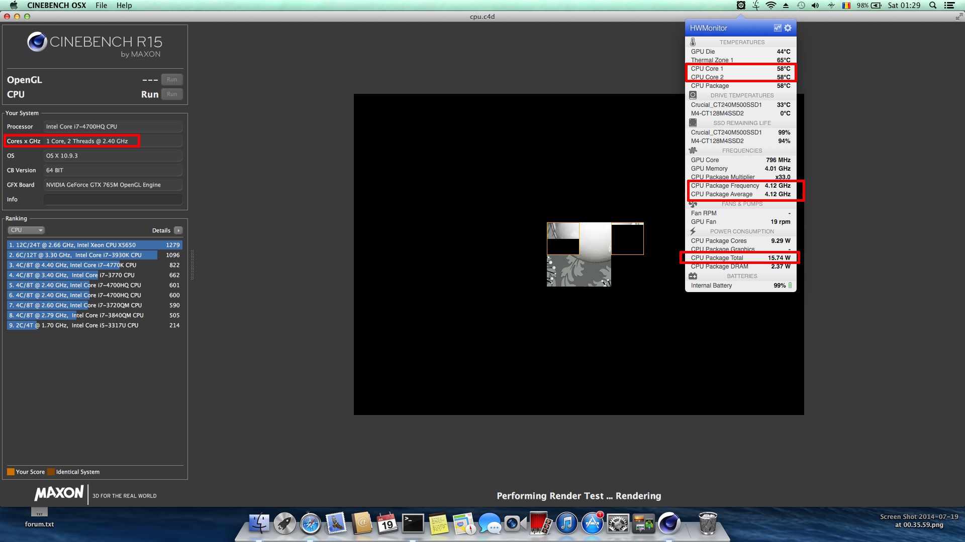

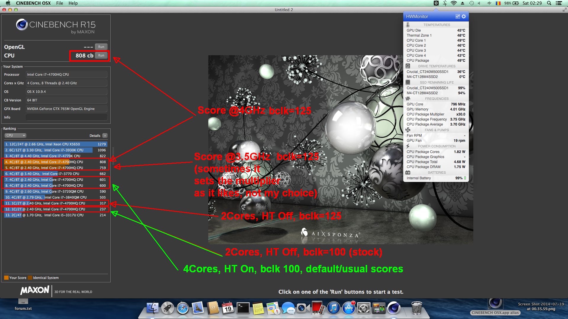

Arise Posted July 18, 2014 Share Posted July 18, 2014 Not quiet in the mood to sleep after reading all above, so I decided to get off my bed and test the bclk in Clover. There is something fishy, because the multiplier runs at whatever value it feels like when I start the bench, it won't boost at highest value, don't know why, maybe it is a bug, a limitation from Apple or my buggy kexts and DSDTs regarding C-States. Anyway, I found out that throttling also happens, but not always, sometimes throttling kicks in and keeps my CPU under default power envelope (under 47W), sometimes it can go over that value. In order to test a couple of scenarios, I also disabled 2 cores and hyperthreading to keep the power/temperature down. Before showing you my screenshots, let me tell you something: Cinebench score for a 4700HQ in MacOS is about 600 points (sometimes 599, sometimes 602, etc). I can get the same value from multiple sources. Now, with my CPU in 2 cores and HT Off I was able to run my CPU at 4.12GHz (33x 125). - max frequency achieved. At four cores with HT on I was able to run the whole test at 4GHz (32 x 125) basically ignoring the TDP limit, but this is not something I can reproduce every time. Other times, it just goes at lower multipliers like 28 or 30, and that happens random, even when at stock bclk of 100. So you may still ask, does this bclk from Clover works? The answer is a strong yes, because I was never able before to get more than 600 points in Cinebench, now I got 800+. Does it works in Windows? Sadly no, booting in Windows from Clover instead of MacOS and running CPU-Z will show the old 100 bclk. 2 Quote Link to comment Share on other sites More sharing options...
Khenglish Posted July 19, 2014 Author Share Posted July 19, 2014 I'm a little skeptical for several reasons.1. Voltage does not auto scale with BCLK on SB and IVB, only multipliers, but maybe haswell is different. With no voltage increase 25% should make the system unstable.2. What speed is the memory running at? Not much memory can handle a 25% overclock.3. The only way I can see this work is if clover is somehow turning on a BCLK strap. 125MHz BCLK would never work through XTU's slider on any system. The system agent cannot handle it at all.Have you verified that the system is still tracking time properly? I'm thinking that the system may be tracking time 20% slower and that there was no overclock.If this is a full BCLK overclock, then the IGP will be overclocked. Try running a game or benchmark on the IGP and see if it's 25% faster or not. Also, games will very easily show if the system is not tracking time properly.I really want this to be working, but 25% is huge and thus I am skeptical. 1 Quote Link to comment Share on other sites More sharing options...
Arise Posted July 19, 2014 Share Posted July 19, 2014 But this is MacOS so no familiar tools to check things like CPU-z. And i don't have an iGPU cause it is off, only a nvidia discrete card. Yes, I also thought about memory not being able to handle, but it just worked so never asked other questions. Being on MacOS I didn't had to alter anything like voltages, however it was just plain stable, no resets or something. --------------------------------------- Later edit: Khenglish is right... I was able to set my reference speed at 200 instead of 100, and while computer reported over 6GHz and 85W power consumption using a stop watch to count time in Cinebench R15 resulted in the same 1 minute and 4 seconds. So no real over clock, just skewed time. We are back at square 1. Sent from my iPhone using Tapatalk 2 Quote Link to comment Share on other sites More sharing options...
jkbuha Posted July 19, 2014 Share Posted July 19, 2014 Ah - mystery solved then. I didn't see any clock anomalies on my system because I had set auto time sync for every 10mins. Turning it off resulted in gradual clock slowdown with bclk set to 125. So basically any benchmarks on the bclk>100 setting are invalid? Pity, but at least kasar can now sleep better at night knowing that the theoretical max bclk o/c is still around 105 Also, is there any method to change the bclk strap on SB, either via bios or thru post such as Clover? 1 Quote Link to comment Share on other sites More sharing options...
kasar Posted July 19, 2014 Share Posted July 19, 2014 Pity, but at least kasar can now sleep better at night knowing that the theoretical max bclk o/c is still around 105 true ^^ however, I am now also a little disapointed expecting something higher for a long long time, and after all, finally, when mistery solves, it was just like a software mistake reporting wrong data due screwed time measuring. edit: and yeah, I'm also interested on messing with that bclk strap and tweaking the multipliers with xtu, my brother have a non-extreme ivy bridge and he is able to modify the turboboost limits with xtu software by using prema modded bios. I suspect, this can be done by adding xtu modules to the bios (we didnt had success doing this on the other forum anyway ..., I was just able to replace similar modules with newer or modified ones, but not add new at all) Quote Link to comment Share on other sites More sharing options...
