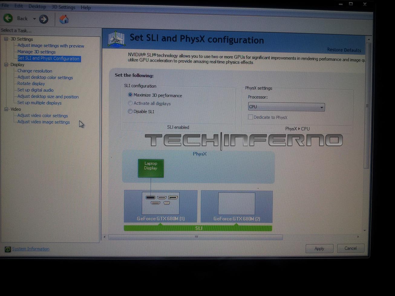

First off, thanks to @svl7 for letting me abuse his 680M in SLI config. It provided us with a lot of useful data and some of it is good news but the majority is not so good.

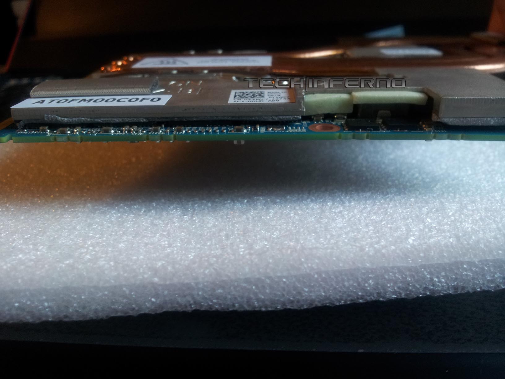

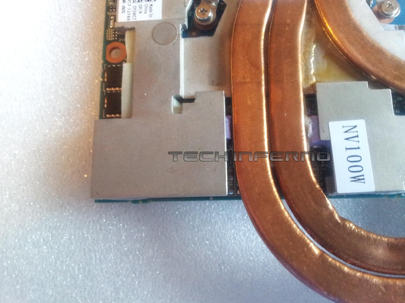

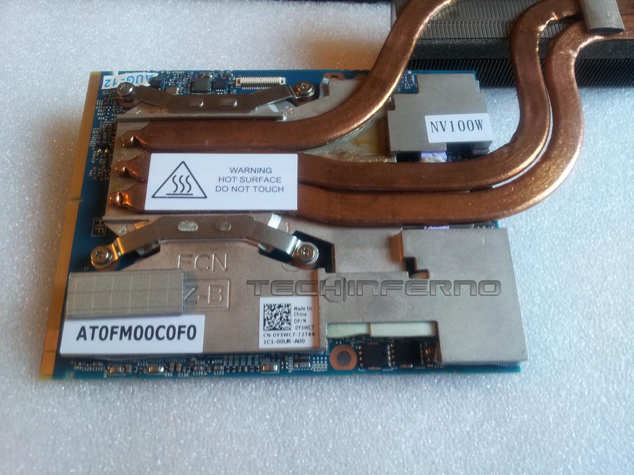

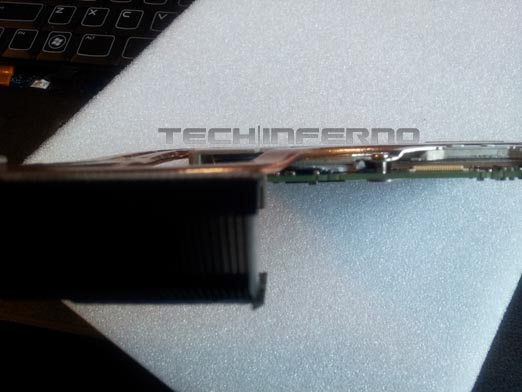

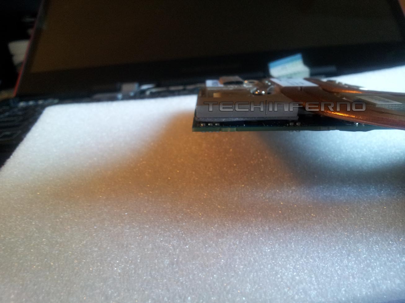

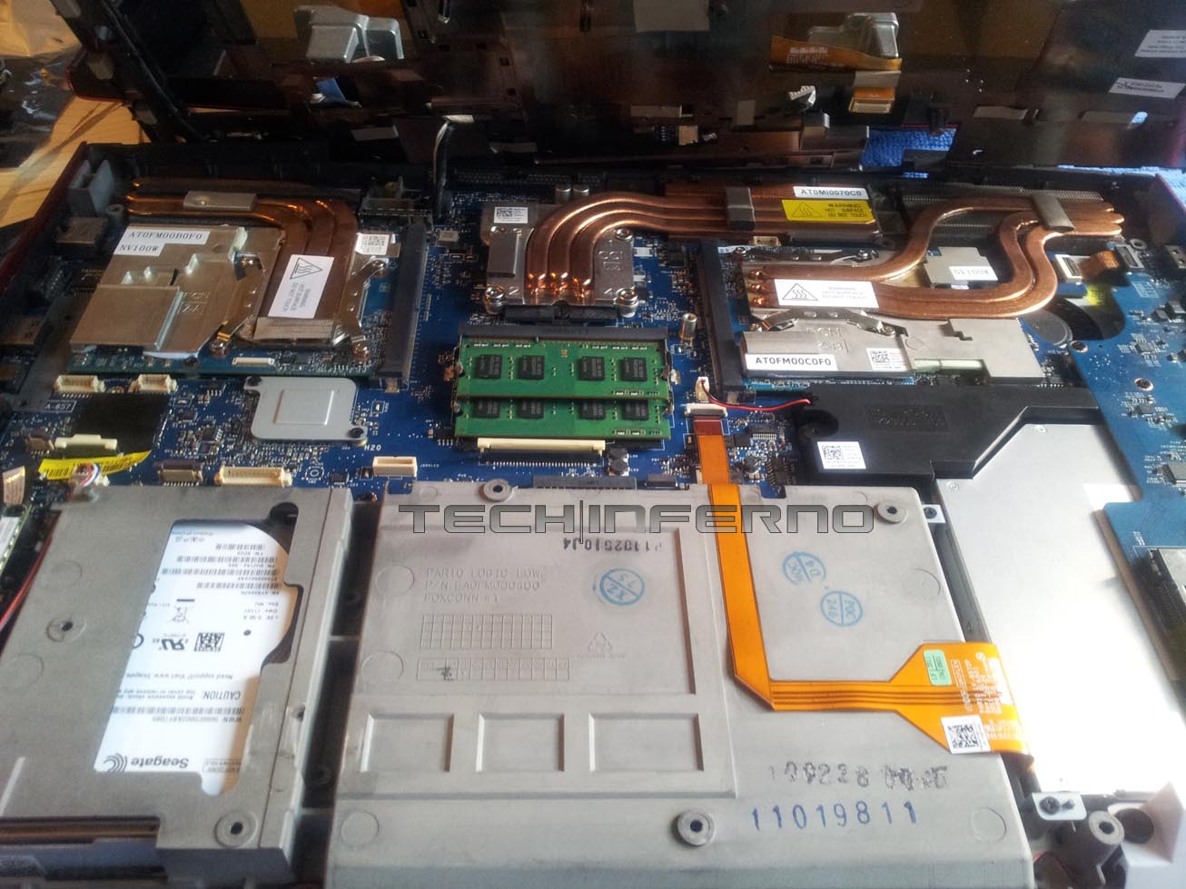

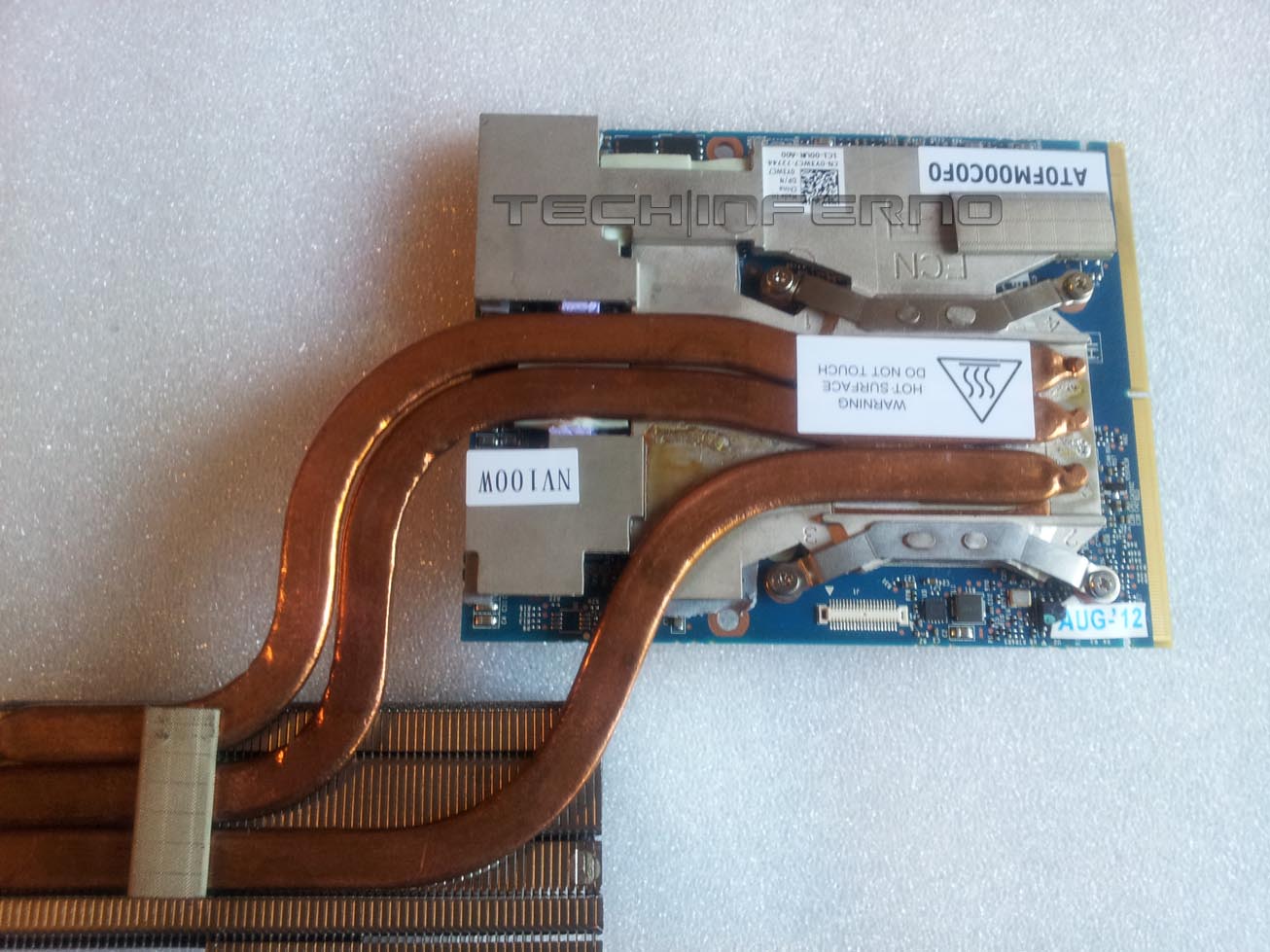

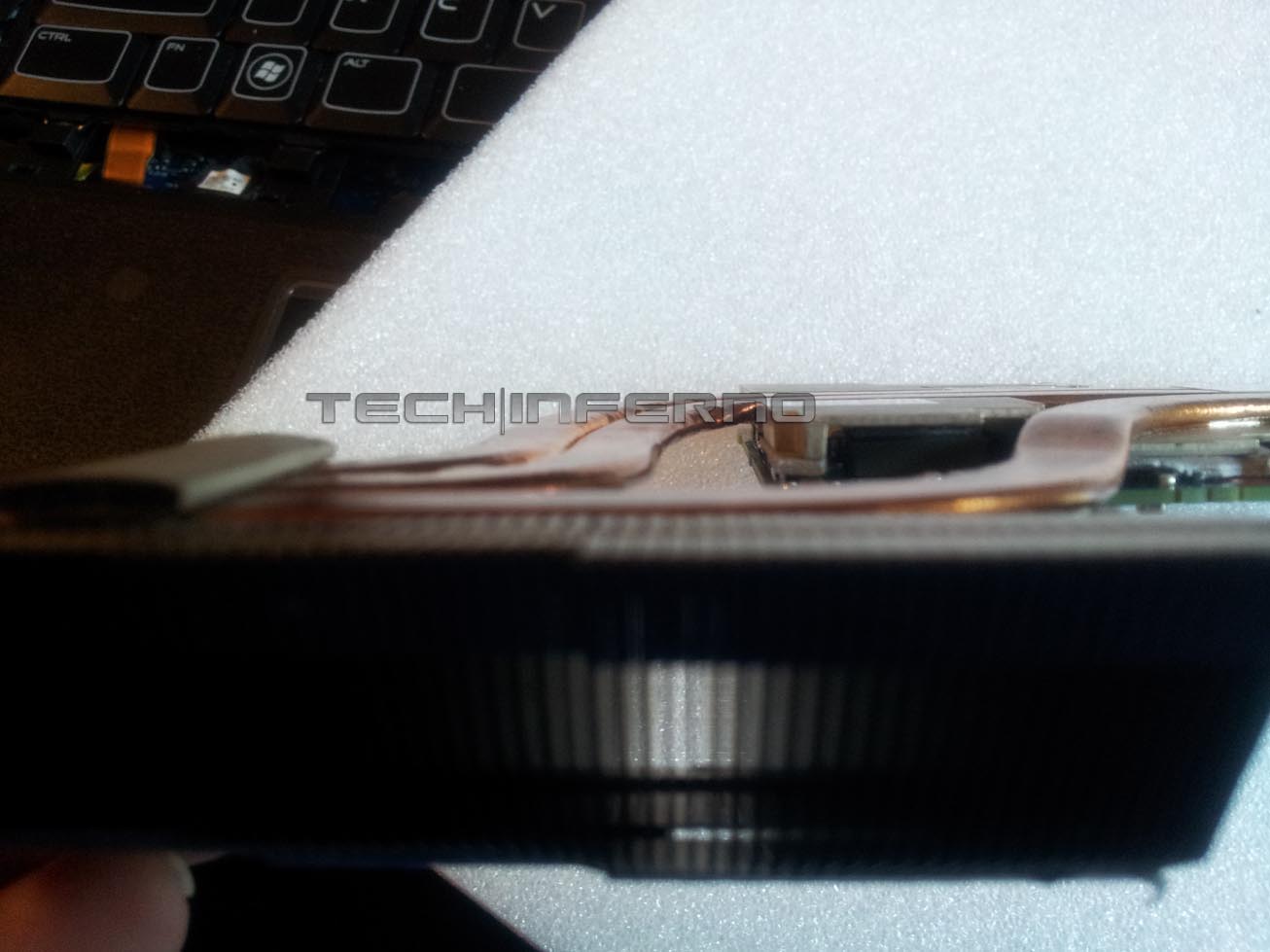

Before I get into the 680M SLI discussion, I'll begin with some upgrade photos of the GPU in the M18x-R1:

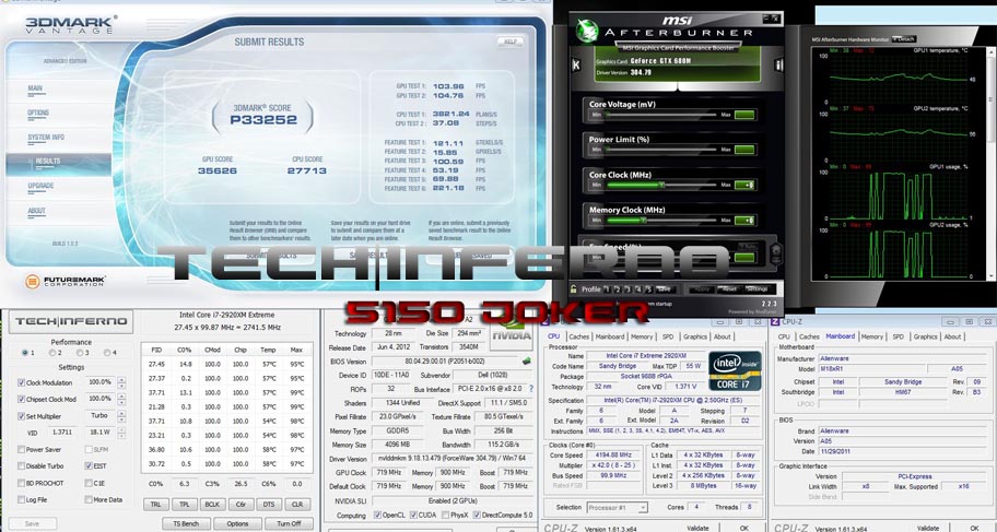

The Vantage score above is with the default settings, no overclocking except for the CPU. There are also some 3DMark 11 runs I did, you can find them as follows:
1. Default settings, no GPU OC: NVIDIA GeForce GTX 680M video card benchmark result - Intel Core i7-2920XM Processor,Alienware M18xR1 score: P10235 3DMarks
2. Mild OC (no overvolt) on GPU: NVIDIA GeForce GTX 680M video card benchmark result - Intel Core i7-2920XM Processor,Alienware M18xR1 score: P11560 3DMarks
So as you can see based on the GPU performance scores, the 680M in SLI has a HUGE amount of potential. I want to emphasize potential because like I said earlier, there's some bad news.

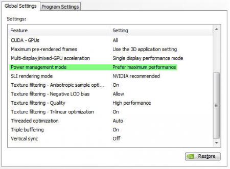

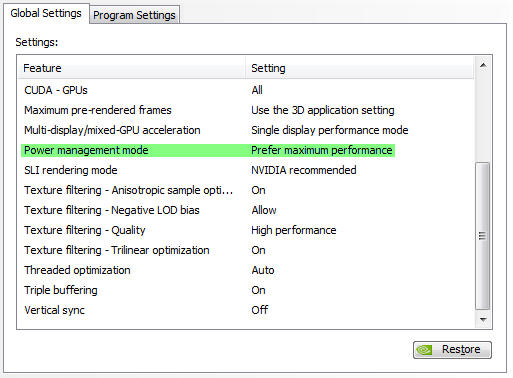

There was a post at NBR that someone stopped throttling with Dell 680M SLI by switching the NVDIA Control Panel power management mode. Not sure if this is truly a fix or not, but simple enough to test and find out.
  • Founder
[ATTACH=CONFIG]4922[/ATTACH]
Dunno about Dell cards but definitely not true for Clevo cards.
Sent from my GT-N7000
Have you tried changing this in the driver global profile using NVIDIA Inspector instead of the NV Control Panel? Might not change anything, but couldn't hurt to see what happens.
It did help with my issue if you recall Brian I mentioned on NBR that some games didn't fully utilize the gpu therefore the gpu clock didn't fully increase to what I overclocked to with Nvidia inspector, the power management trick helped with that. As to whether it prevents throttling at clocks higher than 854mhz I am not sure, but it sure helps keep my gpus fully stable at 854/2000 with no downclocking during gaming and 3dmark11.
