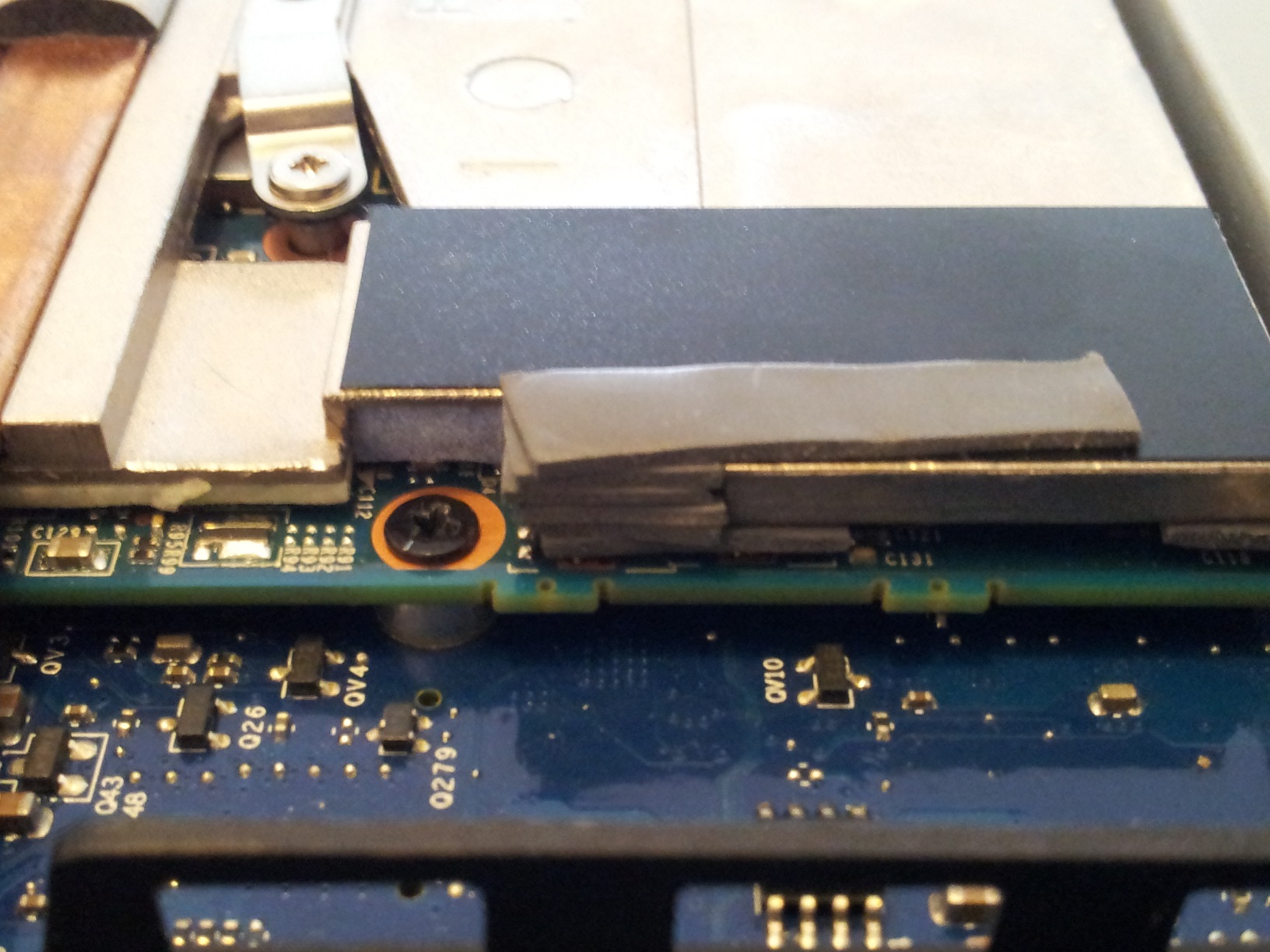

Perhaps, he might be having problems with this one chip that is not covered by these heatsinks. I had to use layers of thermal padding to 'extend' the heatsink to cover one of the chips. It's possible that the 880M places more of a demand on that chip than say my overclocked 670MX, and considering he probably hasn't even covered that chip at all, then this might be causing issues. Here's the pic of the thermal pads I layered up to cover the 'problem chip' (layout of 880M is the same), I have the same heatsink as him (560M):
(I hadn't remembered to consider this as a possible reason for his throttling problems when I recommended he buy the 100W heatsink) @Kedawg, see if you can cover that chip that's in my photo - that might help your issue.

I just tried to cover that chip as best I could, and that was the only way I could work out. I was wanting to fix a strip of metal across it but the clearance between the heatsink and that chip is less than 1mm, so there wasn't enough room to use metal strips & thermal pads, just had to stick with the thermal pads. If you can think of a better way to do it, then do that by all means, because my job is a bit of a botch job, but it does seem to take some heat away from that chip because the top of the thermal pad stack does get hot to the touch during use, so it is drawing heat away from that chip. (I've been running it like that with a heavy overclock for nearly 2 yrs now - no sign of failing card or instability)

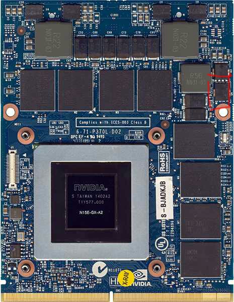

So the red square is the cip that is not covered by the heatsink. It's one and a half cip that is free. The sec picture is the gtx 560m that i upgraded from. I found unde the 560m a thermat pad large one that it was pasted on the mother bord. Should i keep it pasted there or should i remove it?
I am asking this cause i did not this in the thermal pad in any video tutorial of upgrading on the web

I think you should leave the big thermal pad on the motherboard, it's there to cover the VRAM on the bottom of the card - check that it's positioned to contact the VRAM chips ok, should be - I left it there when I upgraded to 670MX.
Yes, that's correct the chip you circled in red is the problem chip, you can see from my pic I showed you yesterday how I covered that chip. You could try something similar to what I did before buying a new heatsink. If you do decide to get a new heatsink try to get a Dell M17xR4 heatsink that's been used on a 680M, because it's more likely that the red circled chip will be covered - same layout between 880M and 680M.
