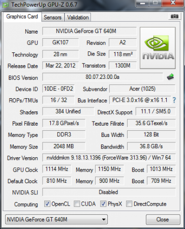

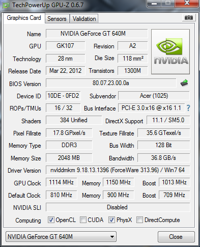

Acer Aspire V3-5xx series - BIOS mods for higher Nvidia GT640m clocks
