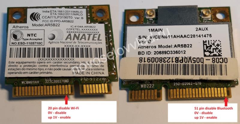

raisig 0 Posted March 14, 2021 Hi Folks, I decided to change my orginal wifi card with new one on my MSI GX740. So i bough new with intel AC7265 chip. I put and wifi work properly without any problem but the bluetooth of card computer don't find. My question is this problem it's coming from bios or hardware or from both. Quote Share this post Link to post Share on other sites
Klem 793 Posted March 14, 2021 (edited) 16 minutes ago, raisig said: Hi Folks, I decided to change my orginal wifi card with new one on my MSI GX740. So i bough new with intel AC7265 chip. I put and wifi work properly without any problem but the bluetooth of card computer don't find. My question is this problem it's coming from bios or hardware or from both. Hi! Try to isolate pin 20 and pin 51 on your new Wi-Fi card. Edited March 14, 2021 by Klem Quote Share this post Link to post Share on other sites
raisig 0 Posted March 16, 2021 Thank you very much Klem for you replay. So I steady very stick my problem and at end i think that maybe on because old wifi card don't used a usb pin, MSI don't a put wire to this pci-e connector. On new card pin 51 too not used, and on other computer i try and he find a Bluetooth correctly. So that is reason to start to thinking in this direction. To day i will try to remove a chip set and to check a wire is that is true or not. So i will keep in touch about next my reasurshing. Quote Share this post Link to post Share on other sites
raisig 0 Posted March 19, 2021 Hi Folks, finally i found a problem and fix it. So I want to share my experiеnce if some one take a decision to change him wi-fi card. How i can suggesting in last post MSI don't put a wire for USB connection on pci-e. I soldered a new wire from pin 38(USBD+) and 36(USBD-) on pci-e to a pin of my old bluetooth card. In conclusion if a wi-fi card which you try, computer don't find with isolated pin 51 (if used to control on/off of bluetooth) you must to be sure that USB pin not has a connection. So i wish a success to every one which try it. Quote Share this post Link to post Share on other sites
