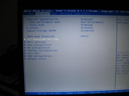

Dakneo Posted September 14, 2012 Share Posted September 14, 2012 Hi Xonar, Odd. There's no Chipset option under Advanced and I checked all the sub menu's listed. This is BIOS .10F from 05/27/2011 Quote Link to comment Share on other sites More sharing options...
Xonar Posted September 15, 2012 Author Share Posted September 15, 2012 @DakneoThanks for the screenshot. I've updated the first post with another unlock. I'm not too hopefully that this new one will unlock the chipset tab, but it's worth a shot. I'll keep you posted if I figure something out. Quote Link to comment Share on other sites More sharing options...

jay0r Posted September 16, 2012 Share Posted September 16, 2012 Im a owner of a Medion X7811 i hope im soon able to test your GX740 Bios but first i need permission from some administrator or Mod Edit: I just flashed the bios and alot of new options are available now, but there are no settings for the Chipset Is there a way to enable those too, because i wanted to change my RAM ?! Quote Link to comment Share on other sites More sharing options...
