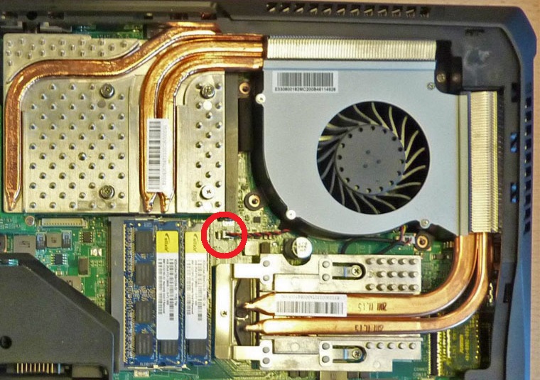

Do a cmos-reset. i had the same problem when i play with my core clock in Intel Xtu ;)
Picture is attached :)
1. Take out the battery and disconect your power cable
2. then open your notebook
3. disconect the cable (have a look at the pic)
4. wait about 5 minutes and press the power botton a few times
5. do all backward
i hope i can help you ! :)
5. do all backward

Hi guy,
I have the gx60 and flash the bios.
Flash ok
Restart ok
Go to the unlock bios ok
I try to put the ram @ 1866
And i restart and.........
...... Nothing on the screen, how to reset the unlock bios?
Thank
hi
have you an idea, i don't have the red black cable on the gx60
tk
ohh sry thats bad.. @dabidbobol after searching a long time i found these two pictures.
i think the cmos in the gx60 is under the keyboard at the right sight above!
the other picture is on this sitehttp://forum.notebookreview.com/msi/692264-offical-msi-gx60-owners-lounge-344.html under jamiet63's post!
I hope i can help you!

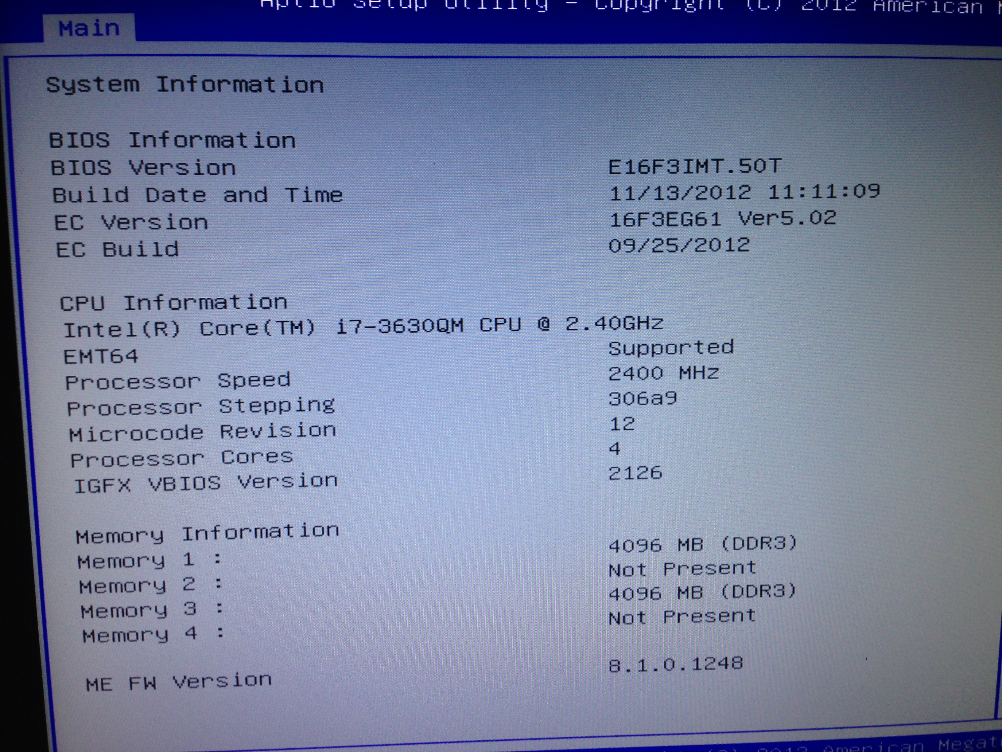

  • Bios Modder
hmmm...maybe because my bios backup tool couldnt identify my bios... do you know some (working) tools to backup the bios?
Yes. Better choice is FPT for DOS. Download it and put to your bootable USB flash drive. Then boot in to real DOS and just type command: fpt -d backup.rom -bios
the other picture is on this site*The Offical MSI GX60 Owners Lounge* - Page 344 under jamiet63's post!

that perfect, i did this one, bios restart, but i must do go back with the bios cause each value i change in unlock bios ====> black screen...
thank you very much.
