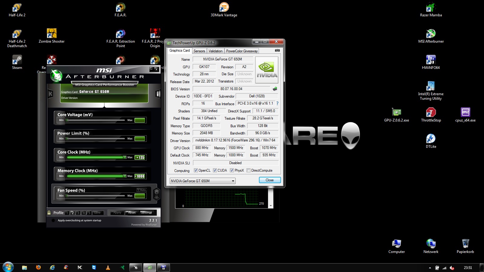

deadbydawn Posted June 25, 2012 Share Posted June 25, 2012 So there's a printscreen of my gpu-z with updated boost clocks while the max overclok in msi AB is added. =) 1 Quote Link to comment Share on other sites More sharing options...

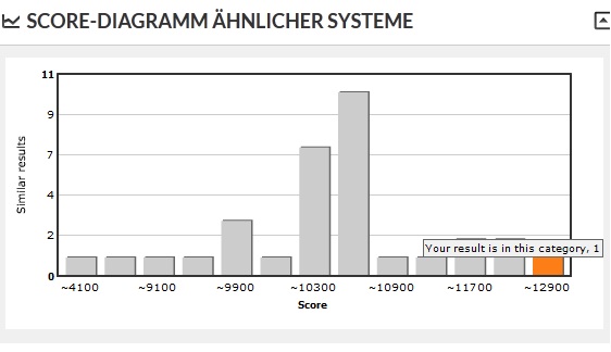

deadbydawn Posted June 25, 2012 Share Posted June 25, 2012 tomorrow i will do a vantage run with full overclock. with the max overclock in msi AB i got 11766 in 3dmark vantage. now wondering what the special boost will add to it. NVIDIA GeForce GT 650M video card benchmark result - Intel Core i7-3720QM Processor,Alienware M14xR2 score: P11766 3DMarks Quote Link to comment Share on other sites More sharing options...

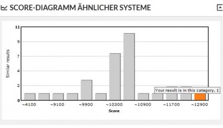

deadbydawn Posted June 26, 2012 Share Posted June 26, 2012 having 11766 in 3dmark vantage. now with your boost i got this: NVIDIA GeForce GT 650M video card benchmark result - Intel Core i7-3720QM Processor,Alienware M14xR2 score: P12855 3DMarks it definately gave me a boost, giving me the highest vantage score ever on my 14x-r2. thanks a lot @svl7 - - - Updated - - - btw: awesome! Quote Link to comment Share on other sites More sharing options...
deadbydawn Posted June 26, 2012 Share Posted June 26, 2012 of course, i meant MY highest vantage score ever on MY m14x-r2 ;-) Quote Link to comment Share on other sites More sharing options...
