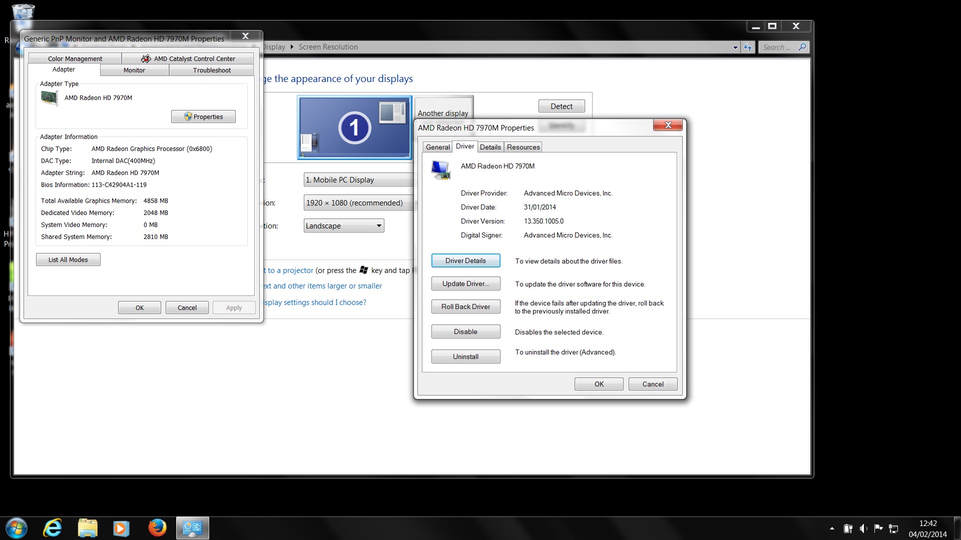

[ATTACH]10792[/ATTACH]
As it turns out, the limitations of this board for new users are hampering me more than helping :/
I cannot view that screenshot, but I suspect it looks fine - this would point me towards a display fault post install of the new card.
Thanks for the help and frustration for 24 hours :ghost:
