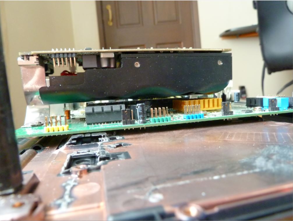

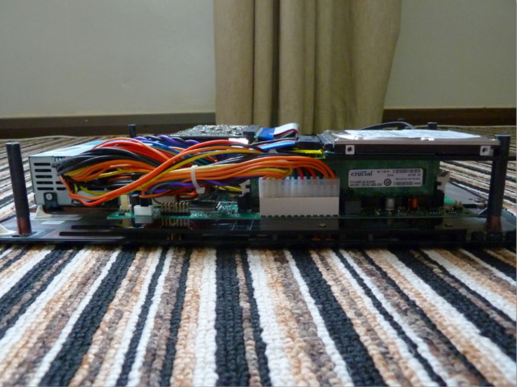

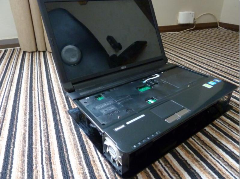

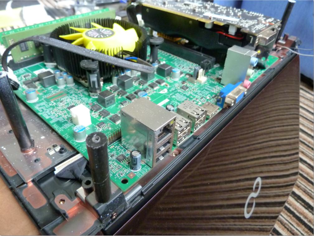

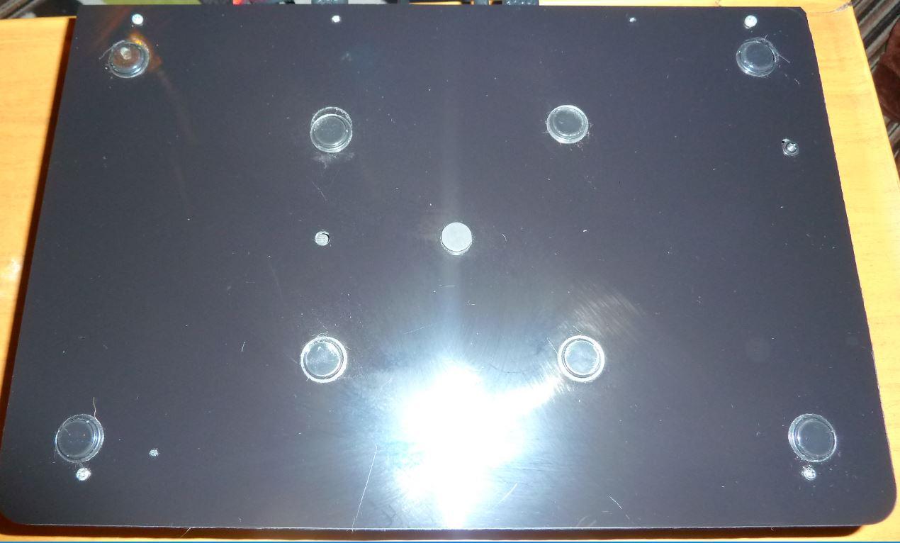

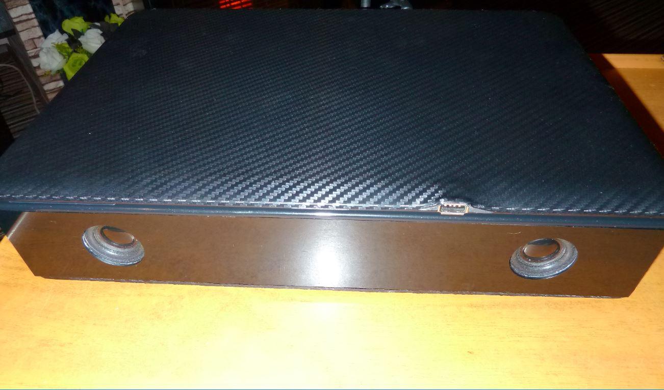

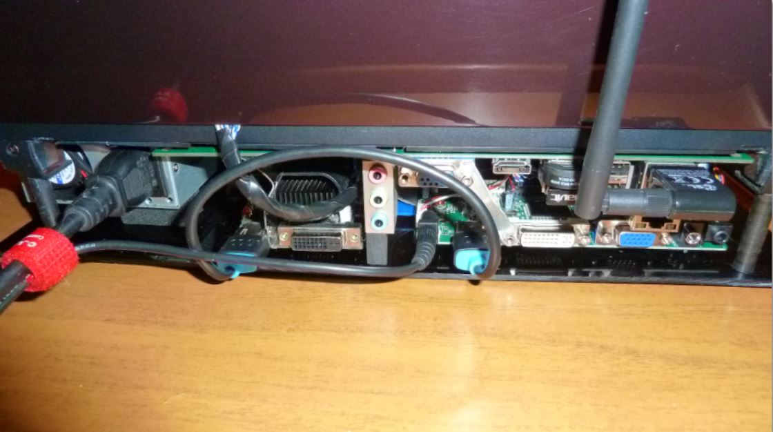

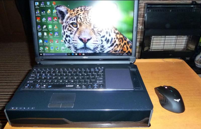

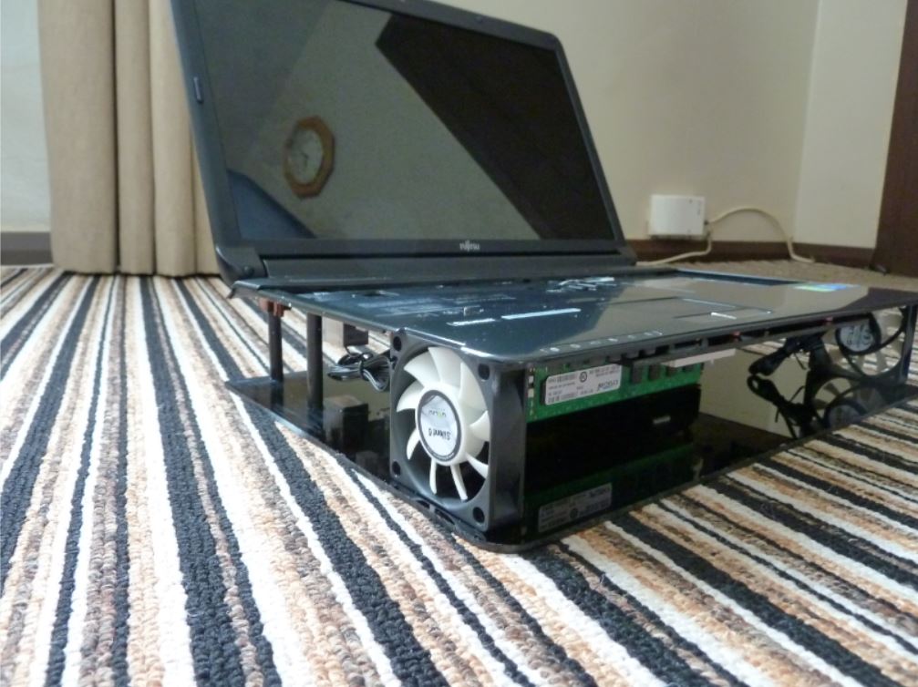

Having pondered over a eGPU build I instead decided to put my GPU inside my 15.6 laptop by extending the laptop base. I have a Dell optiplex 390 where my GTX 750ti LP once lived but as I now spend more time with my laptop on the sofa the Dell optiplex is now a donor for my gaming laptop build. I'm using the Dell motherboard for this build. It has a i5-2400 CPU - 8GB DDR3 RAM - MSI GTX 750ti LP GPU. The Dell PSU is too big for this build so I will be using a Seasonic SS-250SU 250W PSU. The laptop used for this build is a Fujitsu LifeBook AH530 that has a 1366x768 LED screen, this screen will be replaced with a higher resolution 1600x900 screen. The extended base of the laptop is now 6.5 cm.

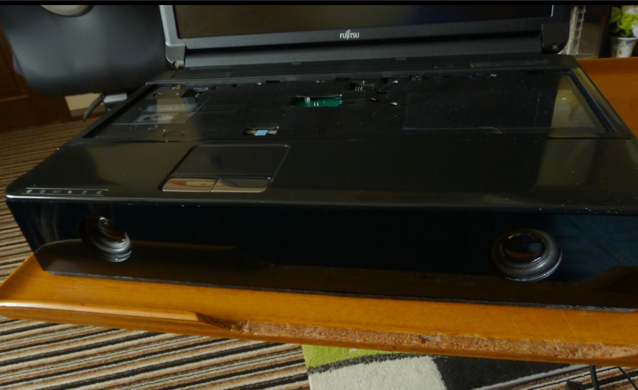

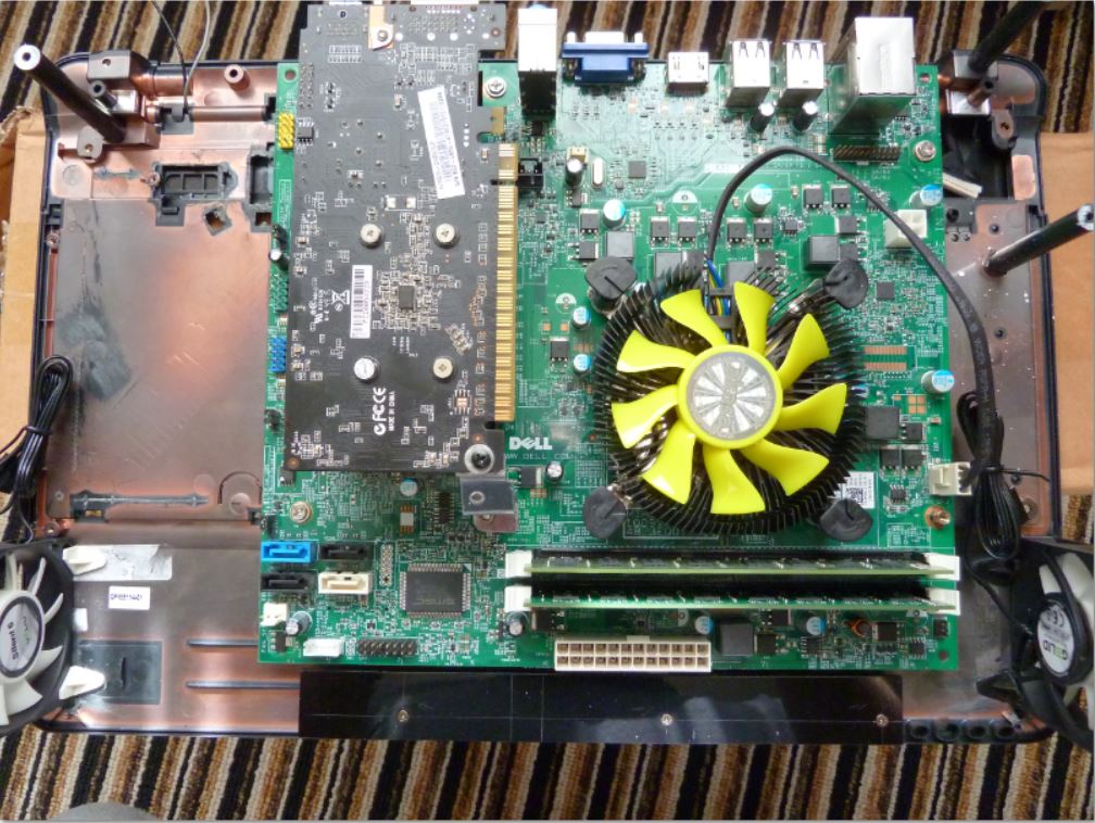

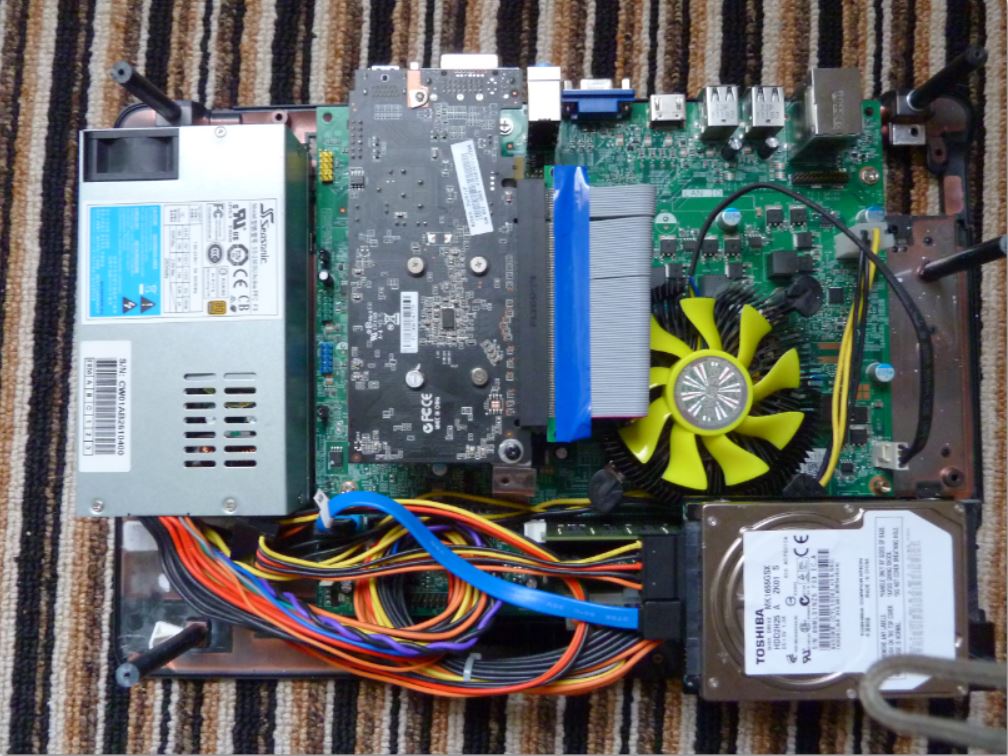

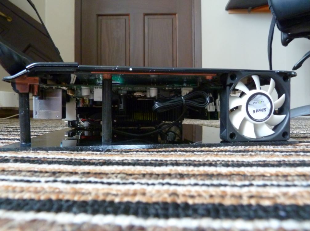

Work so far in pictures:

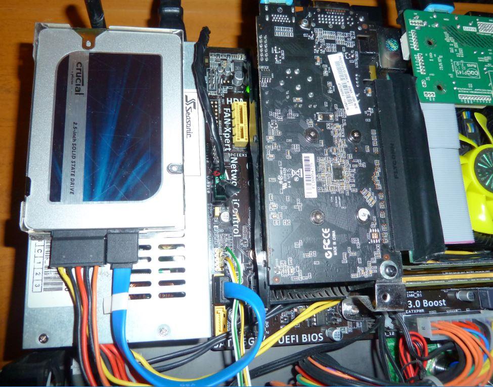

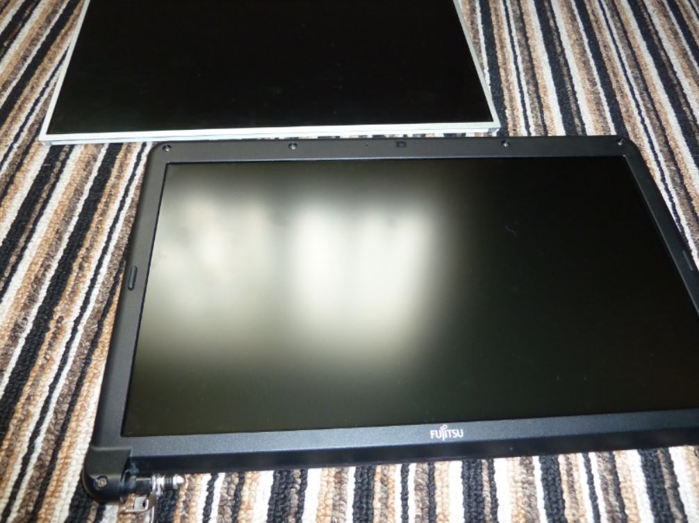

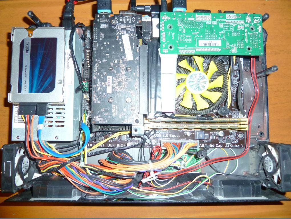

Everything is going great so far. I have the new SFF PSU mounted and I also made a bracket to mount the Hard Drive. I've got the pci-e extender cable connected to the GPU. I booted the system up with an external monitor and played 'The Crew' with medium to high settings getting around 50 fps. The laptop screen has been replaced with a 1600x900 (Matte) screen but I'm waiting for the LCD controller board to arrive from China before I can connect it.
In the meantime I'm making the plastic paneling to go around front and sides.

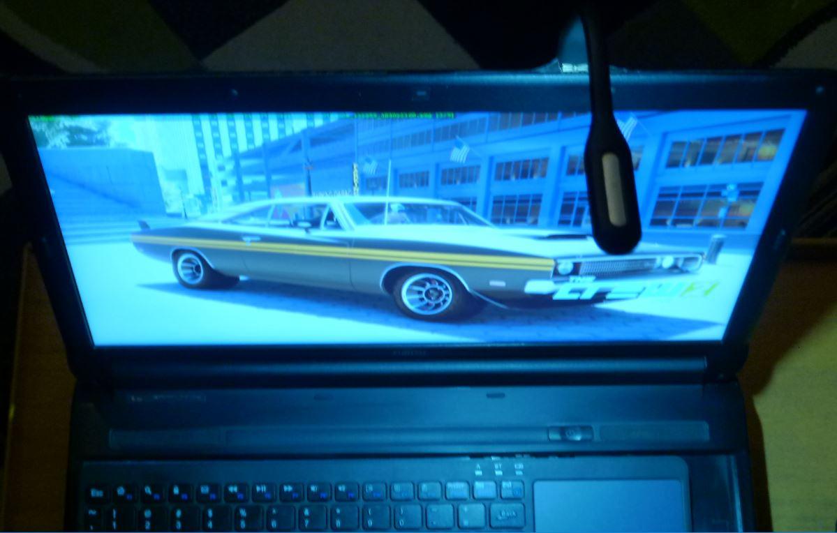

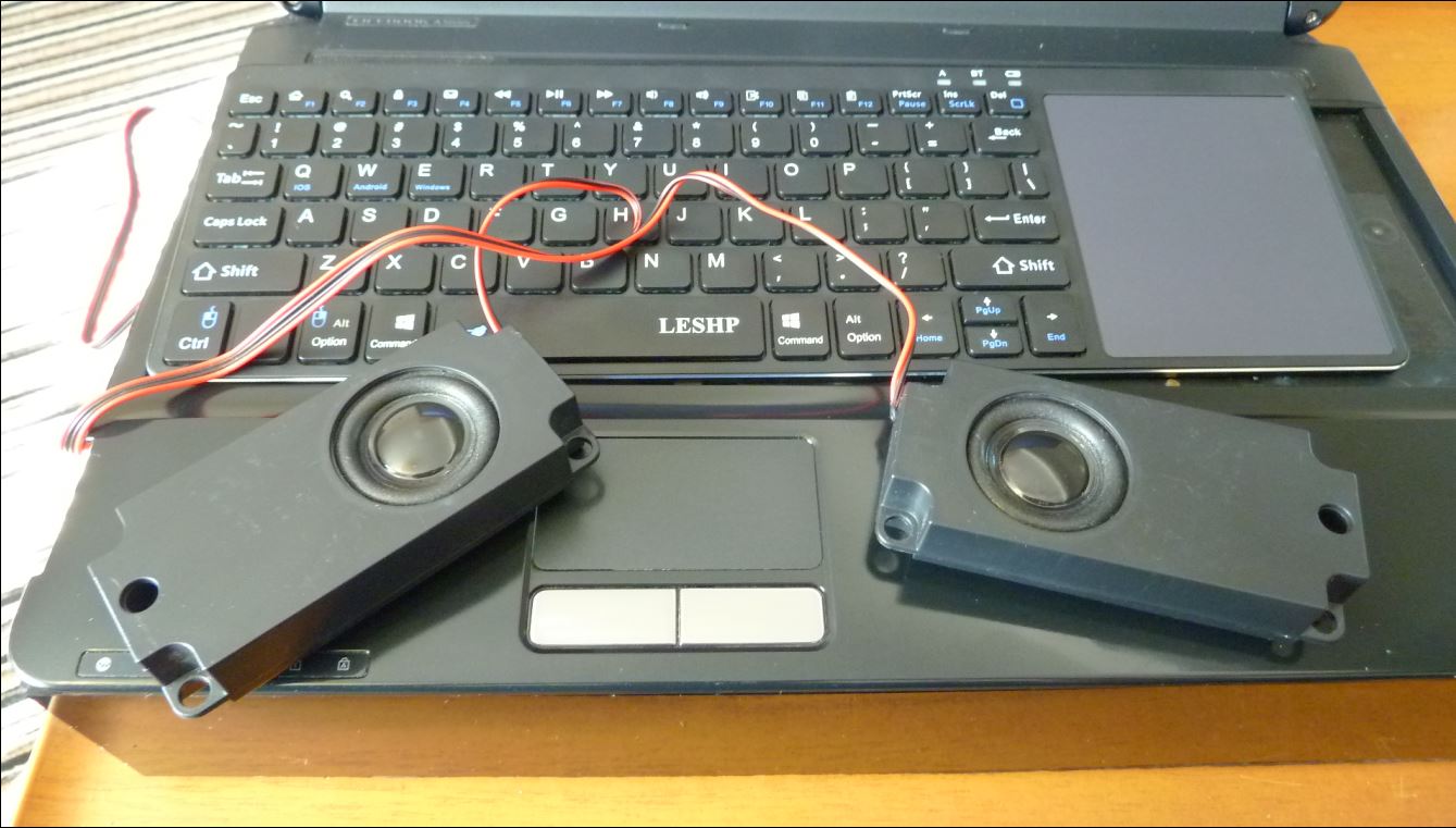

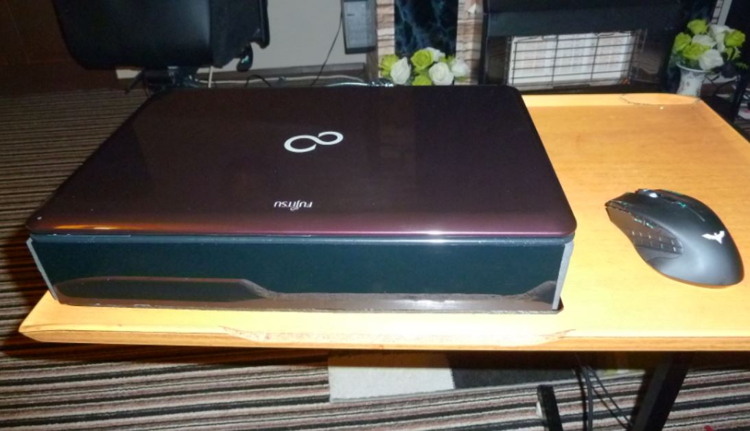

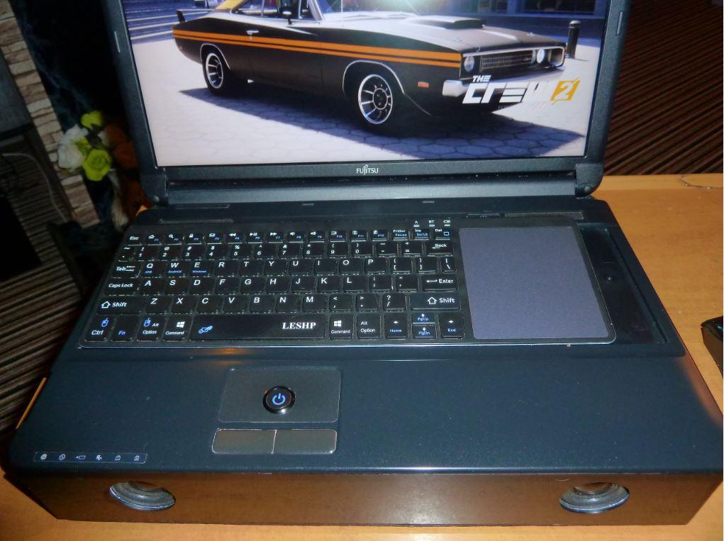

Received the LCD controller board from China and installed it in the laptop. Good quality board, no setup needed simple plug and play. Image quality looks fantastic, also no lag. Using a short HDMI cable to connect it to the GPU. I'm using a 12v 2amp power adapter to power the board but I plan to power it from the PSU in the laptop. The LCD board has a 4-pin speaker output so I ordered some 5w loud speakers to fit on the front panel. I still have the side panels to fit. Anyway, I've been gaming on it, surfing the net, streaming videos, etc. All good!

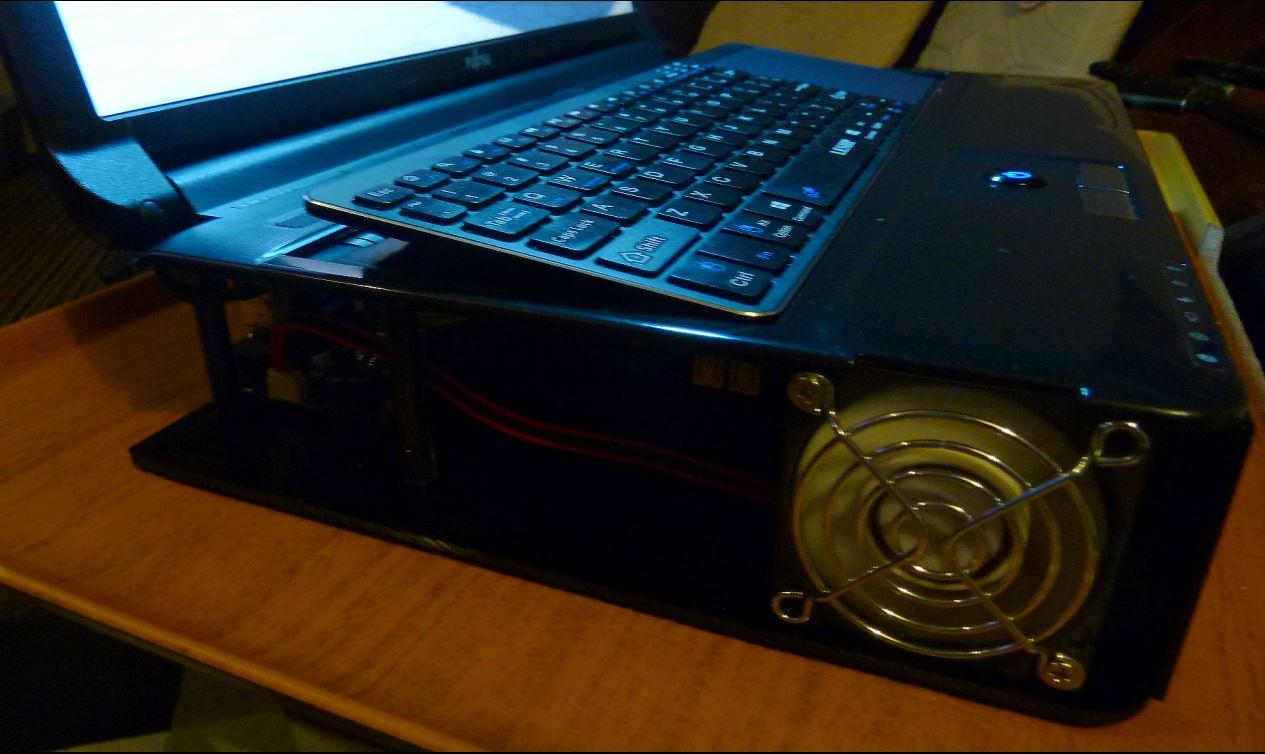

The base is 6.5cm and total laptop thickness with lid is 7.5cm - Weight is 3.6kg compared to my old Dell D630 laptop that is 2.3kg. Those old Eurocom portable servers would be great to mod into a gaming laptop.

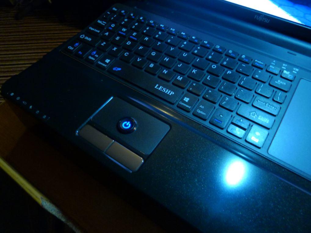

I changed the Dell Optiplex 390 Motherboard for a ASUS H81M-PLUS Motherboard with a i5-4460S. Also replaced the disk drive with a Crucial MX500. Added a power button on the redundant trackpad. Added a USB port to the laptop lid so I can attach a USB lamp. That pretty much completes the build.
6 hours ago, pinkyfloo said:
Just to clear to my mind (PLEASE!!!) you're running the laptop screen powered by the desktop i5? or did you connect the GPU into the Laptop PCI-E interface?

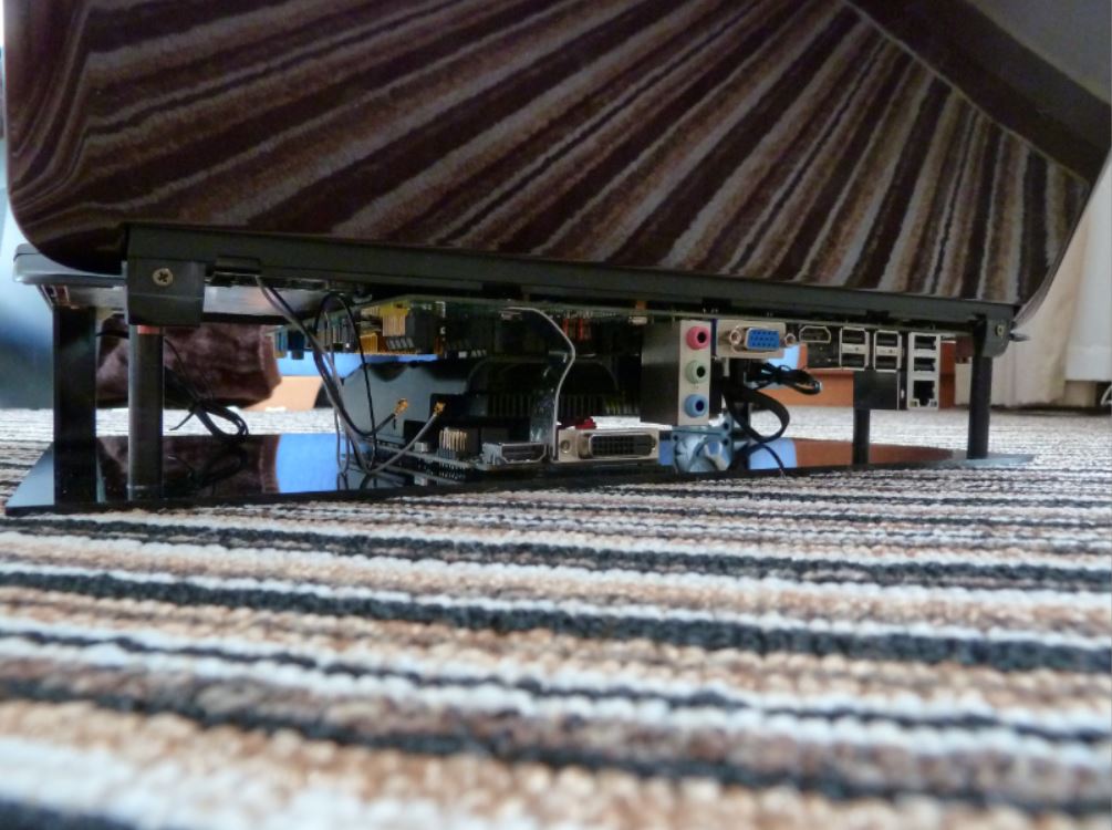

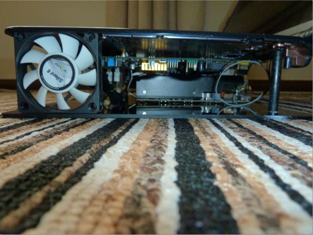

The laptop screen is connected to the LCD Controller Board that is powered by a 12V DC adapter. The LCD Controller Board provides power to the laptop screen. The HDMI cable connects the GPU to the LCD Controller Board. The GPU is connected to the motherboard's PCI-E socket using a PCI-E extension cable.
