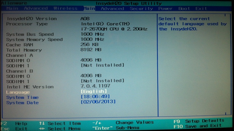

2GStyle Posted July 10, 2012 Share Posted July 10, 2012 Here are the steps for recovering the current M14x BIOS:Did you follow these steps? If not, try again. If it still doesn't work and you're out of warranty I still might be able to help you, but it'd require a hard flash or replacing the BIOS chip.Edit: I attached the recovery file for flashing the unlocked A08 BIOS, just unpack it and copy it to the root of your USB drive.I don't think I can thank you enough for this. I messed my bios playing around and thought I was done for. THANK YOU THANK YOU THANK YOU. 1 Quote Link to comment Share on other sites More sharing options...
svl7 Posted July 10, 2012 Share Posted July 10, 2012 Hehehe, you're welcome, cheers! Quote Link to comment Share on other sites More sharing options...
Frank Dacian Posted February 7, 2013 Share Posted February 7, 2013 for me it was a life saver..all worked like a charm following svl7's advice...just beautiful...and now have A08 unlocked too...Thanks A Billion!!!!! Quote Link to comment Share on other sites More sharing options...

alienwarebeast Posted April 11, 2013 Share Posted April 11, 2013 Here are the steps for recovering the current M14x BIOS:Did you follow these steps? If not, try again. If it still doesn't work and you're out of warranty I still might be able to help you, but it'd require a hard flash or replacing the BIOS chip.Edit: I attached the recovery file for flashing the unlocked A08 BIOS, just unpack it and copy it to the root of your USB drive.A lifesaver man. I updated my girlfriends m14x r1 and messed with changed some bios settings, and got the blank 5 beep screen. I was scared to death that I just bricked her laptop. I unfortunately, had to download your M14xR1_A08_SATA_fix.zip from some japanese site since I could not download here, but followed your instructions, waited about 1 minute after plugging in the power cord, then it started beeping alot, then rebooted like 3 times and now all is fine. Thanks a million. Quote Link to comment Share on other sites More sharing options...
