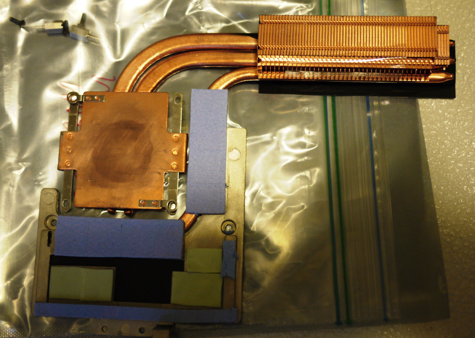

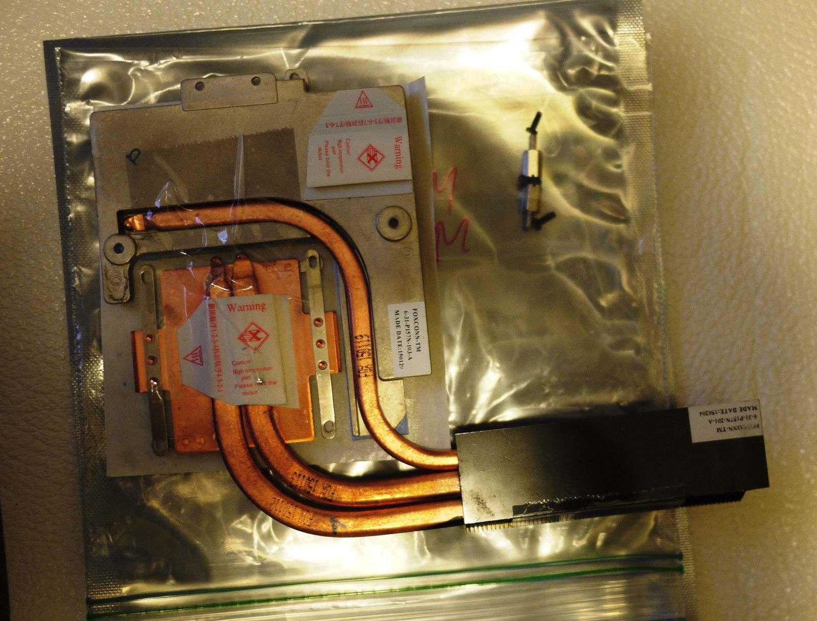

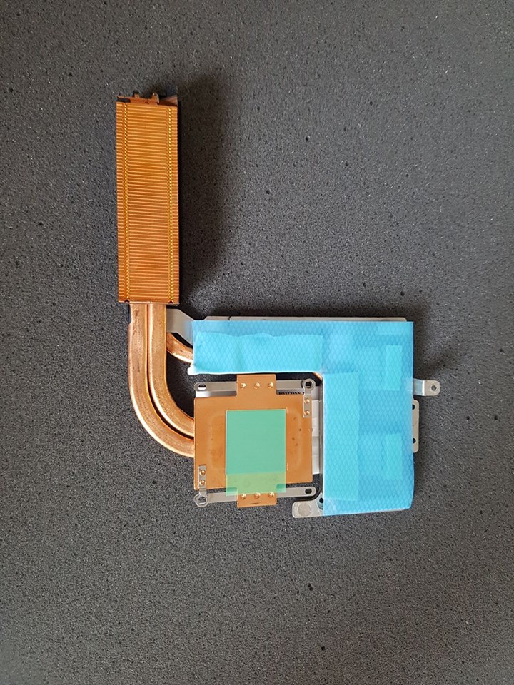

EriannMX Posted May 5, 2017 Share Posted May 5, 2017 (edited) I'm looking to upgrade the heatsink in my p170em as I have the shitty version that first came out. I posted this in NBR but didn't get many replies. Hoping maybe @Khenglish, or anyone, can help. I found the following two heat sinks. Now I don't know which one is "the best"...Option 1 - Supposedly from a 980m that I found on Ebay. I'm afarid because it seems the end part seems to be 2 pieces.Option 2, from a 780m. It's a from a laptop seller in Germany: Thanks for any help Edited May 5, 2017 by EriannMX Quote Link to comment Share on other sites More sharing options...

Khenglish Posted May 5, 2017 Share Posted May 5, 2017 You want option 1 for the 980m heatsink. The 780m heatsink has poor memory cooling. 1 Quote Link to comment Share on other sites More sharing options...
EriannMX Posted May 6, 2017 Author Share Posted May 6, 2017 (edited) 2 hours ago, Khenglish said: You want option 1 for the 980m heatsink. The 780m heatsink has poor memory cooling. Thanks so much @Khenglish! The heatsink would be for a GTX 1060, but I read a post from you saying that this one has "the best" cooling. I should go for it then, right? (Cooler means longer lasting GPU) So it's normal that the end piece is divided? (At least it appears to be from the photos). PS: What do you mean with poor memory cooling? Would this be a relevant problem for the 1060? Edited May 6, 2017 by EriannMX Quote Link to comment Share on other sites More sharing options...

Khenglish Posted May 6, 2017 Share Posted May 6, 2017 (edited) I think the P150SM has the 780m heatink. The P150SM-A would have the 980m heatsink. The 780m heatsink is a single piece with one radiator. The 980m heatsink is two separate heatsinks with two radiators. Edited May 6, 2017 by Khenglish 2 Quote Link to comment Share on other sites More sharing options...
EriannMX Posted May 6, 2017 Author Share Posted May 6, 2017 2 hours ago, Khenglish said: I think the P150SM has the 780m heatink. The P150SM-A would have the 980m heatsink. The 780m heatsink is a single piece with one radiator. The 980m heatsink is two separate heatsinks with two radiators. The original one that came out for the 680m/7970m was also broken into two, yet many people consider it shitty, in part because of the gap between the radiators, and leads to higher temps. What's the difference then? Quote Link to comment Share on other sites More sharing options...
Khenglish Posted May 6, 2017 Share Posted May 6, 2017 The problem with the original heatsink was it came with dual 5mm heatpipes. The 980m heatsink comes with dual 6mm heatpipes. In addition, the core radiator is 4mm thicker on the 98m heatsink vs the 680m heatsink. The extra thickness on the 780m heatsink is mostly wasted because there is no heatpipe going through the back part of the heatsink. The 780m heatsink would probably be fine for you. I don't like it because I always overvolt memory, so I need better memory cooling. The 980m would also blow FETs, which are cooled similarly to memory, so it needed better memory/power supply cooling than the 780m. Most of the heat on the memory heatsink mostly comes from the power supply circuits (power FETs, inductors), not the memory, and the 1060 uses less power than the 780m, and far less than the 980m, so it won't need nearly as much power supply circuit cooling as the 980m. 2 Quote Link to comment Share on other sites More sharing options...
Khenglish Posted May 6, 2017 Share Posted May 6, 2017 Thinking back, the 8970m heatsink is actually the very best. The 980m heatsink is missing part of the radiator over top of the memory/VR heatpipe, while the 8970m heatsink is not. 1 Quote Link to comment Share on other sites More sharing options...
