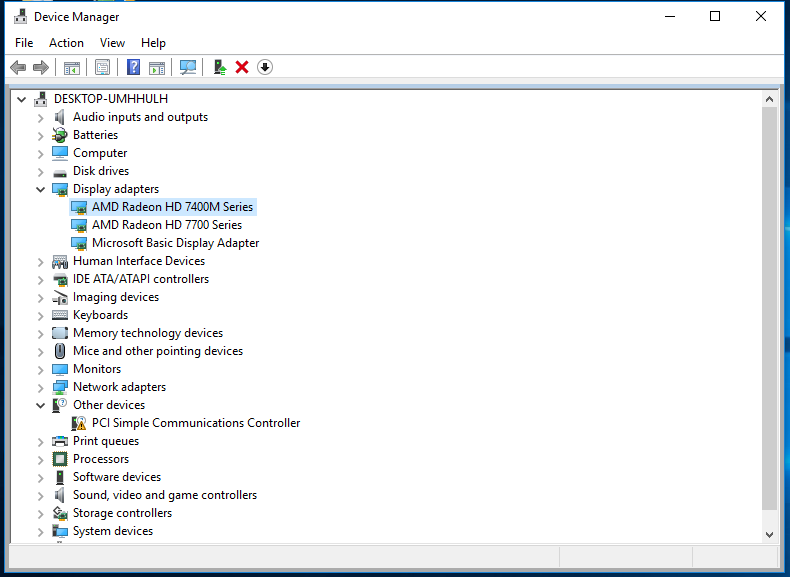

Specs :-  Intel i5-2410m 2.3 GHz
               8 GB ram
               Intel hd 3000 (igpu)
               AMD hd 6470m (dgpu)
               Win 10
# Use the mpcie slot for egpu
GPU powers on and Epu setup 1.x recognized the graphics card.
Disabled the dgpu using setup 1.x.
Installed latest crimson drivers
In device manager gpu shows with error 43. Disabled the egpu from device manager and re-enabled it again. Then it showed normally.
BUT THE PROBLEM IS I CANT CONNECT IT INTO A EXTERNAL DISPLAY. i USED THE DVI-SINGLE LINK PORT AND THE HDMI PORT BUT MY MONITOR DOESNT PICK UP THE SIGNAL.
Help required !!!!
01. First look at the Device manager.

-What egpu u have?
Your system looks similar as mine.
-First start DDU in safe mode and remove ALL drivers.
-Reboot to setup 1x
-Do ignore dgpu and run compation egpu+igp
-Disable dgpu and add it with F3 to startup
-Test run
-Install drivers for your egpu, restart
-Run egpu with startup.but
-It should work

i have a XFX R7770 (egpu)

Now i dont get Error 43, But my dgpu hasn't been disabled
Also i cant connect to  a monitor using either its SINGLE LINK DVI PORT or HDMI PORT ( i use HDMI to VGA)
