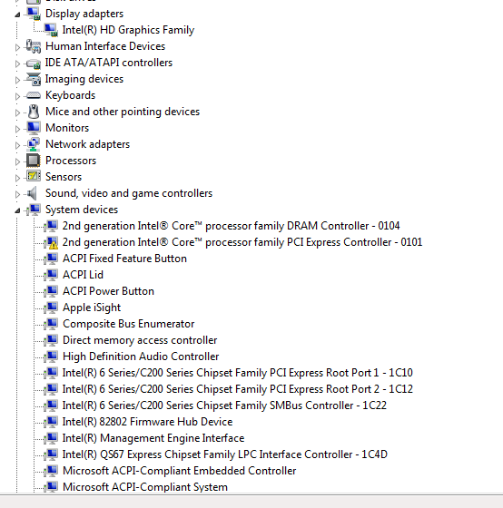

ncliam Posted October 3, 2014 Share Posted October 3, 2014 Now I can generate pci.bat from USB stick installation of Setup 1.30. But Nvidia GT 740 has gone in Device Manager, and a few PCI Express Controllers occur instead. I think USB stick did not detect eGPU. Link to comment Share on other sites More sharing options...
