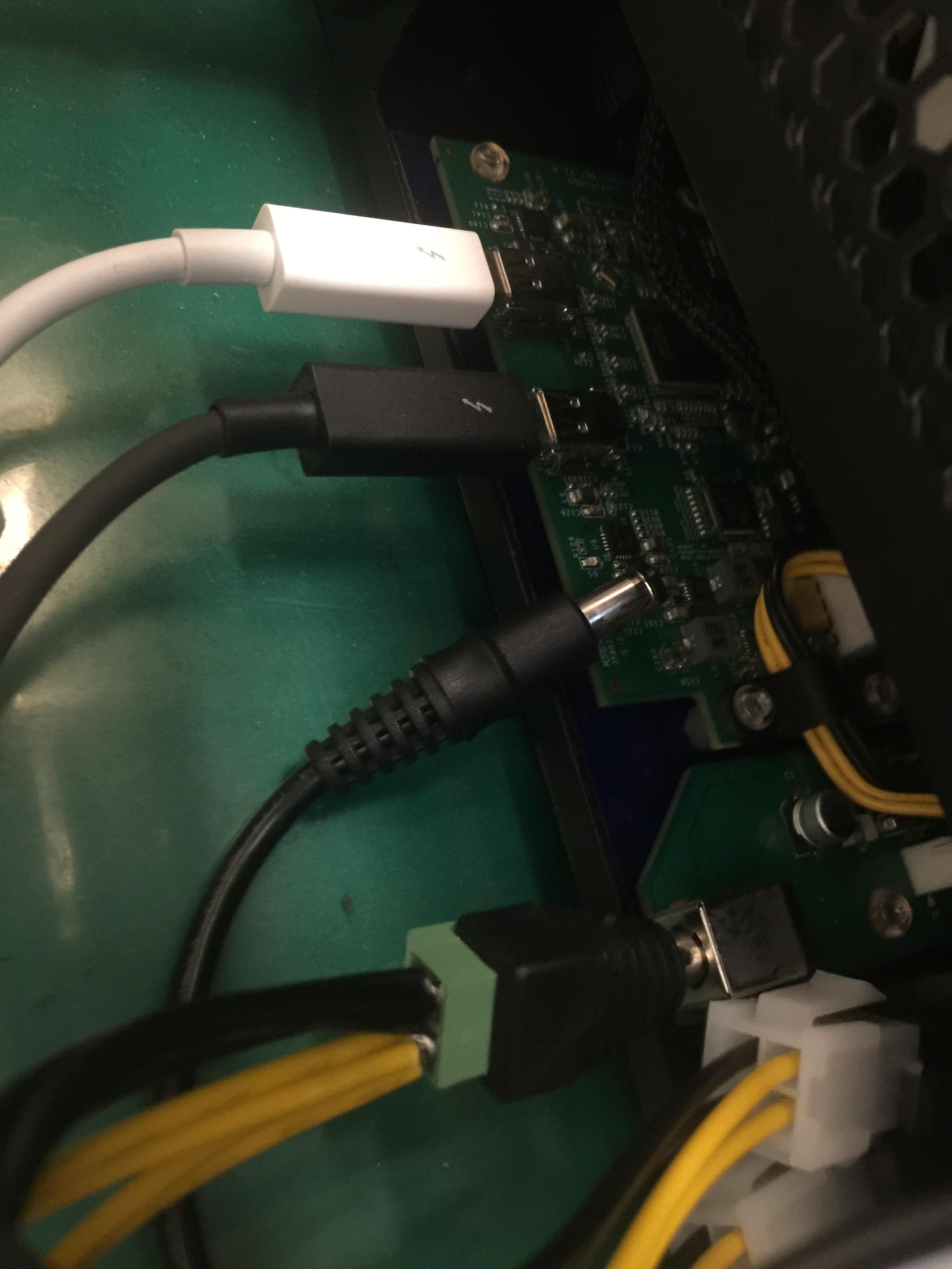

Please let me know how did you handle 8pin to barrel plus modification, it would be better if you share some photos :) thanks in advance.
On 2016年8月9日 at 6:55 AM, Stan VE said:
8pin cpu connector is 4positive ussually yellow and 4 negative ussually black!  Just connect positive to center pin on any 5.5x2.5 barel connector ...
Will make photos today..
I've got no luck and failed :(

I have GTX Titan with my 2012 mid MacBook Pro retina. And the card has 6pin and 8pin connectors. I've got two thunderbolt cables connected was because one connected to my MacBook Pro and another one connected to the Ethernet adaptor. I'm not sure if the adaptor can be the problem or not, but it doesn't seems like a power-consuming stuff.
