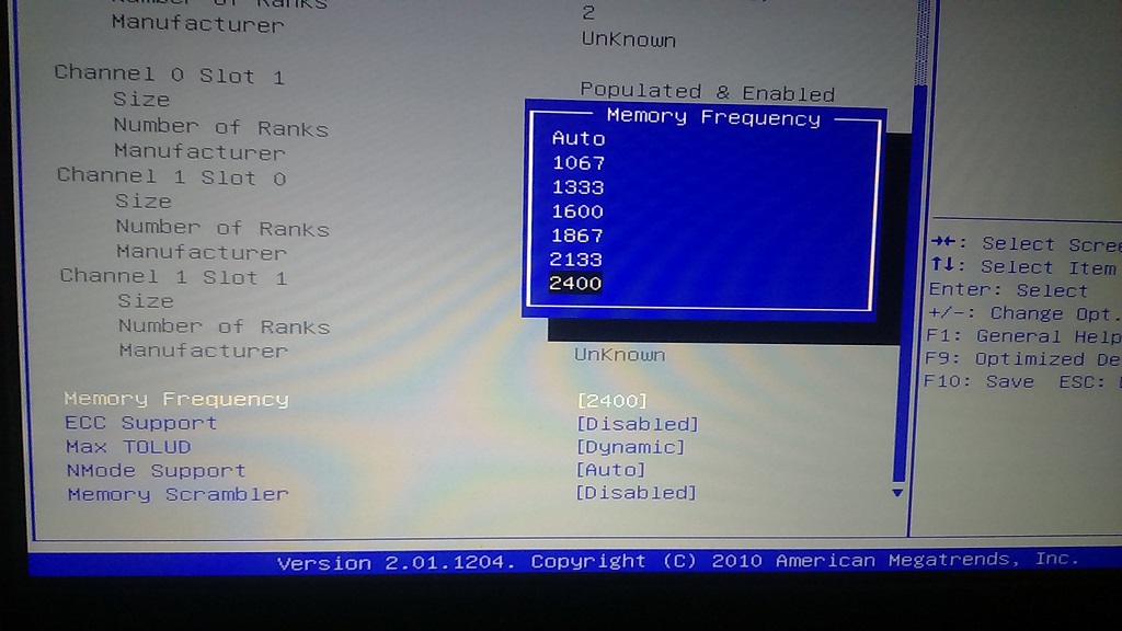

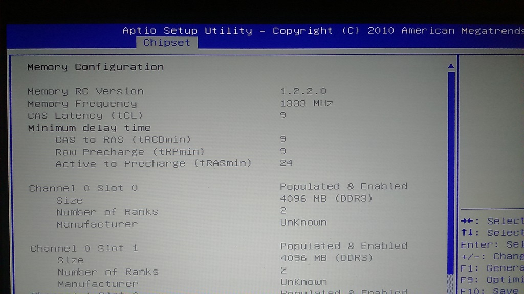

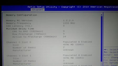

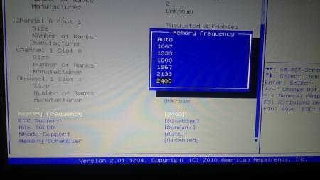

Its indeed a limited BIOS, even with access to all the menus there isn't much to tweak. Tried to change the NMode and had already disabled the ECC support, sadly, no change, in this case only with a CPU that officially supports the 1600Mhz, but its was just a curiosity, I'm no going to invest 100-150€ in a CPU just for the RAM. Thanks for your time. -

Good evening, I have a quick doubt, is there any way to put the RAM running at 1600(800)Mhz, by the Intel page, the maximum is 1333Mhz, but I have seen some cpu-z prints showing this CPU with 1600Mhz RAM, this is not a limitation of my RAM modules, the all suport this: I have already unlocked my BIOS, updated the ME Firmware, inserted the latest microcode update. The laptop is an old old N53SM with an HM65 chipset. This is more of a curiosity/want to try it. Maybe I need to dump my MEFirmware and enable overclocking or tweak something and reflash it? EDIT: Photos of the RAM configuration in BIOS, no mather what value I choose over 1333Mhz it doesn't do anything. Maybe that Memory RC: 1.2.2 as something to do about this, but I can't find any info about that, if its a hardware, or software module. Going by this: https://en.wikipedia.org/wiki/Memory_Reference_Code It might in fact be a limitation/imposed limitation of my BIOS. Best regards

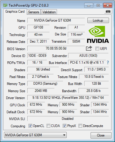

Its the 40nm version, what I find strange is that GPU-Z reports 16 ROP's and 16 TMU's while their site says that the GT630M only has 4 ROP's. I think I can now attach images: What is the 144 shadders version, by version I mean codename to search for images of the chip to check the footprint. I know, but the whole Fermi/Kepler thing just didn't ring a bell until now, damm Asus for gimping their laptops lol. -
