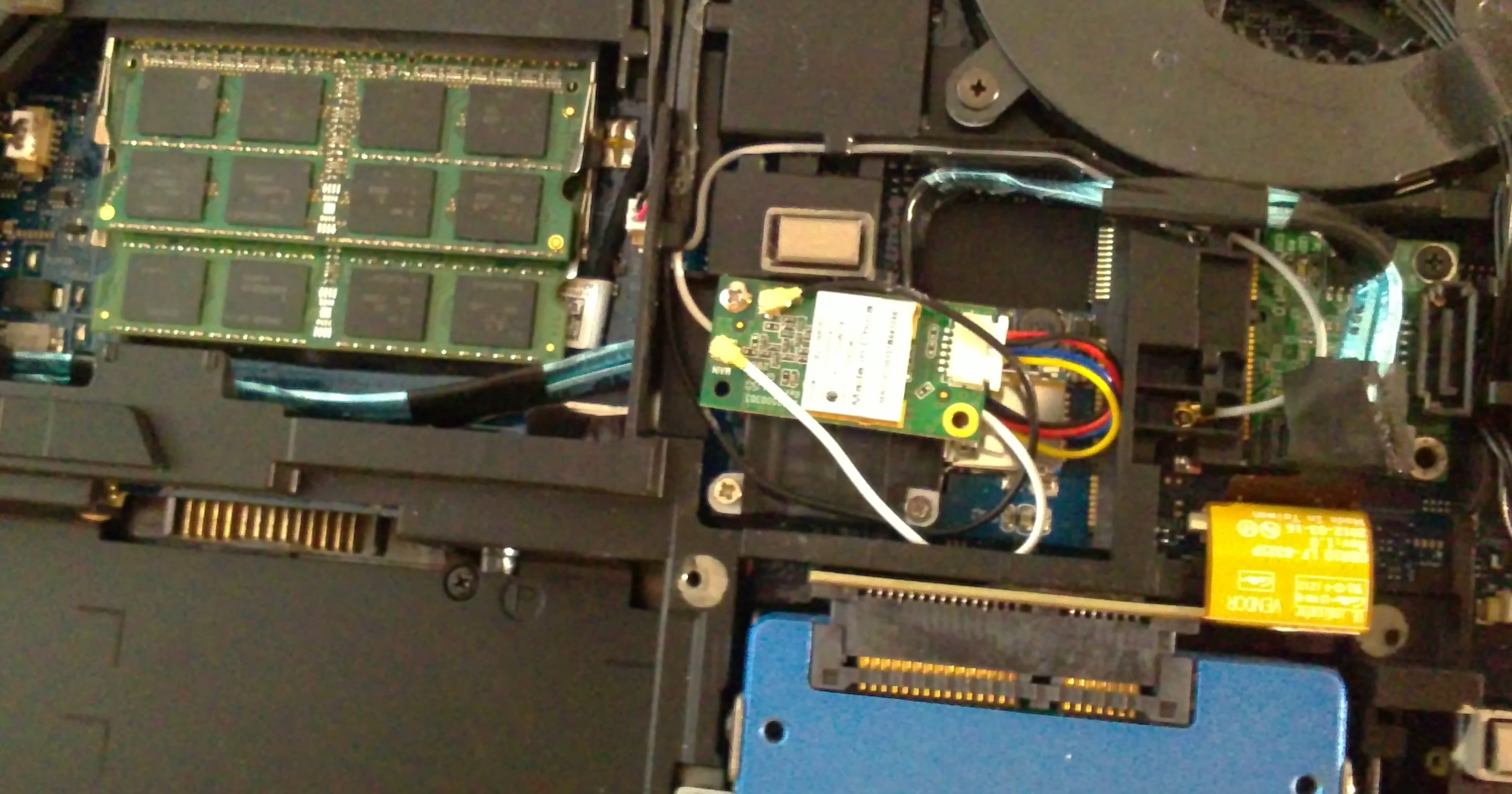

  12. I don't know about m14x cause of the limited space. do you have two mPCIE ports in m14x? if you did then just need to check if they those slots run on USB or mPCIE lanes. the picture you see there is not a raid card its just a gen 2.0 mPCIE to sata card (card act as a bridge) which is why half length msata SSD will not work in that slot. that 90 degree angled sata thin cable goes into optical bay where I have another similar green half length card and that one is a raid card, which can go raid 1,0 and SPAN. no JBOD because no port multiplier on original mPCIE slot. get a couple power splitter it'll be a real tight fit to get all in ODD area. but if it just two HDD it should work out pretty well.
  13. old mod is gone, new one adds 1 more msata and 1 more 2.5 via pcie.

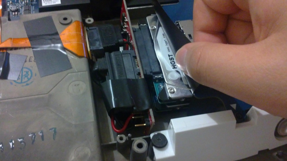

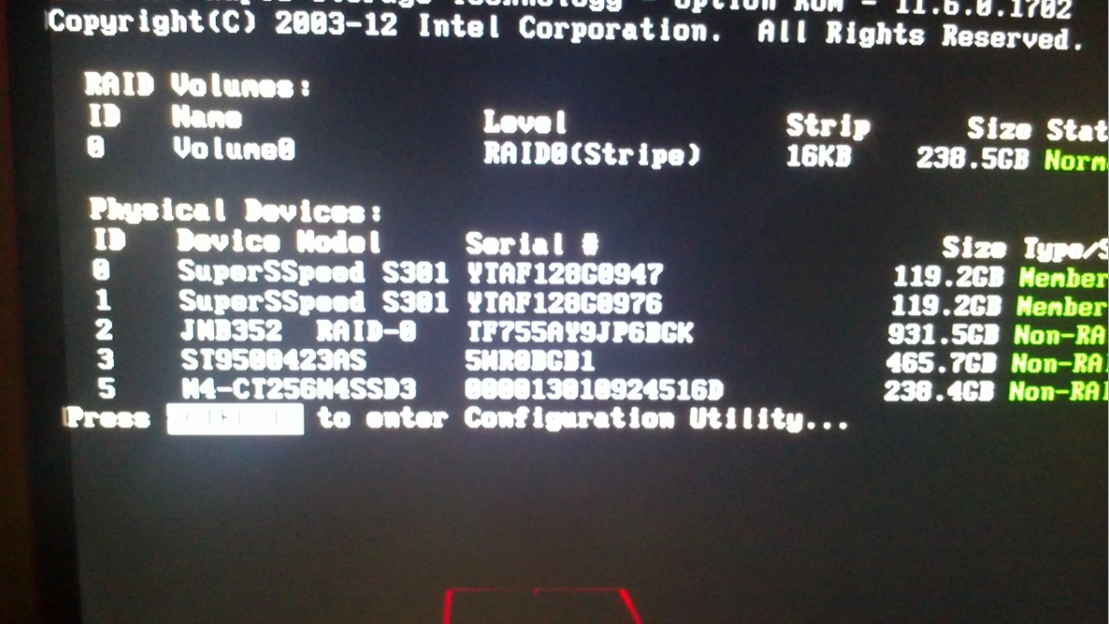

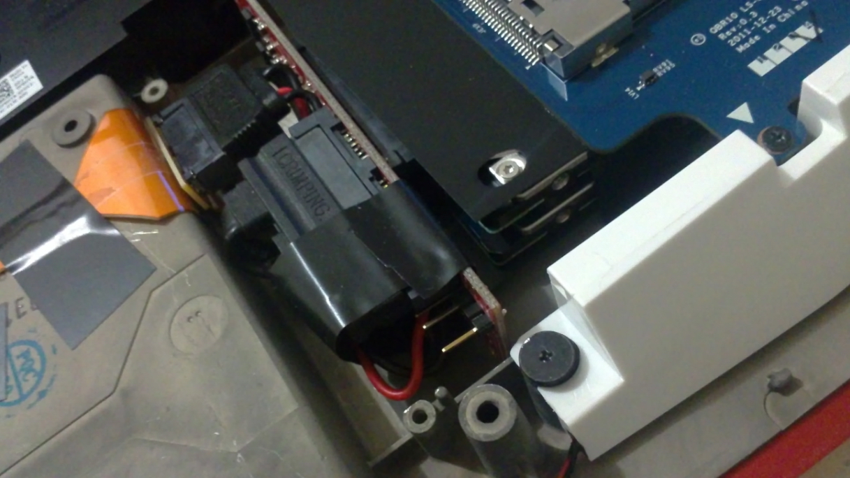

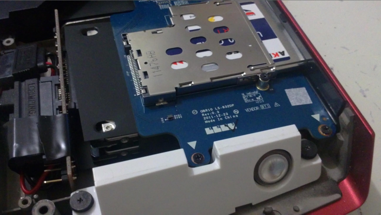

  18. dual 2.5" HDD bay in optical drive area look at drive 2, JMB352-raid 0. it gets picked up by intel 7 series raid controller but it doesnt appear in the bios though i had to file a tiny thin layer of interior bottom chassis to get two 7mm hdds to fit, didn't bother to make a new bracket for it. two 5mm should fit and still have space left, two 7mm without modding chassis would be a real tight fit and might end up tilting the daughterboard a tiny bit by 1 to 2 mm. raid board i got off ebay provides JBOD, Raid 0 and 1 I think. JBOD not working maybe cause port multiplier not working on optical drive cable. raid 0 performance at around 230mb/s 220mb/s read/write so for HDD its good. raid card: http://www.ebay.com/itm/SATA-to-Dual-SATA-RAID-0-Device-Adapter-w-Mounting-Kit-/280719990939?pt=US_Drive_Cables_dapters&hash=item415c37209b 13pin to 22pin sata: http://www.ebay.com/itm/261184737920?ssPageName=STRK:MEWNX:IT&_trksid=p3984.m1497.l2649 thats total of five 2.5" HDD/SSD and one msata in m18xR2 or four 2.5" HDD in m18xR1! going for a 5x 2.5" and 2x msata in the R2 soon..
