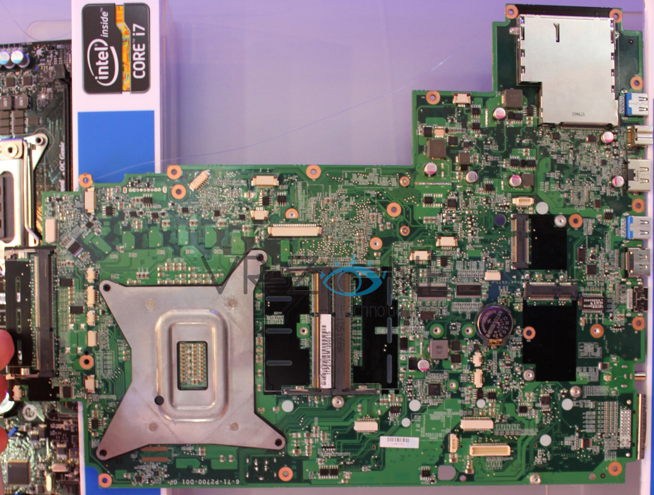

    Truthfully, I would like MXM 3B SLI in 13.3", which is physically perfectly possible. You do not have to sacrifice or shrink nothing, maybe except intermediaries profit.

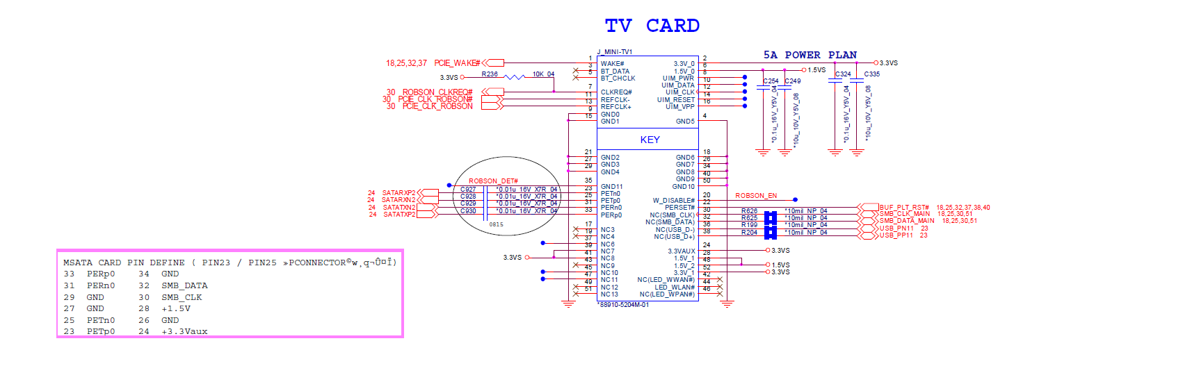

  11. KBC-ITE IT8518E for P375SM KBC-ITE IT8587A for P375SM-A

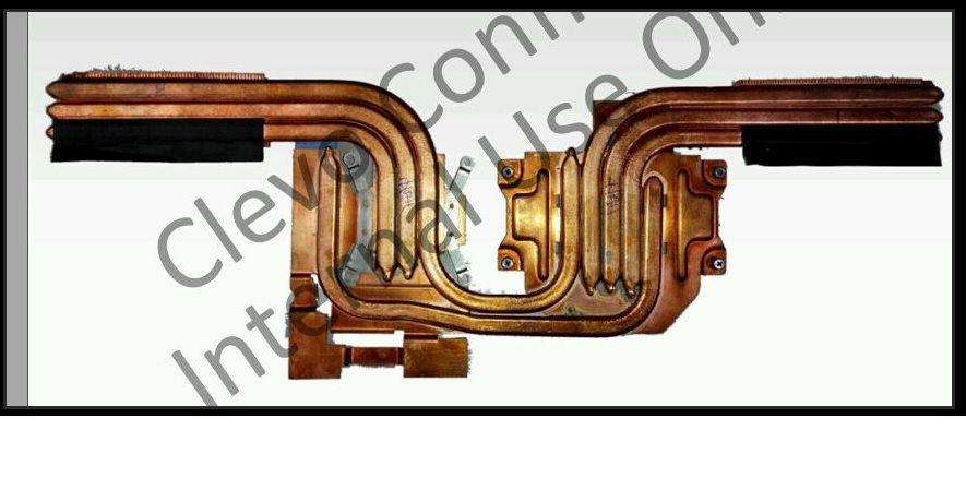

  18. This is probably P7xxZM cooling system. What a pity. Clevo engineers repeat the same design flaw as Compal's and Quanta's. Namely, cold<-hot<->hot->cold system, rather than hot->cold<->cold<-hot. It can not work well. The heat must escape to the outside as soon as possible (only through the radiator) and does not heat the remaining elements. Clevo! The hot->cold<->cold<-hot system has the same thermal inertia mass as cold<-hot<->hot->cold, but it will be better drain heat outside.
