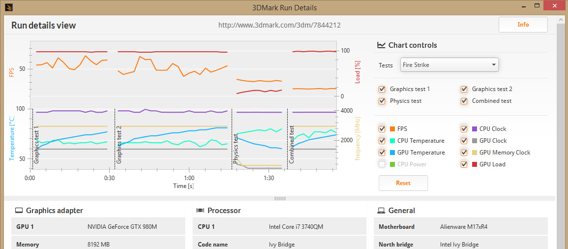

  10. I have an issue with using GTX 980m in dedicated mode. I can get it working fine without throttling in Optimus: NVIDIA GeForce GTX 980M video card benchmark result - Intel Core i7-3740QM Processor,Alienware M17xR4 But if I switch Intel GPU off with Fn+F7, remove all the graphics drivers in safe mode with DDU (they are missing anyway, but just to be safe) and then install 335.06, card throttles. At all times, even without any overclock - just svl7 vBIOS. I tried setting the card on maximum performance, multiple drivers cleaning (enabling Intel, clean all GPU drivers with DDU), disable Intel, clean the drivers again and then install with no luck. The drivers always install fine, I have no issues with that, but the card throttles every single time regardless of what I do. Is there any real benefit in having the nVidia card in dedicated mode performance wise?
  11. Firestrike with the new drivers (1.156V): NVIDIA GeForce GTX 980M video card benchmark result - Intel Core i7-3740QM Processor,Alienware M17xR4 I can't mark GPU clock and CPU memory clock like you did in Run details. I am guessing this might be caused by Optimus. Both options are greyed out for me. I ran Heaven first as per your advise and the card did not throttle in Firestrike even the first time. Thank you for keeping us up to date with the latest drivers and great advises.
