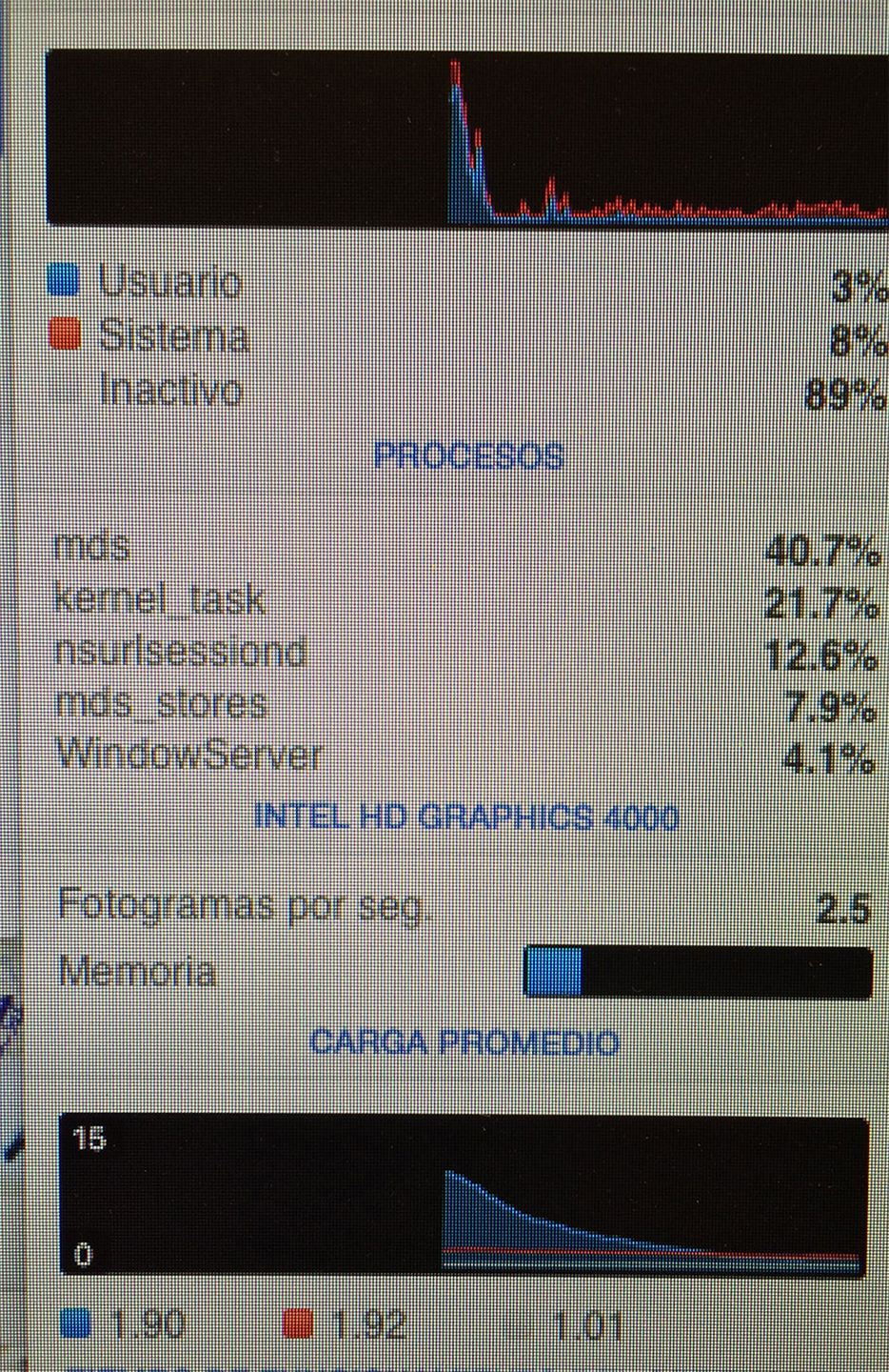

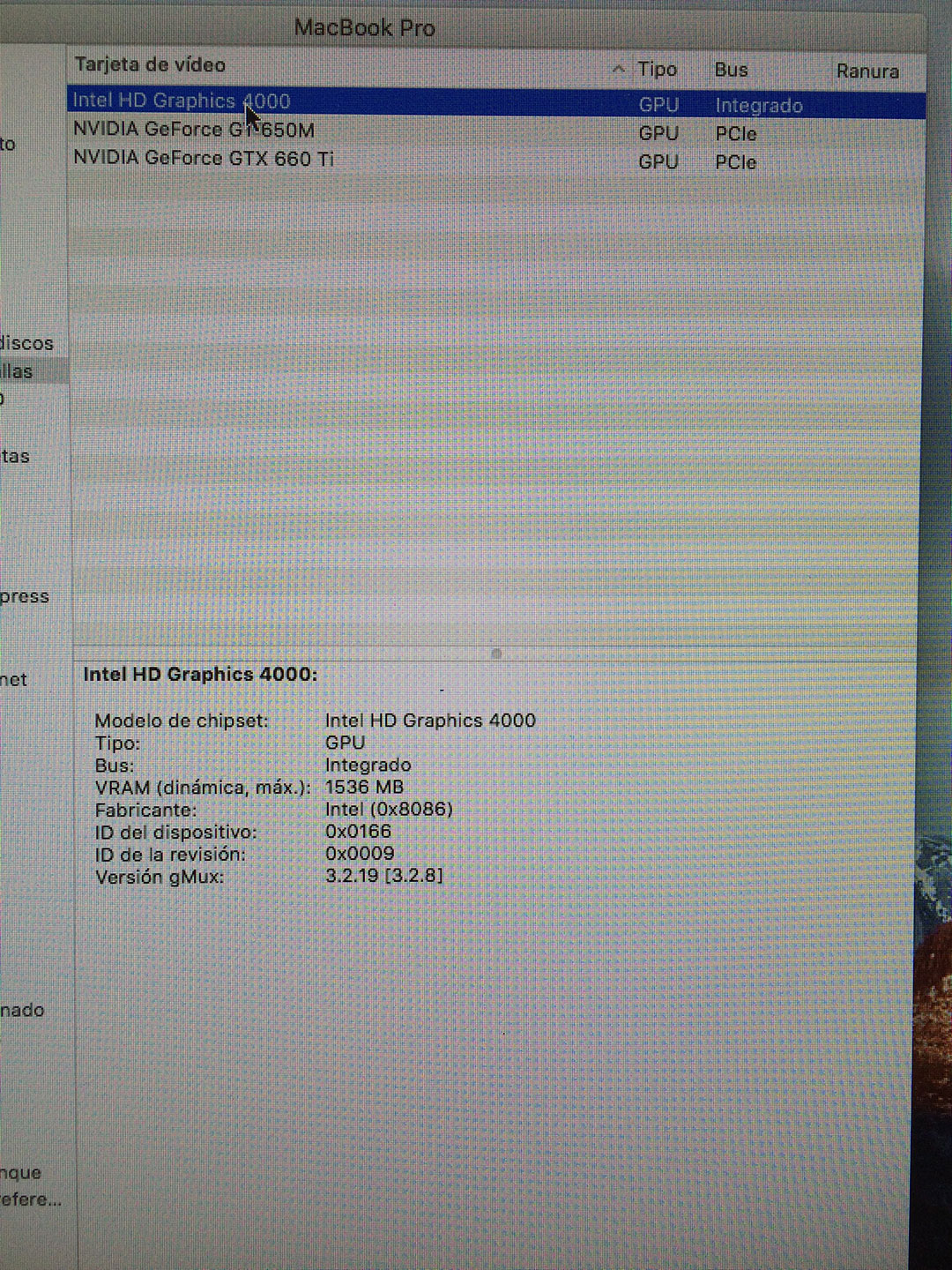

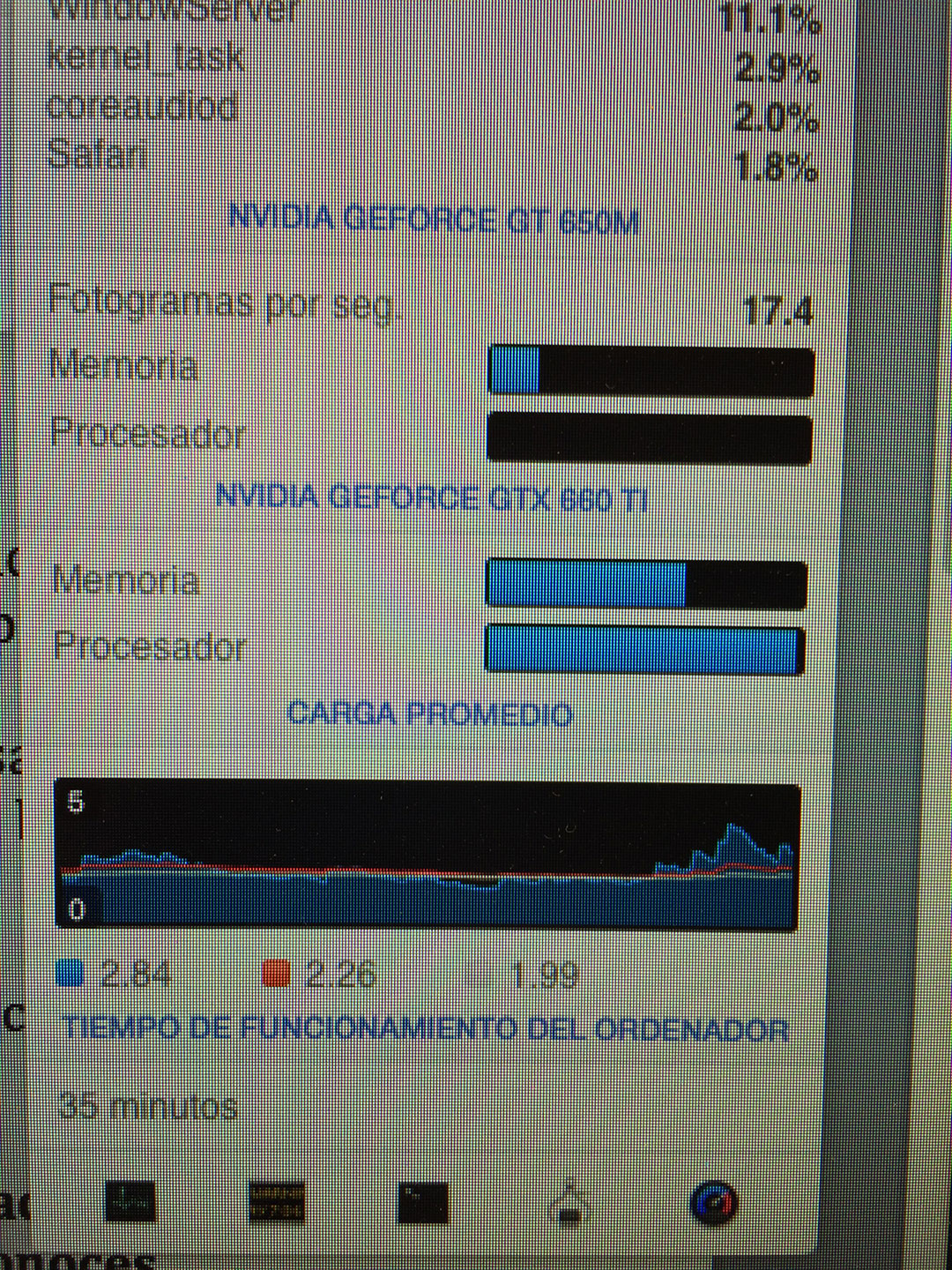

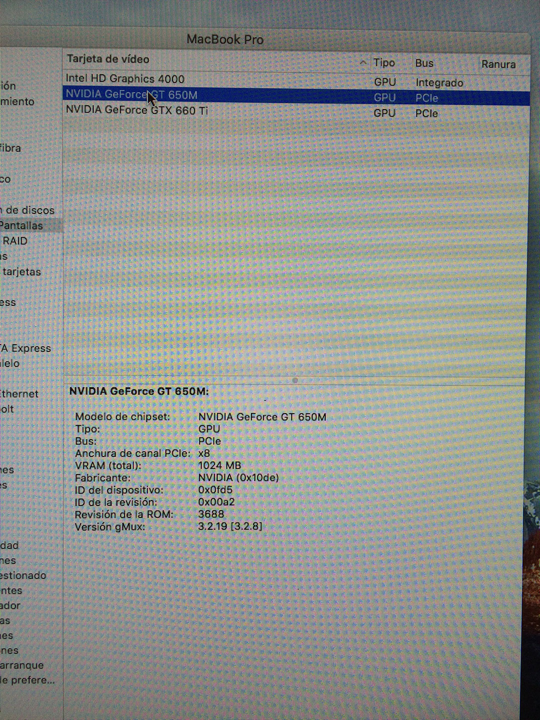

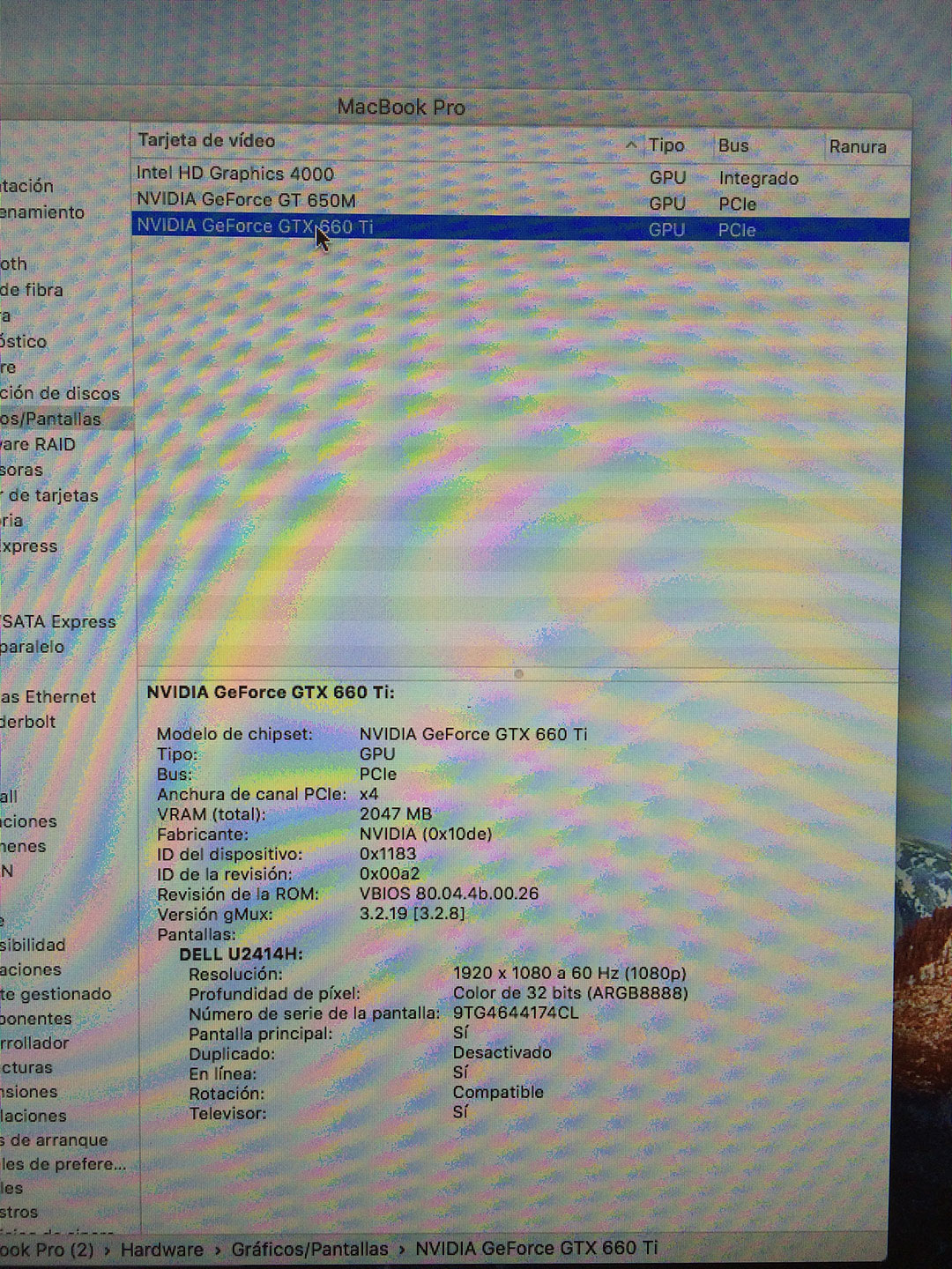

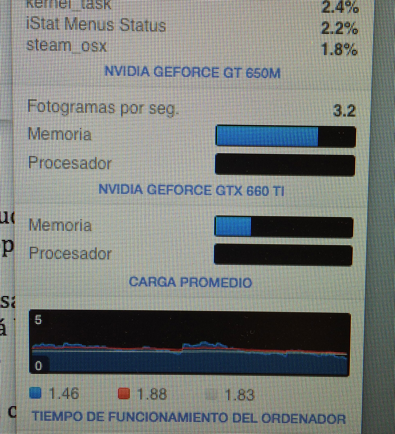

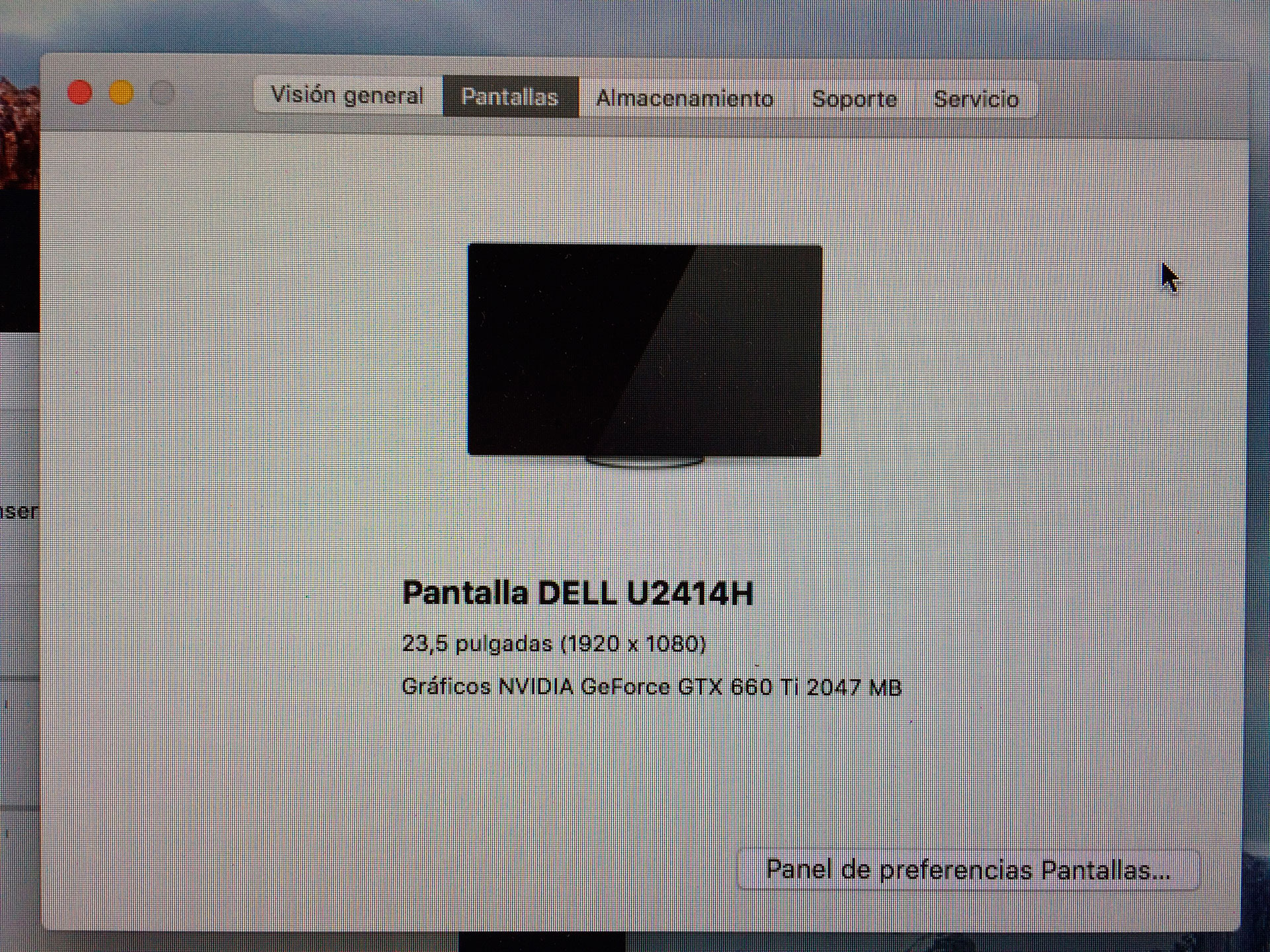

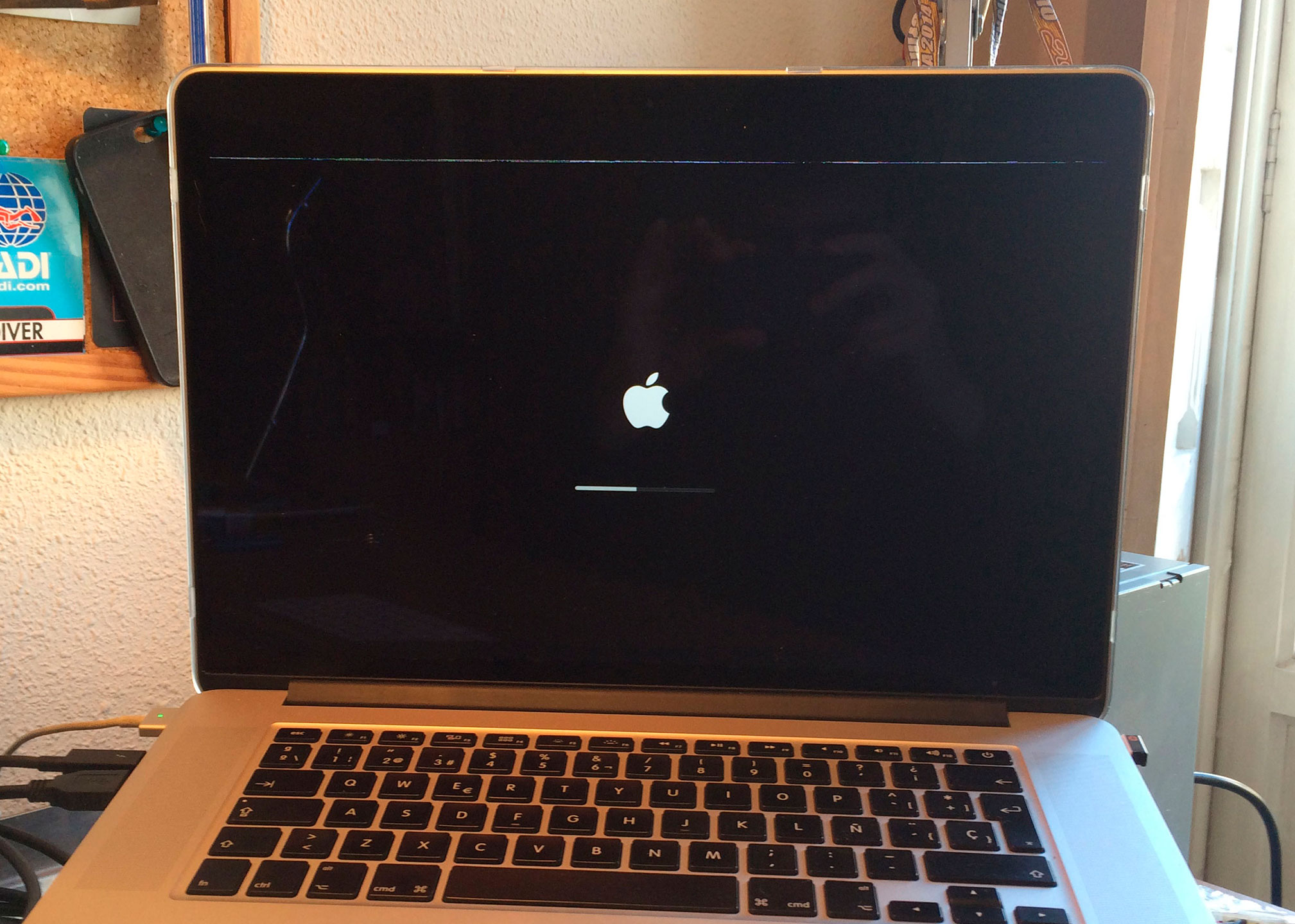

  4. Ok, I´ve been trying different combinations no one is stable with v0.9.6: 1- Automatic gfxCardStatus = NOT STABLE 2 - Force dGPU with gfxCardStatus + ClamShell Mode (Rebooting with the Macbook Screen closed) = NOT STABLE (Internal screen is not recognized by the system And shows frezed image 3- Force iGPU = NOT STABLE (Start system without external screen connected to te eGPU force the iGPU and reboot, without that is not possible to force it) 4- Force iGPU + ClamShell Mode = NOT STABLE (Repeating the steps to disable internal screen in step 2) * I thought this could be the good one So no luck at the moment... What it looks curious to me is that my software monitor iStat Monitor shows the usage if the GPUs and when the iGPU is in use only shows the iGPU in the monitoring screen, but when the dGPU is in use you can see dGPU and eGPU in the monitor software, is like the soft only things that the eGPU is connected when the OS is using the dGPU when in fact in both situations eGPU is in use Last one is with Heaven benchmark running
