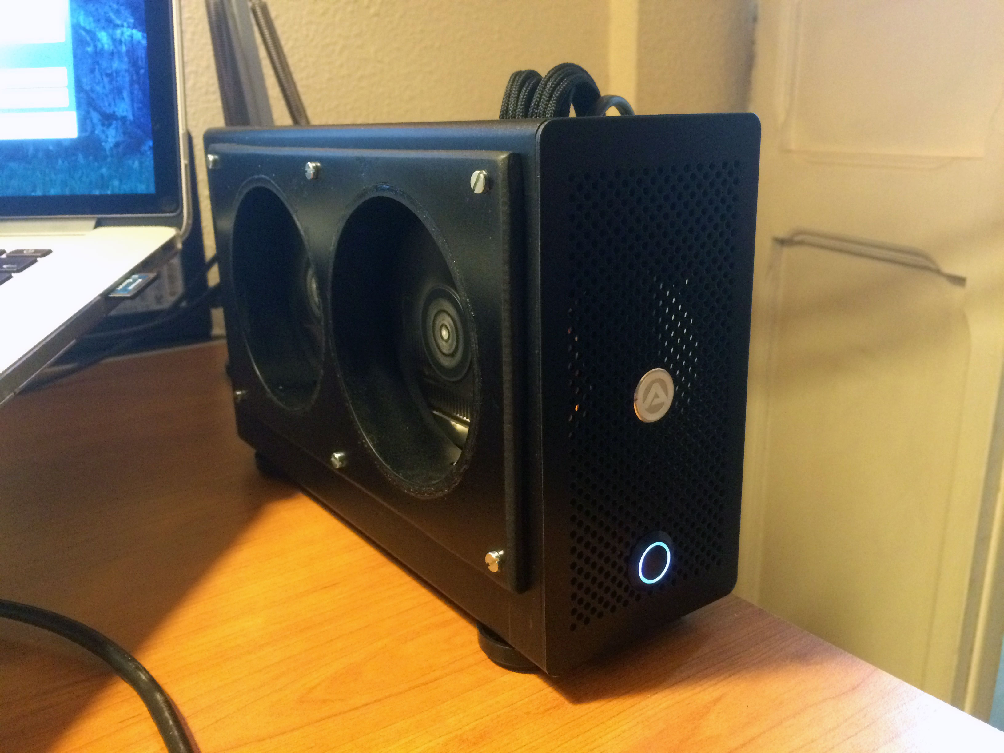

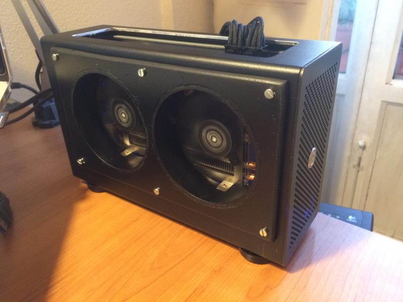

  7. Thanks, I´ll try post all pictures about construction process and explanation in a couple of days, but as you can see in the pictures fan only take fresh air from the exterior, and the push the warm air to the hole into the upper part. Without the pipes fans took air from everywhere, some fresh air but also warm air from the card. Next step is finish all the electric cable inside the case (GPU, PSU switch, maybe extra fans) and design a top part cover.
  8. Hi Dschijn I´m finishing my build, it´s objetive is to improve the cooling of the egpu, at the moment I´m really happy about the results but I realized after playing for long periods of time that the akitio´s board gets little hot. My intention is to use those fans to canalize fresh air directly to de board and as you know there is no much free space inside the case so I need really small fans and those Noctua are in my opinion the best (size/noise/air flow) I´ll try to start a new post this weekend with all the work and steps I did in my not yet finished build and maybe you can give me your oppinion, I´m going to post a couple of pictures (I can´t wait xD) As I said before is not finished but you can start to see the finish design.
