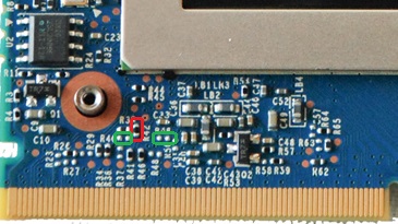

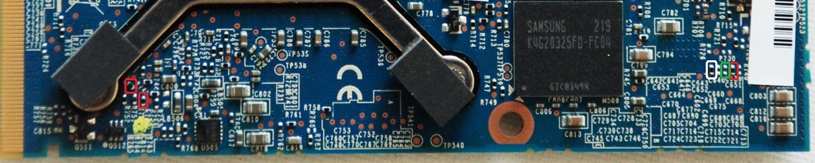

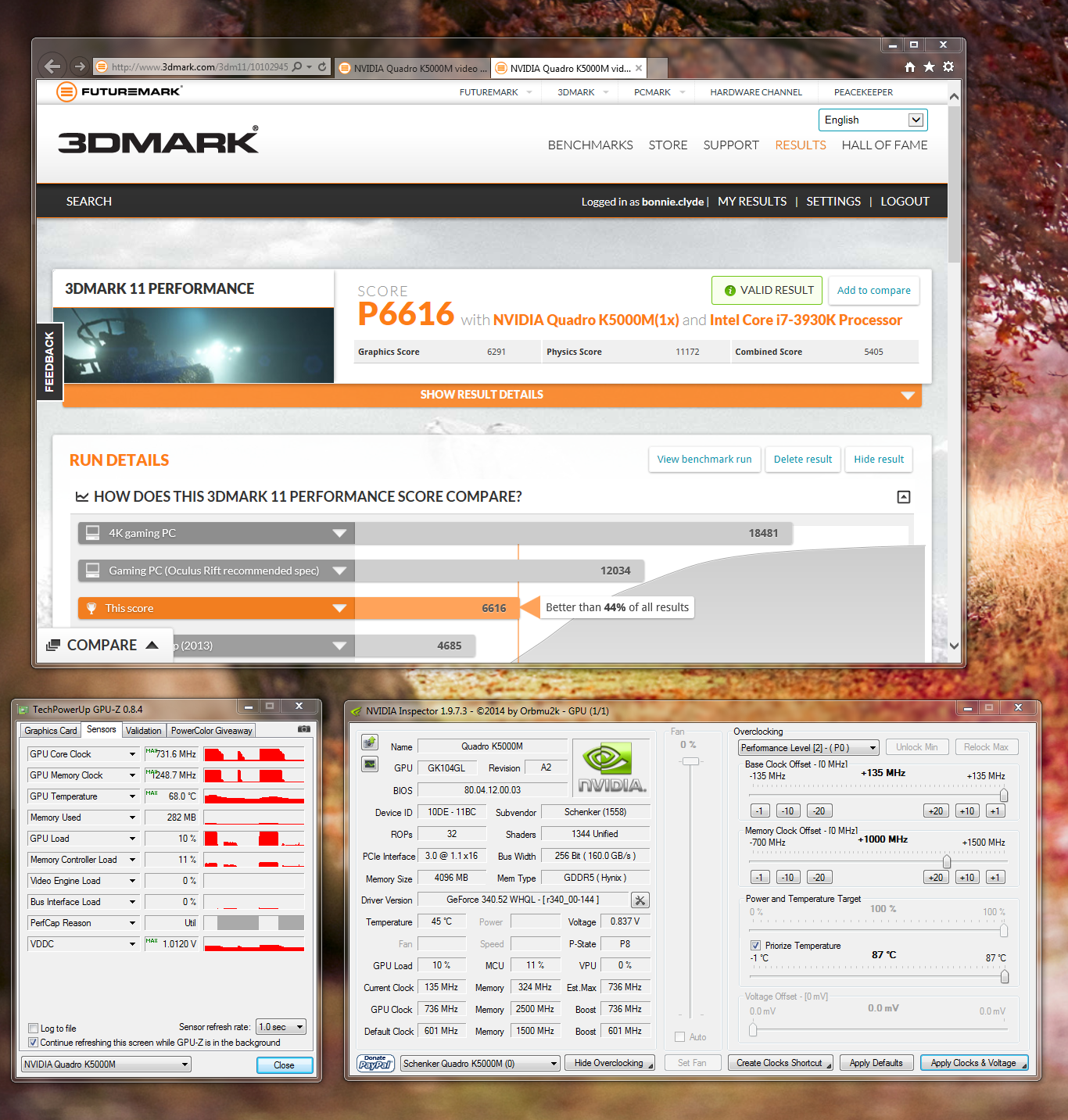

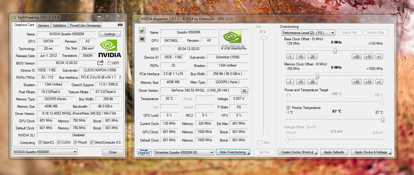

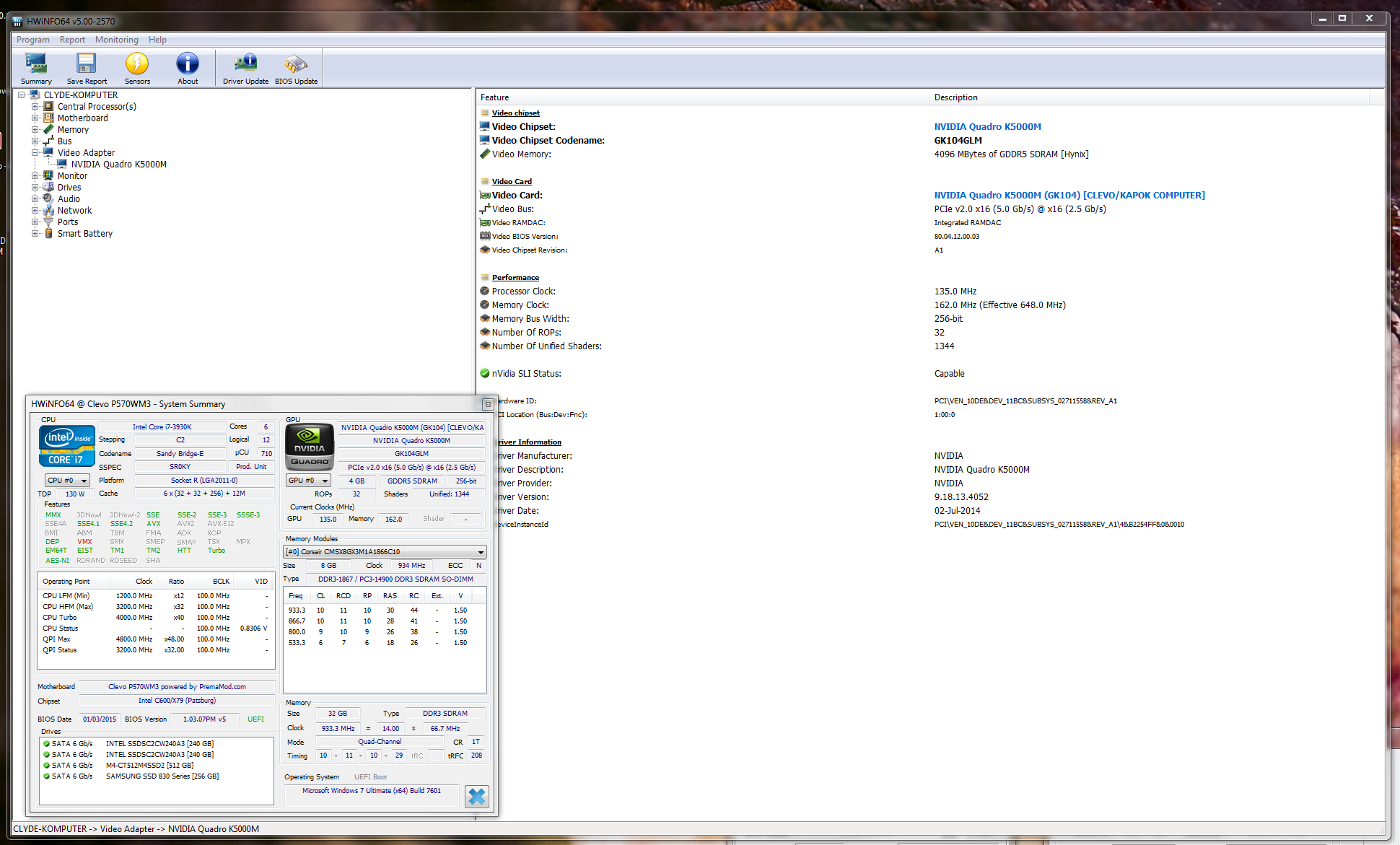

  4. Recently I got hold of GTX680M, which I was able to convert in K5000M. In front: 1. You need to unsolder the 5K (R42) resistor marked in red. 2. You need to solder the 25K (R40) resistor and 0K jumper (R49) in places marked in green. In back: 1. You need to unsolder two 100K resistors marked in red (on the left) and 35K (on the right). 2. You need to solder 35K resistor in places marked in green. Resistor marked in white (on the right) is a GDDR5 manufacturer ID resistor where 45K is Samsung and 35K is Hynix assigned. 3DMark11 stock + 135/1000MHz Only BIOS has some problem yet with the proper card recognition. Have fun.
