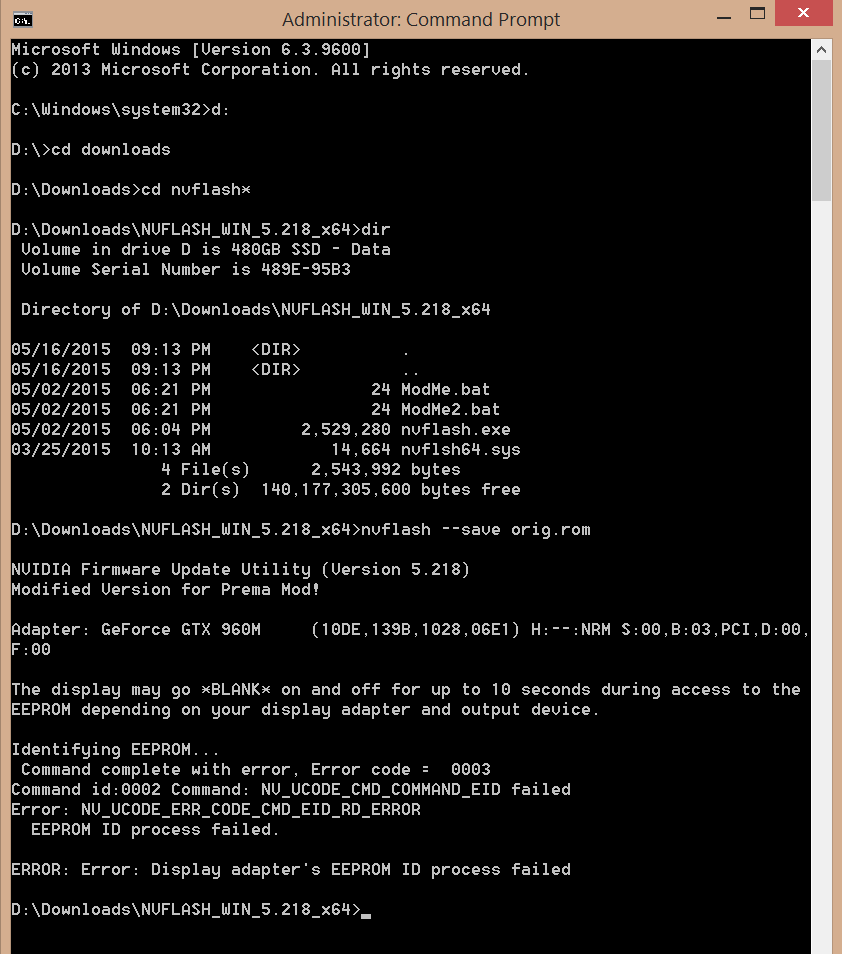

No, nothing is messed up from earlier attempts to modify anything. I went from a fully stock 350.12 to the 347.90 provided and it made a terrible mess. Nothing inf-modded has ever installed on this system - it always fails to install if attempted, and this is not the fault of the existing driver. Furthermore I'm not looking to go through the messy recovery process from installing the 347.90 driver a second time. I'm looking for a modified vBIOS that allows use of the regular old driver from the nVidia website which installs happily without error, as does the slightly earlier, but later than 347.90, version provided on the Dell support downloads site for this machine.

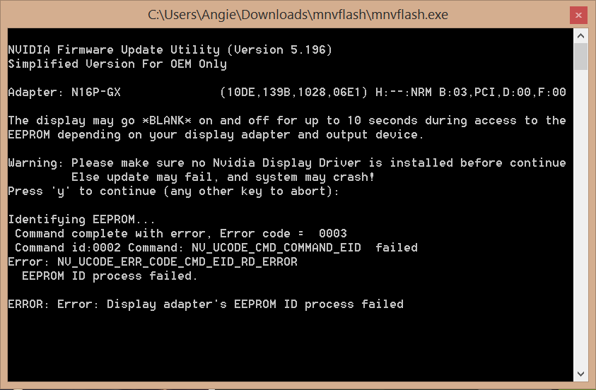

So I downloaded that driver, 347.90 via the link provided, ran it normally, and it actually bolloxed the system. Specifically it appeared to install (clean install) but produced no nVidia icon in the system tray. Upon immediate reboot, Windows appeared to "think" it was working normally behind the scenes, but the display output was all black and the system was unusable. As for the newer nvflash, I just tested it and got the same result as before. Initially I had ran it with an actual game running in the background, but holding the dGPU open with GPU-Z yields the same result: I'd sure appreciate a system BIOS including a vBIOS modded with your "new method!"

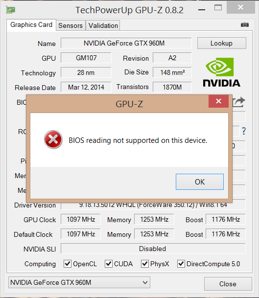

Prema, Thank you for your reply! Attached is the nvdmi.inf from driver version 347.88. +135MHz sounds like an improvement, for sure, but I was hoping to see just how far you can go on this system - as I've read that Maxwell has extreme overclocking potential, limited by little else than your ability to dissipate heat. For that matter, I do remember being able to successfully overclock my 650m by over 450MHz with a modded system BIOS. On that note, I've also uploaded two screenshots - one attempting to save the current vBIOS with GPU-Z, and another attempting the same with svl7's mnvflash utility. Both fail, as GPU-Z reports "BIOS reading is not supported on this device" and mnvflash throws a more specific error. There does appear to be a key in the registry, under HKLM\System\CurrentControlSet\Control\Class ... nVidia card's key, that appears to be the entire contents of the vBIOS - and I could upload that but even if you could use it in the form of a .reg file to do some modding we'd be left with the question of how to re-flash the product, as mnvflash appears to fail regardless of whether there's an nVidia driver installed or not. My ultimate goal here is obviously a modified vBIOS that allows for a ton of overclocking headroom to play with, and I'd appreciate anything you can do to help me work toward that goal - and for the possibility to create and test something to post and share with the community, but in the meantime I understand and respect that you're busy so a modded inf file would be appreciated as well! ... whenever you have the time; Thank you!! My full hardware ID is as follows: PCI\VEN_10DE&DEV_139B&REV_A2 nvdmi.zip

OK, thank you, you did answer my question in the literal sense but what I'm really after here is a link, download, or a procedure. I mean I'm sure it CAN be done, but as yet I've been unable to come up with anything that works. nVidia has disabled overclocking at the vBIOS and/or driver level, and since this thread is about modded vBIOS for the 970m & 980m, I was hoping to inspire a mod for the 960m as well. I can provide my stock vBIOS if necessary.
I just recently received my newest Alienware purchase - the new 13" model with an nVidia GeForce GTX 960m (a Maxwell chip.) I'm aware of the recent debacle in which nVidia disabled all mobile overclocking in their drivers, I believe versions 345.09 and up. It's also been said that they've disabled it in their new vBIOSes as well. However I was able to uncover a link in which users are confirming that version 347.88 enabled overclocking even on cards that are intended to be clock-blocked in vBIOS: NVIDIA 347.88 Game Ready Driver - 17/03 (re-enables overclocking!) | NotebookReview There's even a user who reports having inf-modded that driver to allow installation with the new 960m, and claims to have unlocked overclocking capability. However, as yet I've been unsuccessful in modding that same driver to install on my system. I've copied the main ListDevices.txt file and all the .inf files in the Display.Driver folder over from version 350.12 which naturally supports the 960m but the result reports "required files are missing" and will not install. Could someone with more experience than I when it comes to inf-modding a driver give me some pointers? Any other ideas or solutions for unlocking the likely massive OC potential of the 960m? vBIOS mod perhaps? I've seen a mod for the 970m along with a modified nvflash EXE. I can provide my current vBIOS if anyone is willing to look into it!! Thank you!!
