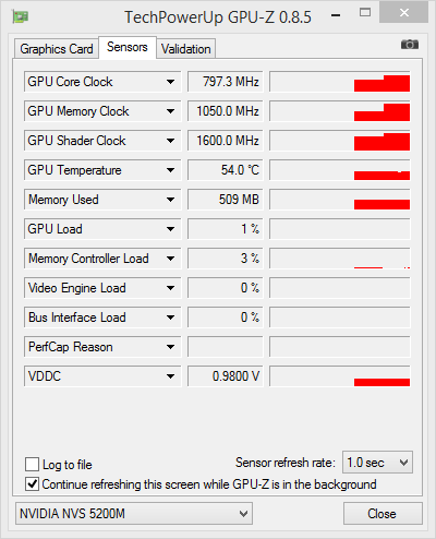

Overclocking the NVS5200M is fairly easy compared to iGPU OC. OCing the NVS5200M's core and memory by ~30% can achieve up to ~35% better performance (Furmark Benchmark) and provide great graphics performance for gaming on the go. I can say that the performance gain is almost linear.
To accomplish the OC you can use any application which can manipulate core/memory clocks.The lighest/easiest to use IMHO is the Nvidia Inspector. You can download the software from the guru3d.com site. No installation is needed, just download the rar extract it and fire it up.
The GUI is pretty straight forward.

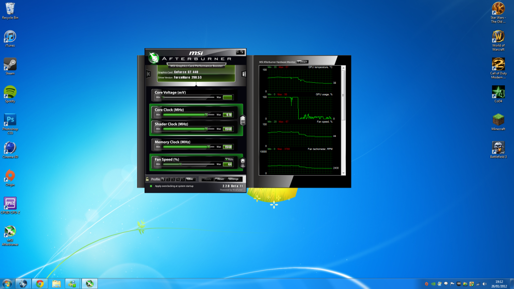

Offcourse for a more permanent solution or if you also use eGPU it is better to use MSI Afterburner and create profiles.
Tested with the Furmark 720p benchmark and 3DMark06 to measure the performance gain from one frequency to the other and the difference btw iGPU-dGPU.
All tests where done using my i7-3720QM (4 top bins unlcocked) with 2x4GB Kingston RAM @ 2133MHz.
Core clock runs stock @672 MHz and went all the way up to 891 MHz with a total performance gain up to ~31%.
Be sure to use a 130W PSU though because with 90W and a 4C i7 you are limited to 780MHz stable.
(A high end GF108 implementation (e.g. GT440) running @ 810 MHz Core 1800 MHz memory has TDP up to 65W. Add to that the 45W an 4C i7 draws or the ~60W an unlocked i7 draws, you may be at the limits of your 130W PSU, let alone 90W)
GPU clock would go up to 891 MHz and the maximum memory would be 2100 MHz. I needed to lower it a bit more to get some stable 3DMark06 results

  • Overclocking the dGPU
    • Use a program like Nvidia Inspector or MSI Afterburner
    • GPU clock would go up to 891 MHz and maximum memory would be 2100 MHz (requires a 130W PSU)

I got mine from an auction @ 200$ + s/h with i3 4GB NVS 5200M 900p 320GB hdd backlit kb without a charger and in minor condition after a two-month search last year... So I think you may find if you can wait a little bit...
My dGPU cooler handles an i7-3720QM 4-core @ 3.98GHz with maximum temps @ 95C with open bottom lid (running Prime95). Using something better than MX-2 may give better results...
Consider also that:
An OCed NVS5200M is up to 25% faster than an OCed HD4000 as discussed here http://forum.techinferno.com/dell-latitude-vostro-precision/9690-14-dell-latitude-e6430-performance-upgrades-system-mods-21.html#post144831,
and (in case you are interested) a dGPU E6430 along with a docking station is capable to drive up to 3 External screens as shown here.
