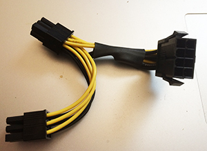

MVC Posted April 24, 2015 Share Posted April 24, 2015 I found this randomly on Ebay It turns the Dual 4 pins for CPU into Dual 6 pins for PCIE cards. Would be good thing for people using PC PSU to drive GPUs as these 12 Volt lines are sitting unused otherwise. If I find these in quantity I will link. Would be great if Monoprice carries them or some other source. Quote Link to comment Share on other sites More sharing options...

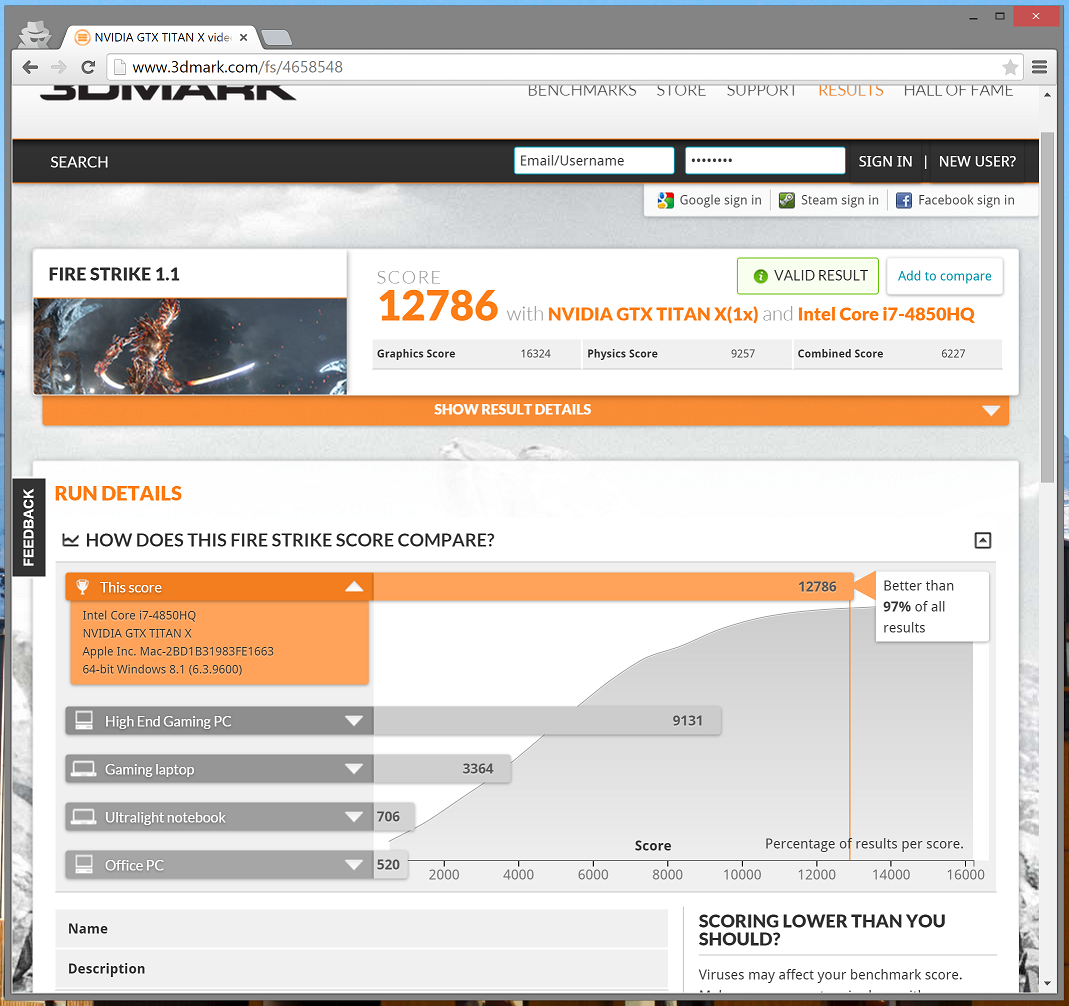

Mark Posted April 25, 2015 Share Posted April 25, 2015 Well, almost a month after I preordered it, my Titan has arrived! The first thing I did obviously is test it with the Sonnet III-D. Like the 980 I had a few months ago, it did not boot up (i.e. black screen, pressing alt to get to the boot selection screen did nothing, etc.). I tested it with my Akitio chassis (by opening up the front of the enclosure) with a barrel plug that I made for the SEL. Ran Unigine Valley for an hour without crashing and only crashed when I overclocked it. Otherwise, very stable at stock speeds. Once I make custom PCI-e cables and an EPS-to-barrel plug, and maybe even do something about closing up the chassis by extending it, I will post a guide. But for now, here's this: 3 Quote Link to comment Share on other sites More sharing options...
