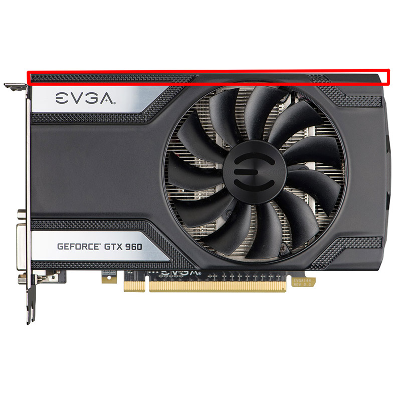

  6. Thanks for the input. I'm aiming to base my build off benchallenger's build here: http://forum.techinferno.com/implementation-guides-apple/9074-2014-13-mbp-gtx970%4016gbps-tb2-akitio-thunder2-tb-display-win8-1-%5Bbenchallenger.html or Phantron's build here: http://forum.techinferno.com/implementation-guides-apple/8882-2014-13-macbook-pro-gtx970%4016gbps-tb2-akitio-thunder2-handle-win8-1-%5Bphantron.html They were both able to close up their cases all the way. I do plan on adding some fans like him to increase cooling efficiency. So as far as the "width" problem goes, does this mean, for example, this EVGA card wouldn't fit due to the part I highlighted in red? Can someone post the internal measurements in 3 dimensions of the internal Thunder2 case with the outside case on?...
