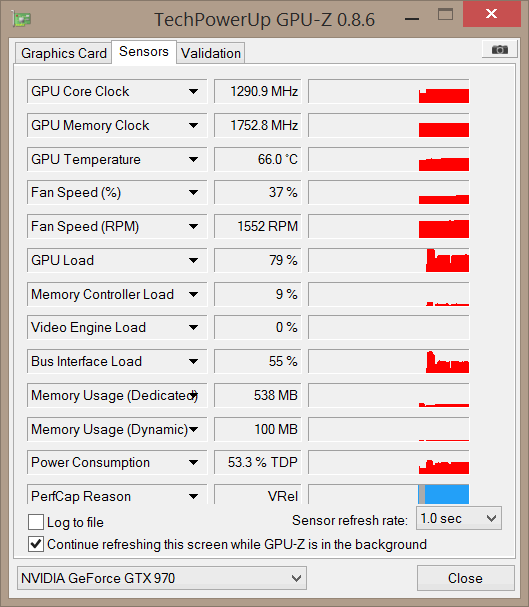

1. is it limited on an external monitor?
2. have a game running in the background on the internal screen and then load up GPU-Z. Go to the sensors tab and look at the performance cap graph. Does that show any thing bottlenecking the performance?
1. No, it's unlimited. Just on internal has the limit.
2.

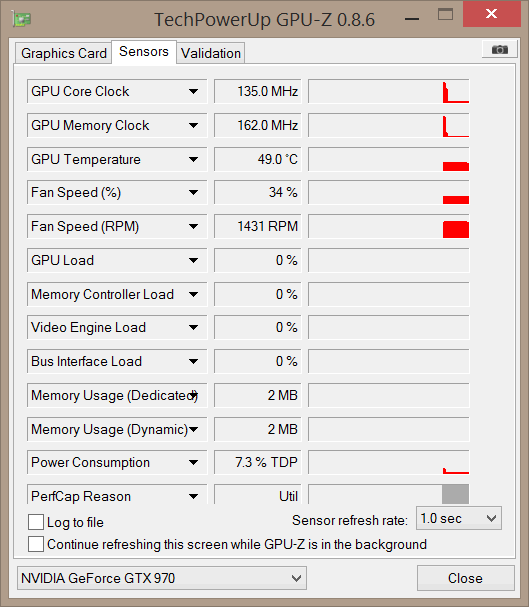

after I closed the game.
