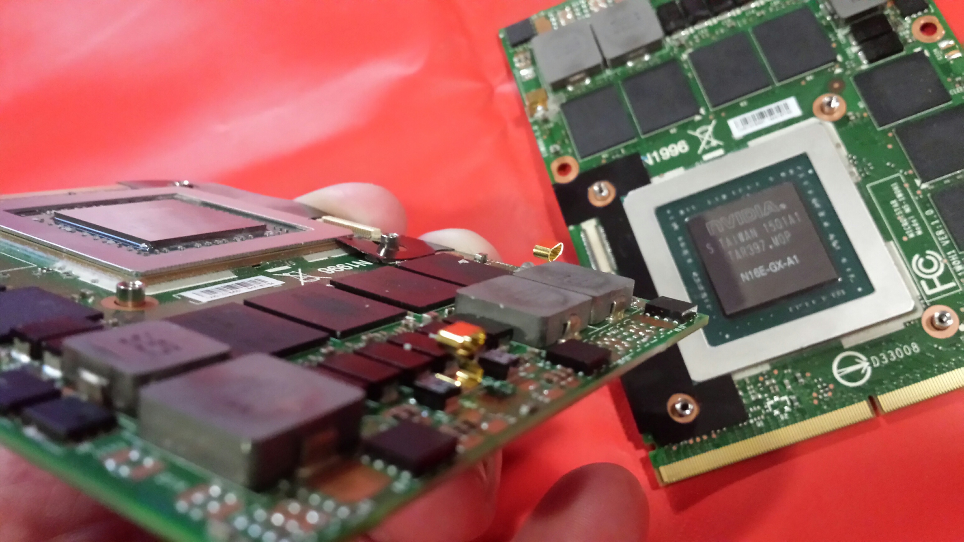

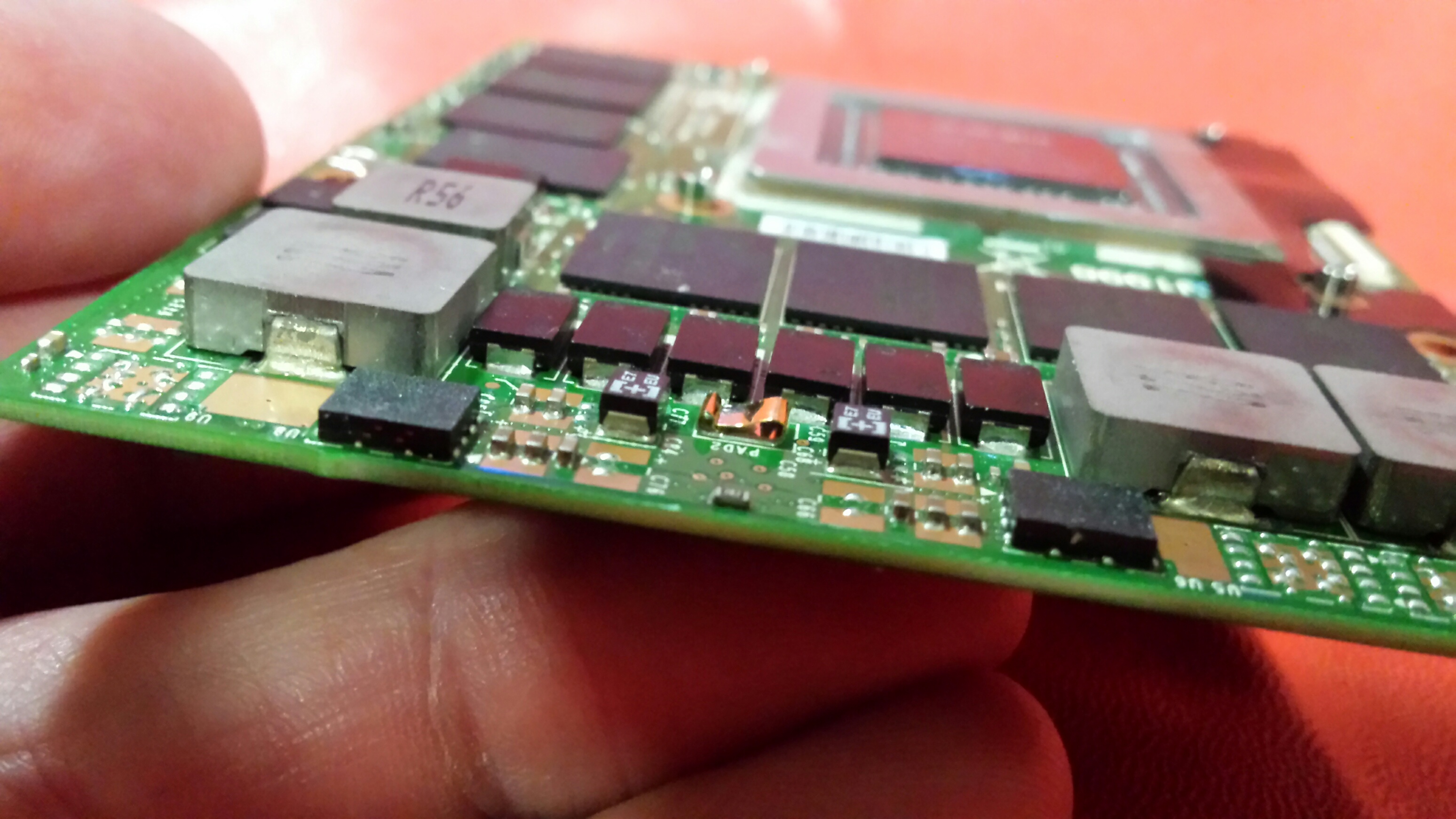

I was able to get the first MSI GTX 980m to function. The prongs had to be modified as they were causing the card to short out and not seat properly. I was tempted to just cut them off but I reformed the metal to close down and make contact upon itself and then isolate it from touching any metal with thermal pads. As I work on the second card I will include pics of the modified spring. It seems MSI's  proprietary 980 is no longer proprietary. GTX980 Works.png
WOOHOO that is awesome. Good job!

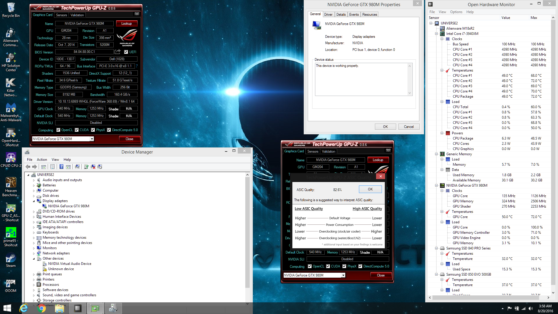

My VBIOS version is reading 84.04.88.00.C1 after flashing with premas mod. Have I used the correct VBIOS ?
Yes. It looks like it.

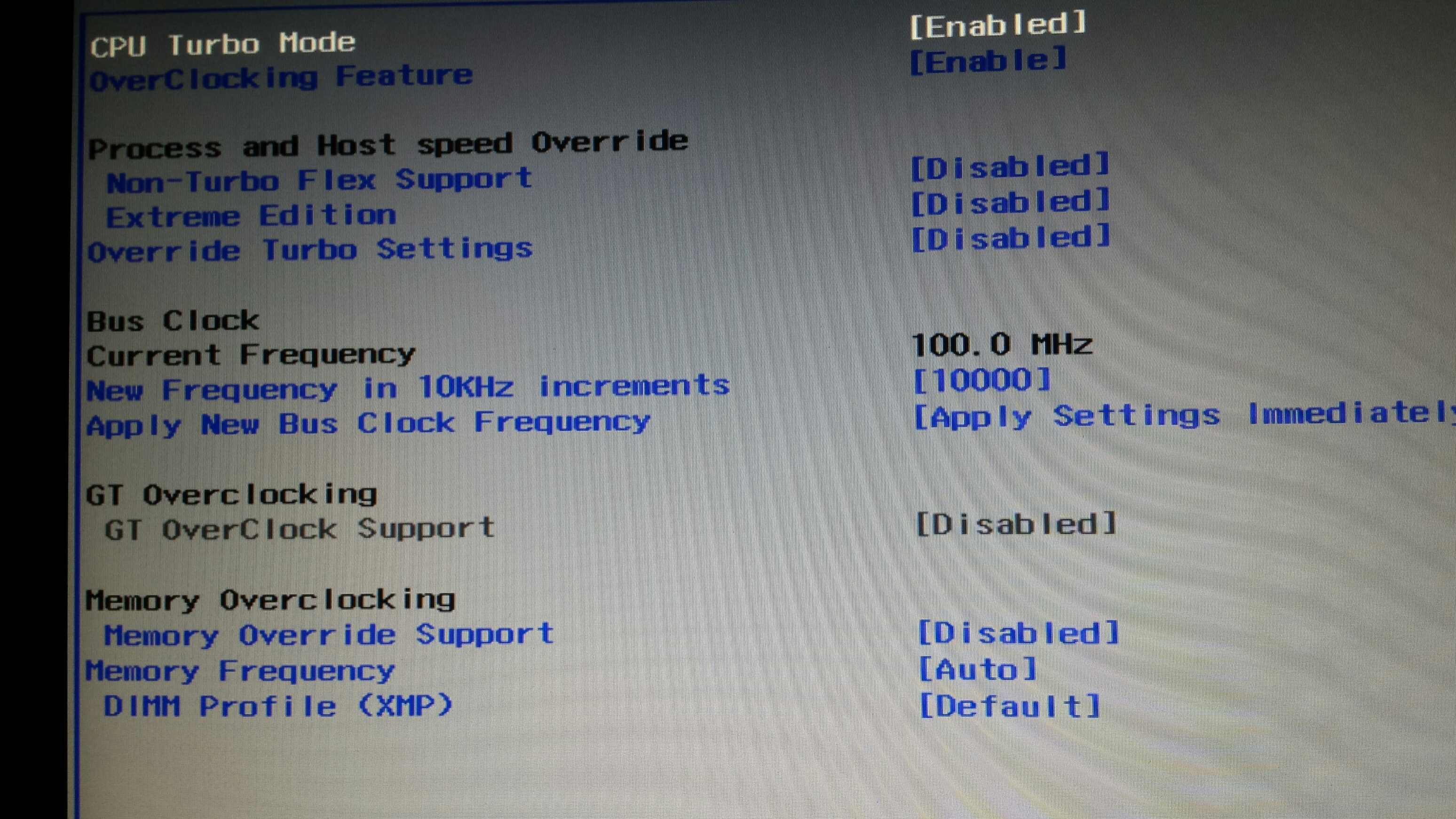

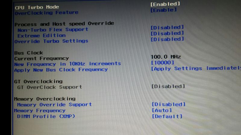

20160821_112254_resized.jpgI cant seem to access overclock functions for GTX through the new A11 unlocked bios. If I switch to igfx the function is available but once I switch to peg it is disabled ? Is their something I am not finding to acess this function ?
This has always been true. It has nothing to do with the BIOS mod or version you are using.
GT Overclocking is for the Intel iGPU. When you switch to PEG the Intel HD Graphics is disabled, so it only stands to reason GT Overclocking is also disabled. As far as the BIOS is concerned, IGFX no longer exists when PEG in enabled.
There is no reason to use GT Overclocking anyway. It is a completely worthless feature. The CPU overclocking is up above that disabled entry and that's the only thing that matters. Those options are not disabled.

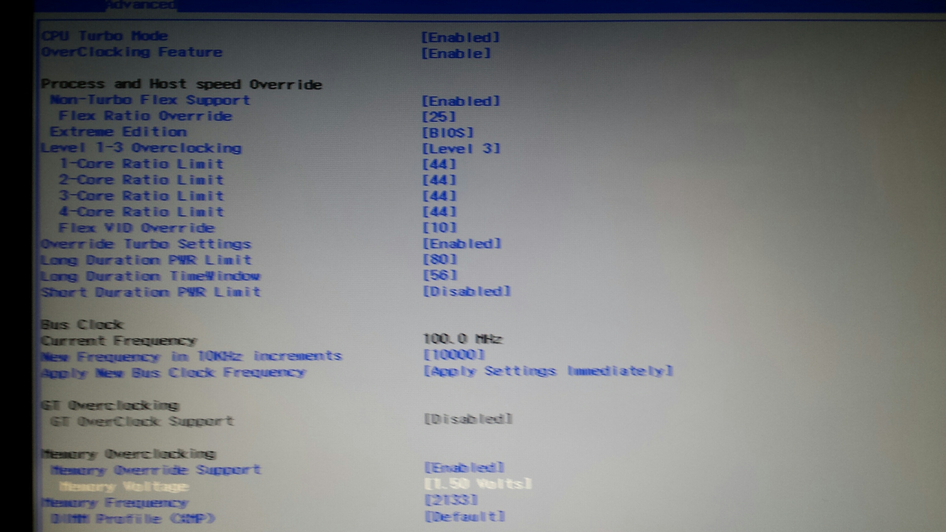

Just wanted to make sure. I have disabled my standard OC for testing the 980's In this pic is the daily OC I have been using. I have concern about DDU error in safe mode and with all of the bios switching and from 7 to 8.1 uefi and legacy I should reformat fresh 8.1 os. I need to test the 980's individually now that they are both working but I am not sure If I can run slave slot with gpu if main is pulled. I would think this would not be and issue but thought to ask to save time.

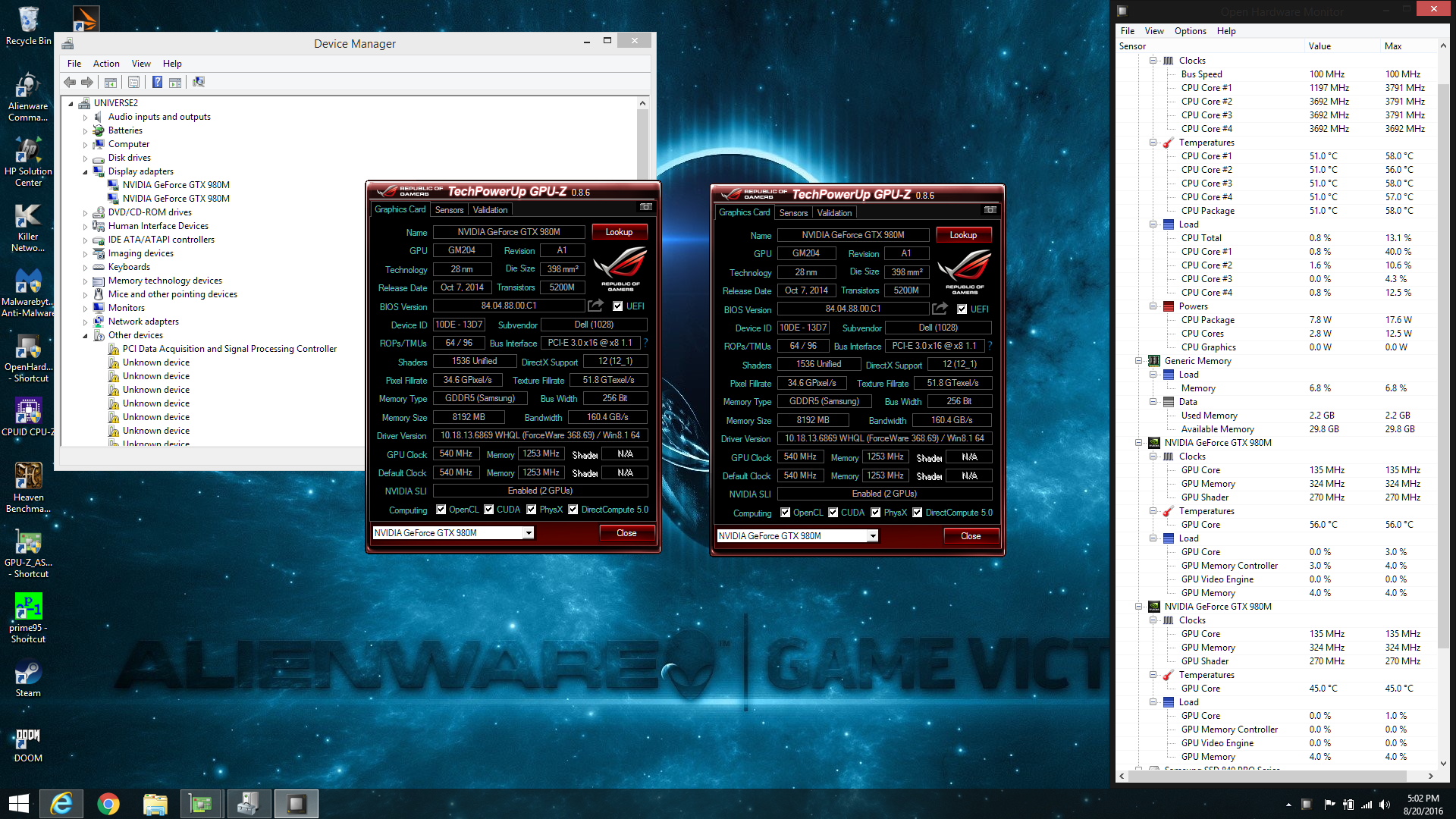

GPUZ is telling me these cards are made by Dell ? MSI laptop gt80 Titan is what they came from. VBIOS is for Clevo and mod NVidia desktop driver. How does gpuz determine manufacturer ?
5 minutes ago, Siplast said:
Yeah I thought that might be the case. Found out for sure while testing. Just running low on thermal paste but luckily I had just enough left to test each individually and set up again sli
GPU-Z does not determine the GPU manufacturer. It merely reports information about the computer as a whole based based on what the computer tells GPU-Z about itself.
So, GPU-Z is telling you these GPUs have been installed in a Dell based on the HWID of the motherboard. If you put them in an MSI it will say MSI. If you put them in a Clevo it will say Clevo.

Sadly, that will not happen. If you look in the other threads you will see a lot of drama about this. NVIDIA stopped supporting MXM. MSI and Clevo are the only two laptop manufacturers left that use discrete GPUs in notebooks. Everyone else is using BGA garbage now. Even the new ASUS laptops are BGA this go-round. Along with that change, 1070 and 1080 MXM cards are a new form factor. Clevo and MSI are not sharing a standard, so they are totally different. The cards are wider and people like me that spent big bucks on a new P870DM-G with plans of upgrading to 1080 SLI are screwed. We cannot because the slots are too close together. The new P870DM3 is a new motherboard with MXM slots moved apart to make space for two cards. We cannot even do 1070 SLI. The only potential option is 1060 SLI and there is no benefit in that over 980M SLI. What idiot would want the most pathetic and lowest performance Pascal GPU as an upgrade? LOL! Not me, that's for sure.
This is also terrible for all other laptops owners everywhere. There are no longer any high end MXM GPUs to upgrade anything after 980M. Not only are the PCBs bigger, the cards are designed differently and the core has been moved, so the screw holes for the heat sinks are in all of the wrong places. MSI and Clevo did not even do this part the same. Their cores are in different locations on the PCB, so heat sinks won't fit from one brand to another.
