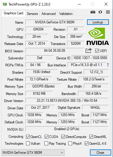

Hi Everyone, I've recently run into an issue with my Alienware m18x R2 and I'm hoping someone might have some advice. I think this may be due to updates of Windows 10 itself but I'm not sure, I reinstalled Windows 10 and wiped everything just to be safe. I've noticed that the GTX 980M GPUs throttle like crazy when running any game or 3DMark, this happens when in both SLI and single mode. Thinking this was a PSU issue I went and bought the Eurocom 780w PSU. I noticed however, that the entire machine bottlenecks around 300w and throttles back. I'm not sure a modded vBIOS would help or if there's something else I should try. Any advice would be greatly appreciated. I'm currently running Swick's A11 BIOS and stock vBIOS. I've attached my GPU-Z info in case it's of any help. Thanks in advance. -

@Zoldago Thanks for the reply, this was the systemscore. I've managed as of last night to get this to 13000 for the systemscore. I'm still working to get it up to around the 17000 range I know it can do. For me, the major fix so far was that the 2 cards were actually running different stock vBIOS. So I synch'd those up and boom, instant jump. Overclocking the system and GPU yields a little gain, but not too much. Perhaps flashing @Prema's vBIOS will help. I've also hand modified the latest drivers and used NVIDIA inspector to turn off G-Sync. Any suggestions are greatly appreciated, thanks. -

As a follow up, when I say poor 3DMark scores, I mean the highest I can get so far is around 8000 on Firestrike for high-performance gaming PCs. Every time I run the bench I get different, the usually run around 6800 - 7500.
