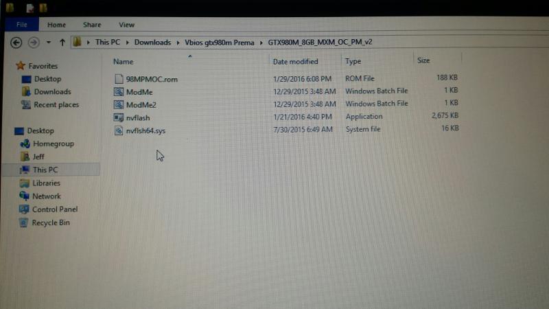

Use the version of NVFLASH provided with @Prema. Simply double-click the ModMe.bat to flash the master GPU and ModMe2.bat to flash the slave GPU.
I am out of downloads for a couple of days so I went to primas site. The file I downloaded does not  have modme.bat and when I hit the mod me I get a command prompt error msg. ?
My issue was that the file I downloaded from primas site is not dos

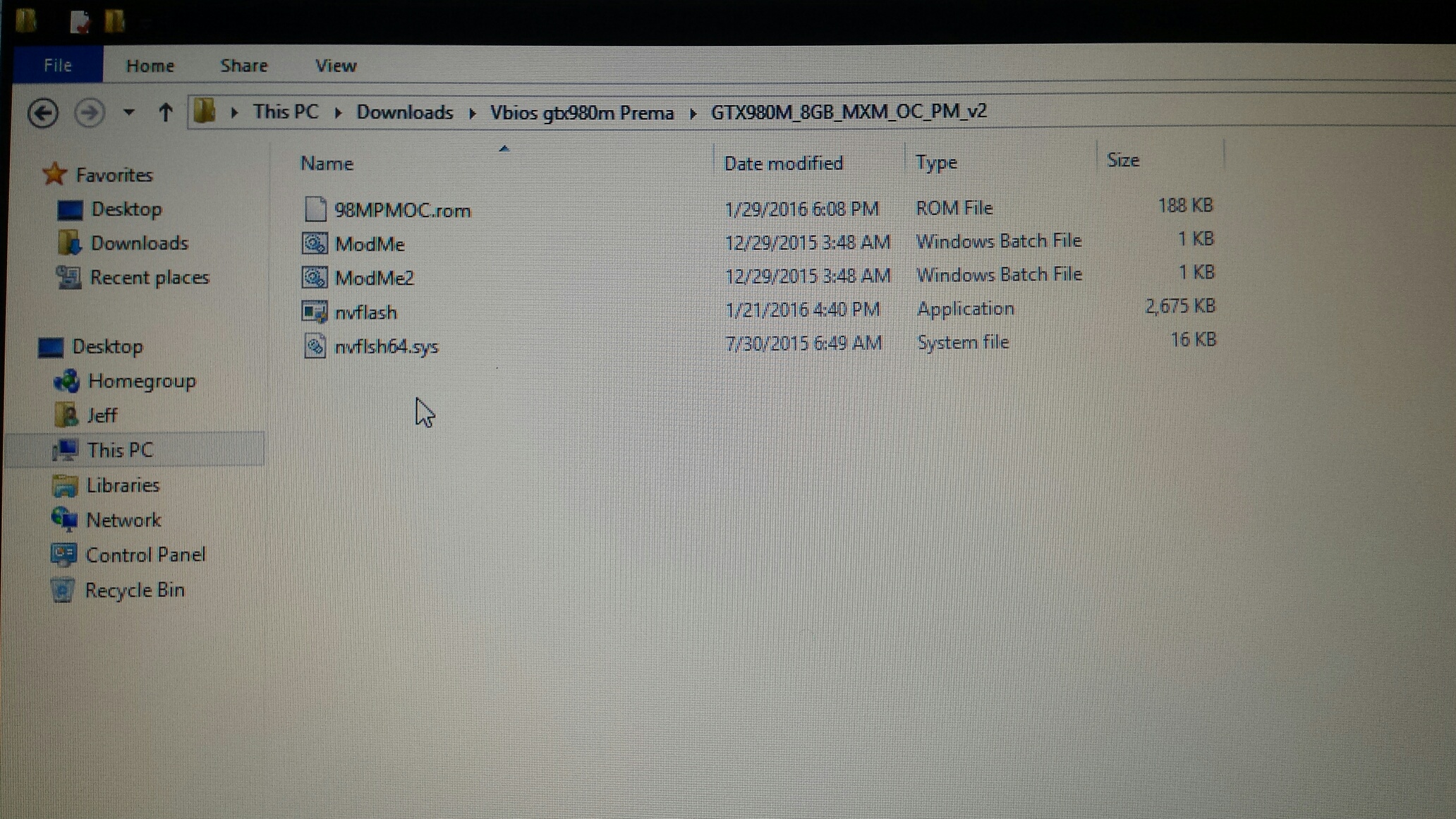

No problem. The screen shot you posted shows the ModMe.bat and ModMe2.bat files. You need to turn off the Windows crap feature that hides extensions for known file types to see the .bat part at the end of the file name. That stupid feature should always be disabled. Having it turned on (Micro$loth default) is stupid and it is also a security risk.

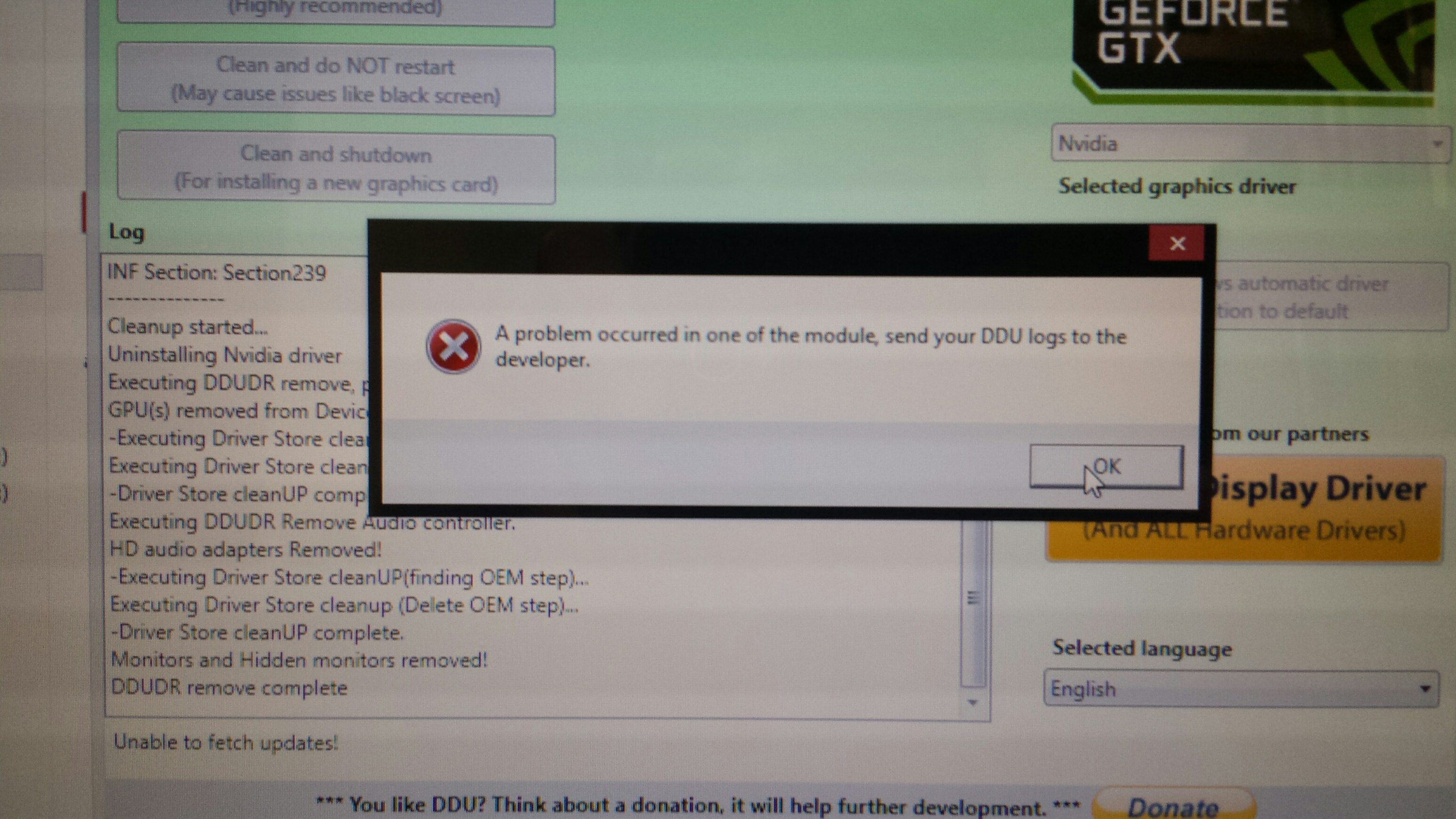

DDU is giving me and error msg. a problem occurred in one of the module. And  I was running in safe mode. I am working on the driver file and easy enough to delete the unwanted files but not sure I understand the mod info needed. The mod me.bat file is stating no NVidia display adapter found.
Deleted the nv_dispi and replaced with the one in the how to. Deleted the nvdmi file and replaced with the one in the how to. Deleted all files but the ones shown to keep. Nvidia installer fails. DDU fails. vbios flash fails.

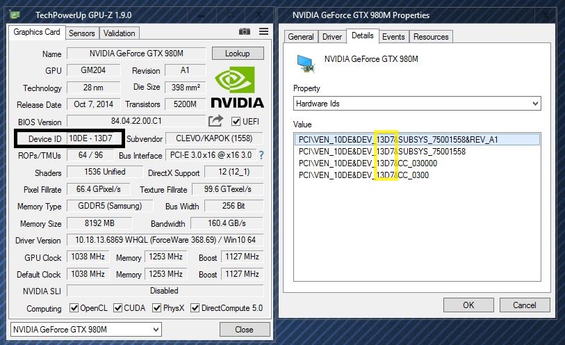

What is the hardware ID in Device Manager? Maybe that's what the deal is. If so, you may be able to edit the INF and have drivers that work fine. A "normal" 980M is 13D7. If those are not 13D7 the @Prema 980M vBIOS for Clevo and Alienware won't work.

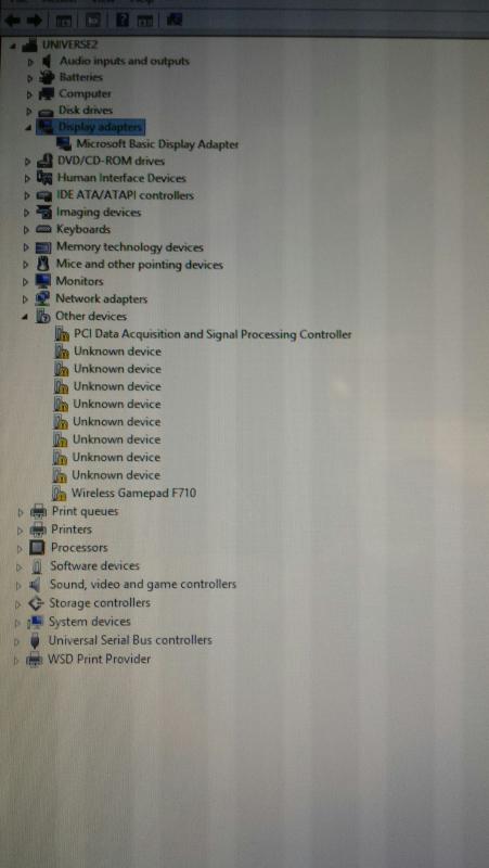

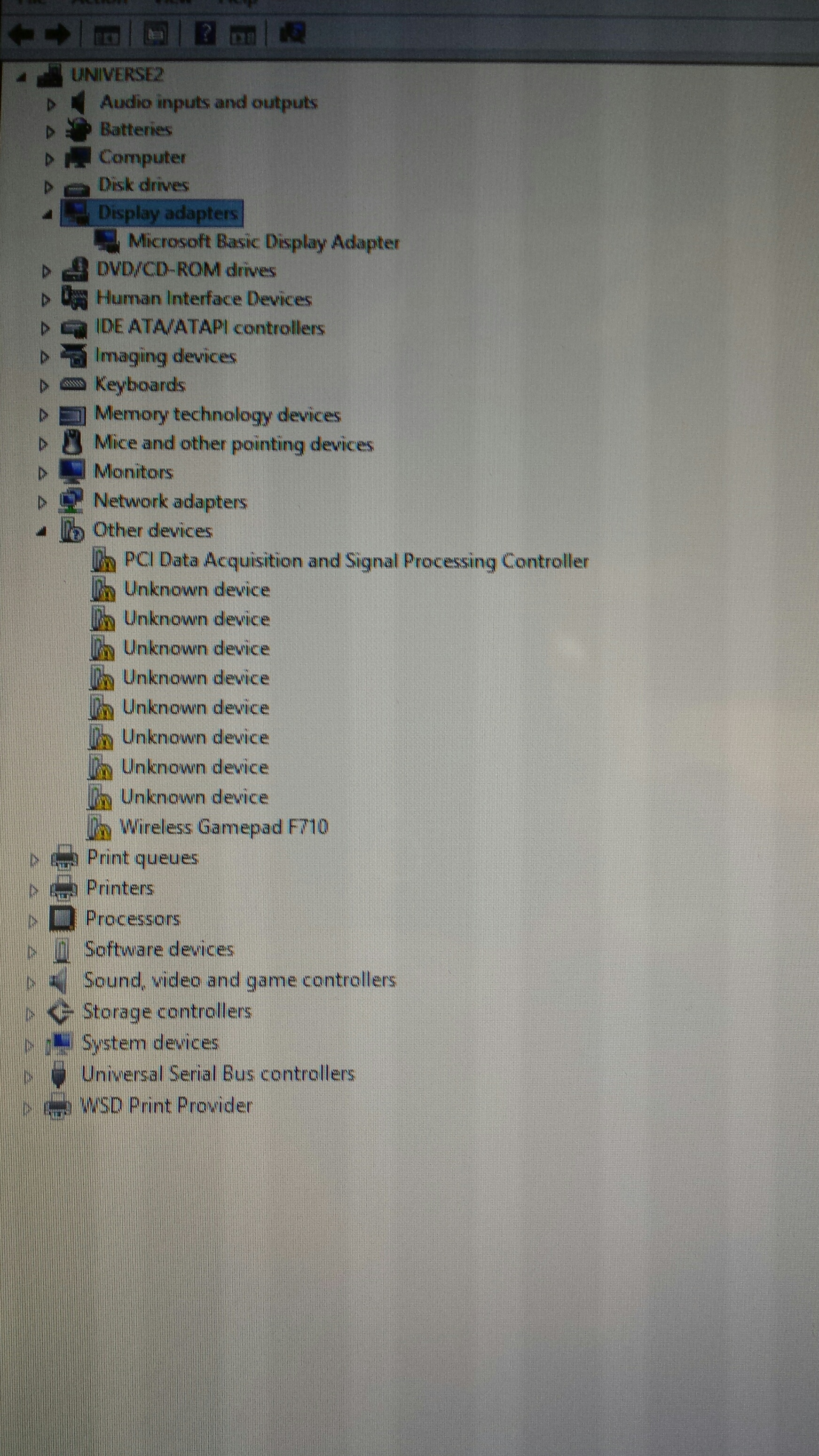

Device manager is not showing the 980's at all
Well, that might be why you are running into issues. What does it show? Please post a screen shot.
You have the BIOS set to PEG, correct? What do you see for GPUs on the BIOS main screen?
@Siplast - did you double-check the BIOS? Does the main screen show NVIDIA/GEFORCE GFX or INTEL GFX? Is it set to PEG mode?
Your Device Manager only shows one GPU, which leads me to believe it is set to use Intel HD Graphics instead of PEG mode.

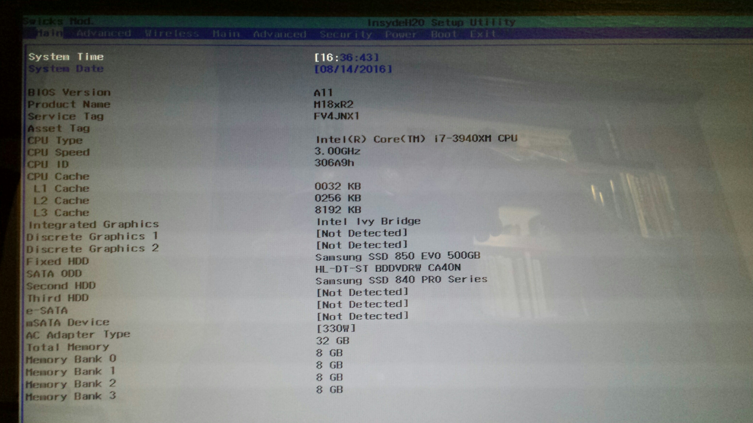

I cant believe I did not see that. They are not detected ! I cant set to peg or I get 8 beeps
OK, sounds like something is wrong. Either the MSI GPUs are not compatible with your Alienware or they are messed up. Probably just not compatible.
See if you can POST with UEFI enabled and Legacy Option ROM disabled. If you still get 8 beeps that way, you need to send them back for a refund. If that fixes it, it sounds like you won't enjoy the full benefits of the @Swick1981 BIOS mod with MSI video cards. They may only work in pure UEFI mode, which would suck.

If you see Intel Graphics the BIOS is probably set to use IGFX mode. In that case seeing [Not Detected] for Discrete Graphics 1 and 2 is completely normal and expected.
You cannot boot the M18xR2 in SG mode with two GPUs installed. (The M18xR1 can boot in SG mode with both GPUs installed and all 3 will be visible, but the discrete graphics will not be usable by Windows in SG mode.) With the M18xR2 you will get 8 beeps even with compatible GPUs installed if you set SG mode. SG mode only boots with one GPU in the master MXM slot and it activates Intel and MXM at the same time. This is how you flash bricked GPUs, but the slave MXM slot has to be empty.
The ONLY setting that will work for discrete graphics with both MXM slots populated is PEG mode. Anything else will produce 8 beeps if there is a GPU installed in both MXM slots. Doesn't matter what GPUs... can be any NVIDIA or AMD GPU and it's the same problem. With both MXM slots populated with GPUs, the only options that are bootable are IGFX (Intel ONLY) and PEG (Discrete GPU ONLY). Any other option will fail with 8 beeps.
Summary:
IGFX = Intel Graphics Only (MXM slots are disabled and discrete GPUs will not appear - you will see [Not Detected] in the BIOS)
AUTO = Should boot with single GPU in master MXM slot as long as slave MXM slot is empty (this mode serves no useful purpose)
SG = Will boot with single GPU in master MXM slot, requires an empty slave MXM slot... Intel will be also be active (some call this Optimus mode, but there is no Optimus on the M18xR2)
PEG = Single or Dual MXM works and Intel Graphics is disabled (this is the default setting and allows for full performance with discrete single or dual graphics)
You can use either of the two modes shown with bold green fonts. The two in red font will fail to POST with 8 beeps with two GPUs installed. Alienware Command Center switches between IGFX and PEG. The other two modes are never used for normal operation. In most cases Alienware Command Center will not switch between IGFX and PEG modes if only one GPU is installed.
