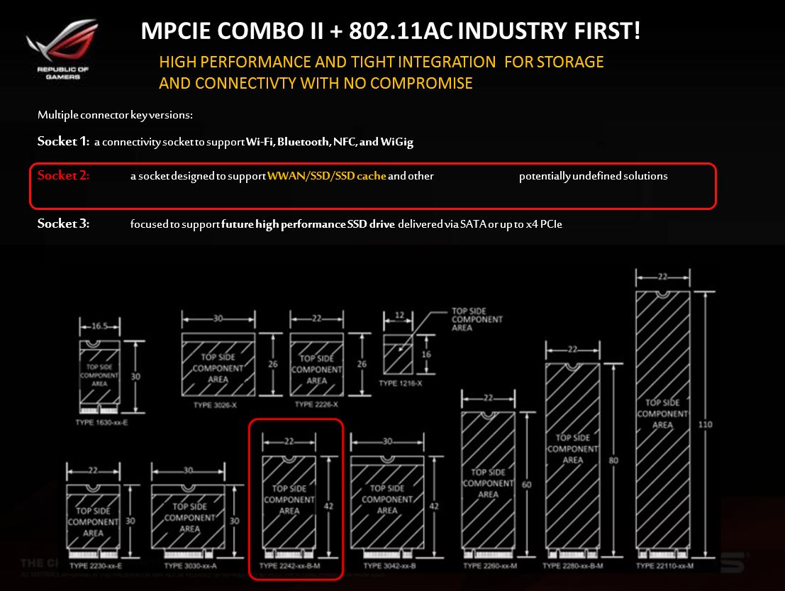

Datura Posted November 13, 2013 Share Posted November 13, 2013 Here's some information regarding the NGFF M.2 interface and its potential to be used for eGPUs most of which was provided from the below link. http://www.te.com/commerce/DocumentDelivery/DDEController?Action=srchrtrv&DocNm=1-1773702-1NGFFQRG-EN&DocType=DS&DocLang=ENM.2 has differing keys for its slots. The type of key defines what type of connection the interface can provide and it also imposes a physical limitation on which NGFF cards you can actually plug into the slot itself. An image indicating the types of cards and their keys can be found at the below link. There are some cards that will fit into multiple slots (for example a B-M card could go into a B or M keyed slot).http://www.bjorn3d.com/wp-content/uploads/2013/06/NGFF.jpgThe slots with key IDs of A, B, E or M would be the only ones of interest to us as they are the slots that could provide us with PCIe traffic. From what I gather, slots with the key of E may provide 1 lane of PCIe traffic while slots with keys of A or B could provide 2 lanes(PCIe x2) and a slot with key M could provide PCIe x4.NGFF has support for PCIe 3.0. An NGFF M slot with the 4 lanes of PCIe traffic, running at PCIe 3.0 would have almost the same amount of bandwidth available as an x16 1.0 link (~32GT/s)I'm assuming, much like mPCIe, which pins are actually connected to these slots may be up to the manufacturer to decide, for example, they may only connect the USB pins on a slot B connector.There are a few NGFF products that hwtools has that are of interest:P4SM2- M Key card to PCIe x4, indicated as compliant with PCIe 2.0 spec.P4SM2 (PCIe X4 to M.2 Adapter)While it says compliant with the PCIe 2.0 spec, it would be really awesome if it actually could run a 3.0 connection.L12S- A or E key slot extender to B key slot, PCIe x1 maxL12S (M.2 Extender Board)This could possibly be used to convert an A key slot to a B key slot which appears to be more popular with SSDs.P11S-P11F- A or E key slot extender to 2 PCIe x1 slots.Note: I'm not sure how this is possible if E keyed slots only provide 1 lane of PCIe traffic.P11S-P11F M.2 (NGFF) to PCI-E Extender BoardThe description of the P11S-P11F seems to be copied and pasted from another product as it says the below which makes no sense looking at the images of the product:The P11S-P11F adapter is designed for desktop/Laptop PCs that convert 3G wireless M.2 Card to full/half mini card slot. You can insert your M.2 card (Socket 2 SSIC-base WWAN) such as GSM,HSPA(3.5G), GPS, LTE cards to this adapter then plug to USB port through USB cable. 1 Link to comment Share on other sites More sharing options...
