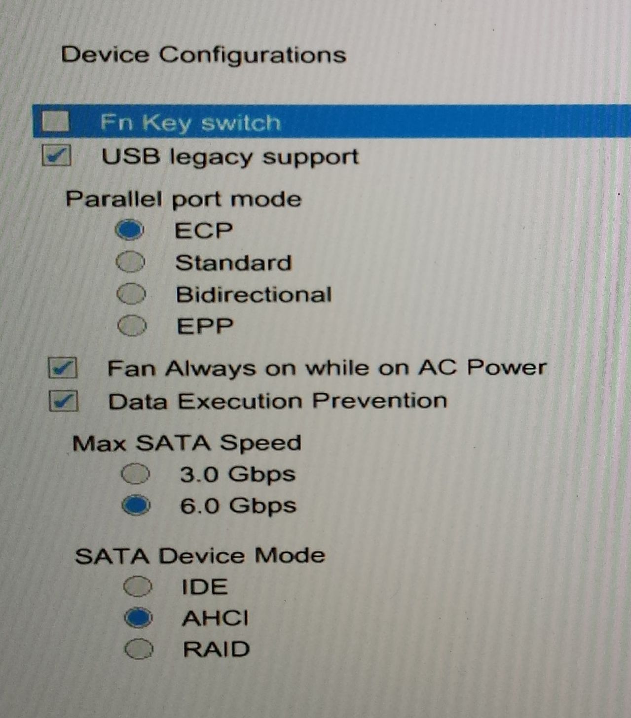

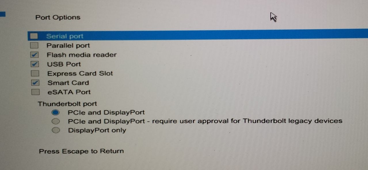

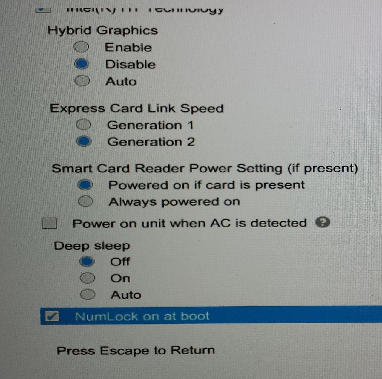

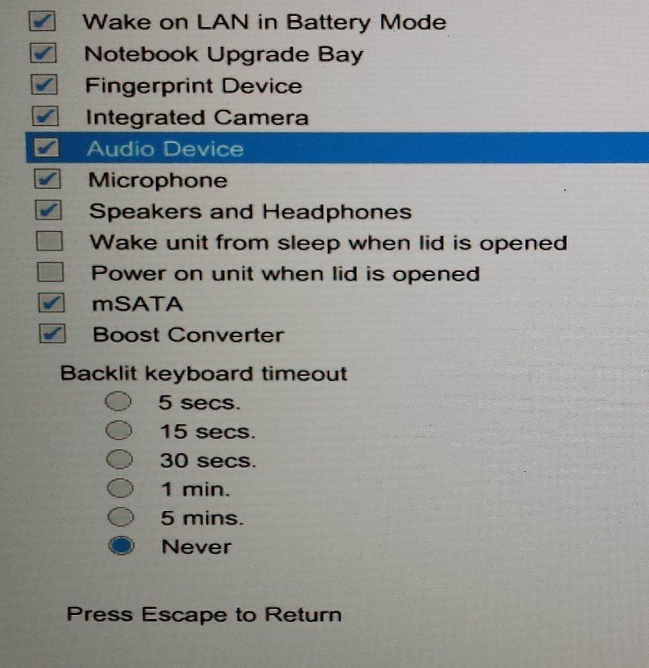

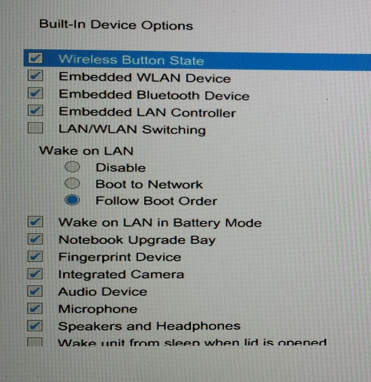

killem2 Posted January 9, 2016 Share Posted January 9, 2016 I have just finished hooking up my psu, to a gtx 760. It is connected to the Atikio box, with a molex powered risercable. Everything is getting power. My thunderbolt connection shows the box is attached. Device Manager also shows the Nvidia 760 and I installed the recommended drivers it suggested. (I tried the exe from nvidia, but it kept saying it could not see the device.) I have ran Fallout 4 on high, 1080 p and it is highly laggy. The only other game I had installed on this laptop was Burnout paradise which should be able to run with no issues on a GTX 760 but is lagging as well. I have the zbook 15 (g1 series). - Intel i7-4700MQ - GTX 760 - 32 MB ram - Thunderbolt cable - 500 watt OCZ psu (which I used to have this and the gfx card in a desktop for a while now) It responds when I unlug thunderbolt and plug it back in. It knows there is a device. It just seem to really be utilizing it. These are the steps I initially followed. https://odd-one-out.serek.eu/thunderbolt-2-egpu-setup-using-akitio-thunder2/ What could I be missing? Link to comment Share on other sites More sharing options...
Dschijn Posted January 10, 2016 Share Posted January 10, 2016 Are you using an external monitor? Link to comment Share on other sites More sharing options...
killem2 Posted January 10, 2016 Share Posted January 10, 2016 Some Updates: I discovered after I got through all this that Windows 10 and Optimus do not get along for these setups. I have downgraded to windows 8.1. I am not using an external monitor. (I could, but I was under the impression if you have Optimus, that's how you can use your own laptop screen) It is detected in Device Manager fine, it accepted the 8.1 drivers like a champ and my thunderbolt screen still says the box is an allowed device. I tried to run fallout 4 on high settings 1080p, and it was like slower than just running the zbook with default mobile graphics. So something must be wrong. Is there a specific driver I should try? Link to comment Share on other sites More sharing options...
killem2 Posted January 10, 2016 Share Posted January 10, 2016 Another Update: I too appear to be getting the error 12. Not enough resources.... disable something blah blah Link to comment Share on other sites More sharing options...
Dschijn Posted January 10, 2016 Share Posted January 10, 2016 If you want to use Optimus, you currently have to have the following setup: - Laptop with Intel Iris iGPU that can power the internal display - NO dGPU (Geforce or Quadro) activ in the system (disabled in the BIOS) - an external Nvidia eGPU - Windows 8.1 (for the MacBook users for sure, should be your best option as well) Link to comment Share on other sites More sharing options...
killem2 Posted January 10, 2016 Share Posted January 10, 2016 6 hours ago, Dschijn said: If you want to use Optimus, you currently have to have the following setup: - Laptop with Intel Iris iGPU that can power the internal display - NO dGPU (Geforce or Quadro) activ in the system (disabled in the BIOS) - an external Nvidia eGPU - Windows 8.1 (for the MacBook users for sure, should be your best option as well) Thank you. - The Zbook 15, does have the Intel Iris Technology. - This might be my issue. I assume the D in dGPU is for discrete. I do not show an option for this. The closest I have is Hybrid Graphics, with options Enable, Disable, and Auto. If I use Enable or Auto, I get all three display units in Device Manager: Intel, Quadro, Geforce. If I select Disable, I only get the Quadro and the Geforce. If it would help the discussion I am more than happy to provide all the options my bios gives. I could be over looking it. - I do have the external setup. I have the power supply (500 watt ocz, which was used when it was in a desktop), Zotac GTX 760, Into a 8x to 16x Molex powered riser card, which then connects into the Akitio Thunderbolt 2 box, and the out put is a 9ft Thunderbolt 2 cable. Link to comment Share on other sites More sharing options...
killem2 Posted January 10, 2016 Share Posted January 10, 2016 Anyway here are my photos of my bios. Spoiler Link to comment Share on other sites More sharing options...
